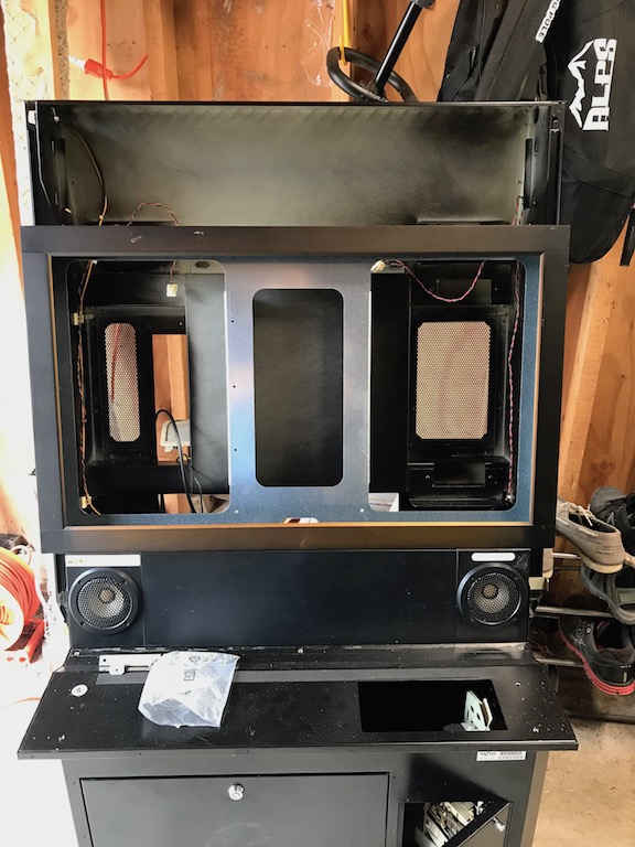

Received the bracket today. I'm very pleased with the result considering this is the first prototype. I'll put everything together during the weekend and upload more pictures. Once the design is polished, I'll start working on the price. I get these prototype brackets manufactured at oversea so I have to get a quotation with a vendor here in the US for production. This bracket will work for almost every Vewlix except diamond and later models. I will document specifically how to check the compatibility.
The small hole on the bottom is to access the monitor settings. :thumbsup:
When assembled, monitor will sit on the edge. Right now, it is flushed in a little bit.
Gotta love that brownish decolorization on the frame. <X Plan on powered coating lol

I’ll individually contact people who showed interest in this thread for now. Plan on setting up a shop webpage
