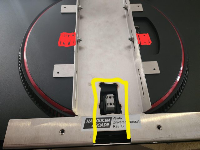

PSA - unless you hack your HA bracket, the newer LG gaming monitors with a metal piece sticking out at the back is not compatible with the Rev B bracket.
Edit: it seems the Rev D bracket already caters for this
Monitor back looks like this
In preparation for next gen fighters, I purchased 2x LG 32GN600 to go on both of my Chewlix's.
Due to the size and location of the mount, the bracket that the vesa mount bolts on to physically will not fit the bracket
This is where I had to get the drill and jigsaw out. I had to cut off a hole in the bracket (yellow) for it to stick out and I also had to cut the tabs (red) which removes my 200mm compatibility for monitors.
I probably could've removed the stand holder, but I had great difficulty trying to decase the monitor and I was too scared to break it. I was OK with hacking the bracket up as expensive as it was. I'm not sure if all new LG monitors are like this, but I know the older QHD, 165hz LG's weren't.
Once those two "mods" were done, it was simple enough to install again
Now it's time to calibrate the monitor to my preference, take notes of the settings so I can rinse and repeat the same process for the other cab.
So @Hadouken Arcade, if you ever do a newer revision, it might be worthwhile to extend that opening you have to where I've shown with yellow outline in the pic earlier. I don't think it'll affect the mount structurally, but I'm also not sure how that impacts the Vewlix version as I know it's got another piece that goes on top.

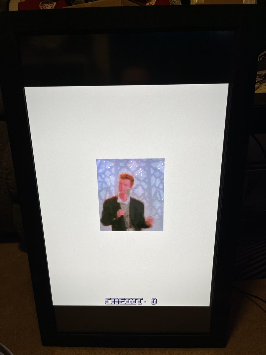

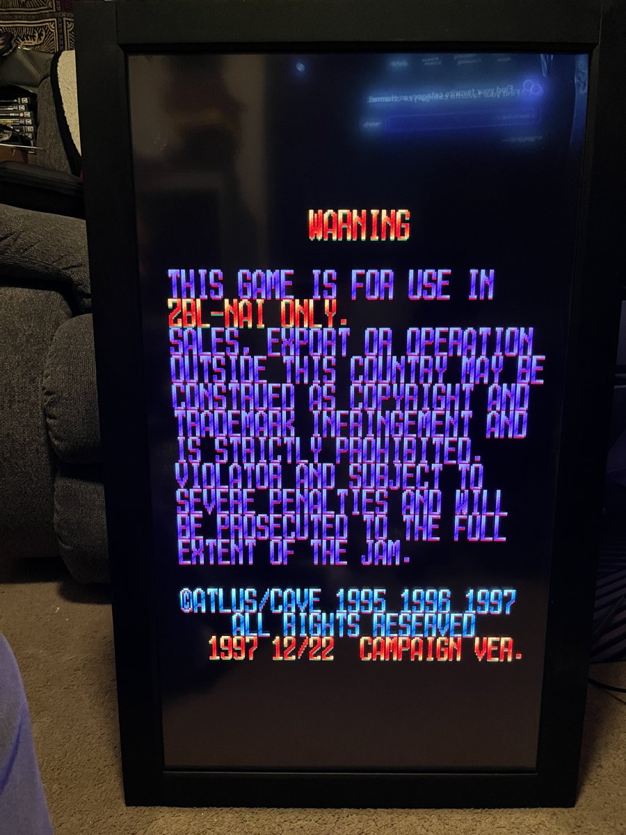

Oh man, pics and video, we need to see how awesome this looks. Are you going to use it with the retrotink 4k?
This is with Mister at 1080p. I think I am going to get beat down in SF6 in 4k mostly :D. I doubt any pictures will do it justice. I am just reporting that the monitor fits in the brackets.
