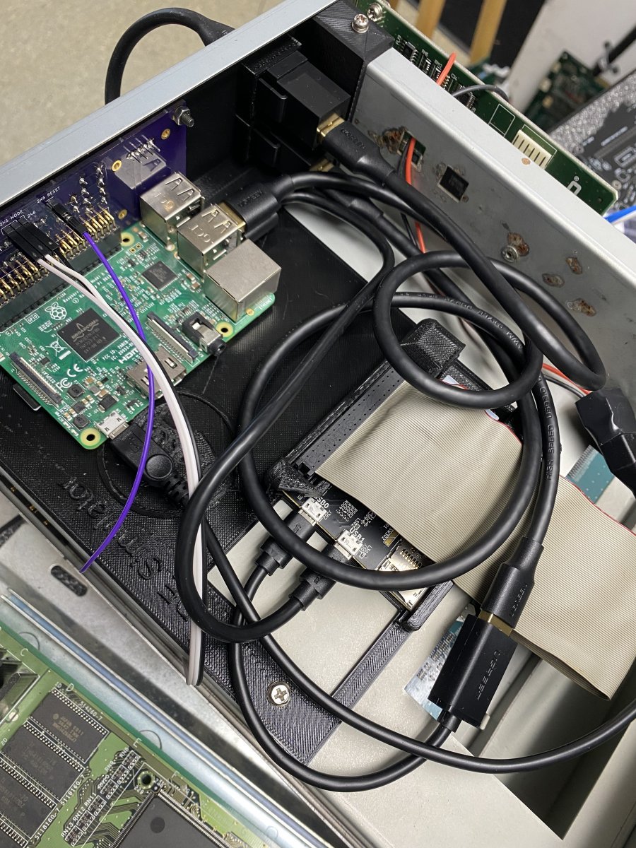

It goes on the middle rail - to keep the front plate in place, since there aren't any screws on the left side (just the one on the right side) - here is a picture with the old ODE - same part (upper right of picture).

Took me a while to find it on the photo! thanks a lot!

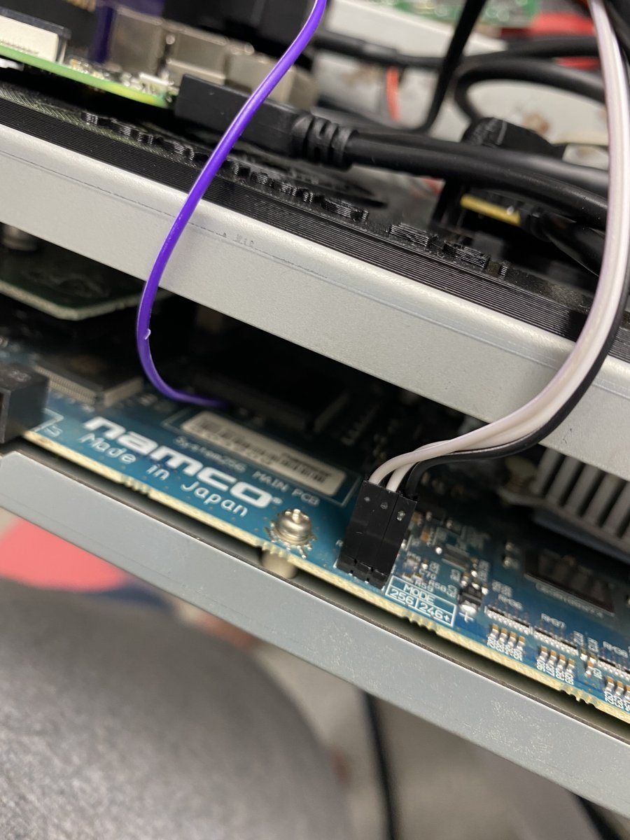

And i noticed that the selector mode is not a jumpber but a wire. Where does that 3 pin wire connect to? (now i have to resolder that part *facepalm*)
Btw thanks for your STL files, i am happy to build it! - Looks really clean!

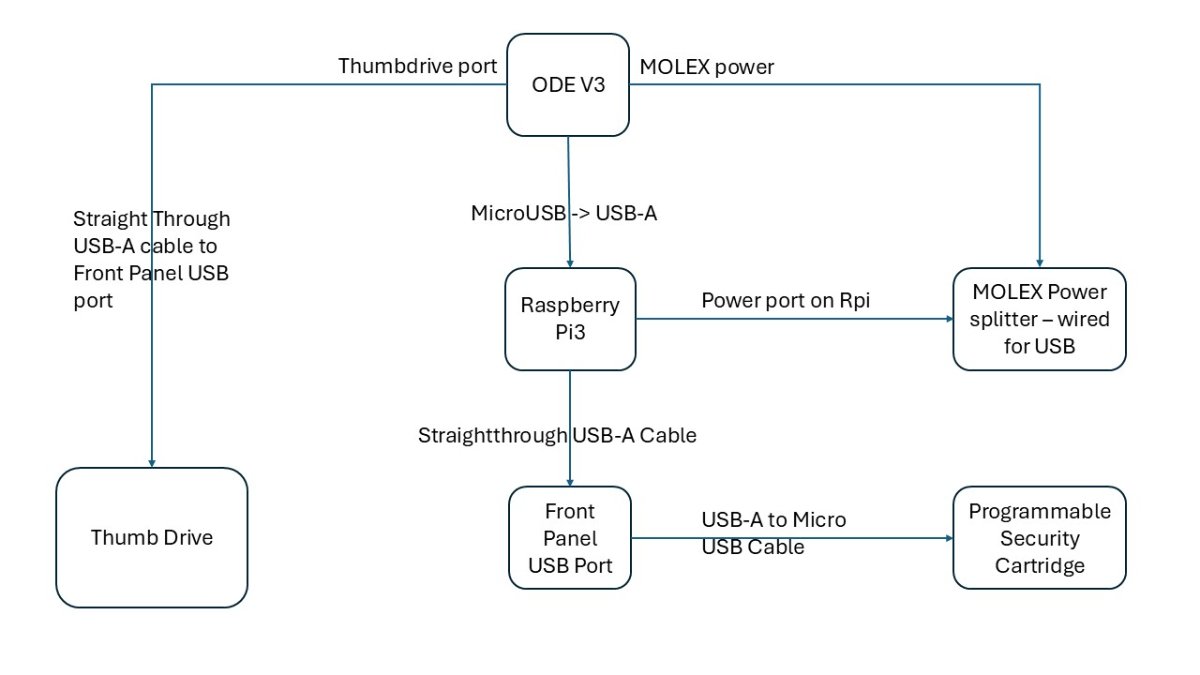

Attached is a diagram of how the new one needs to be hooked up (a bit simpler than the last one) - this is assuming you are using the 3d printed file with front mounted USB passthrough ports, if you are going to internalize everything - its even simpler.

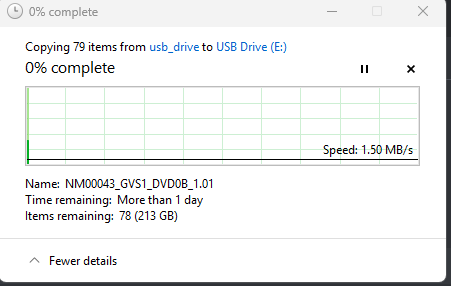

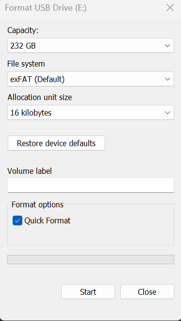

One last question guys. And please pardon my questions. Just got home and got straight to work. Erased the 246/256 files I originally put on the thumb drive. Even formatted it to ensure it was clean. I got extract the files and it says it will take more than a day to extract those 78 files / 230 GB ish of data. Did I format this thumb drive incorrectly? My thumb drive is a 256GB Samsung one that was recommended in another thread for this build.
Wow - that is a super slow transfer rate! I know it DOES take a while (I think maybe 2-3 hours on my system), but the transfer rate looks really slow - 1.5MB/s? Almost like its only connected at USB2 speeds.
