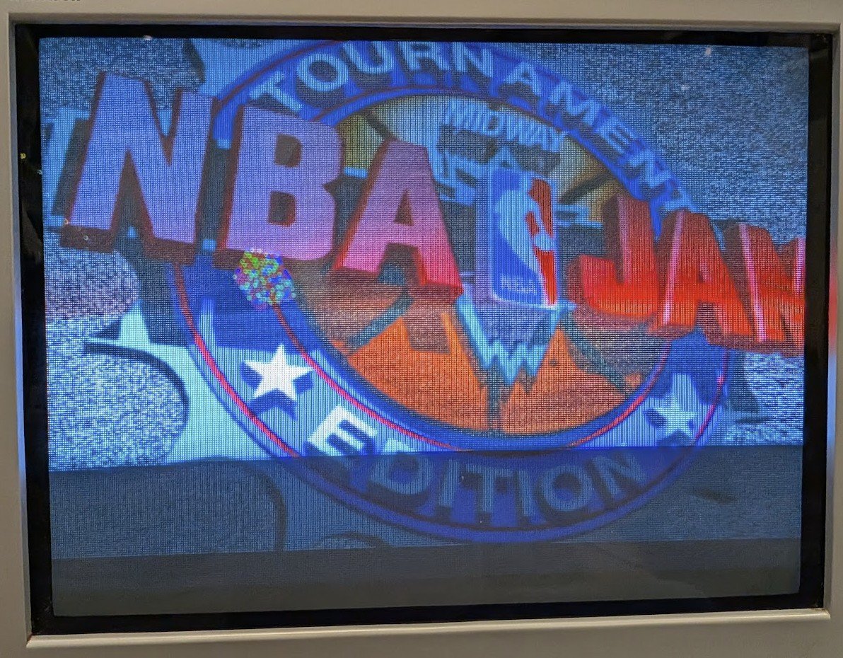

@Asure does this have the ASIC defeat built in to play TE on reg JAM hardware? I tried burning UJ/UG12 and put them in a working reg Jam with scaler version 1.5 installed and it wont boot.
I didnt burn any other roms yet, I thought it should boot with just UJ/UG12 and possibly fail the rest, but wanted to make sure.
answered my own question. YES this will run on standard JAM hardware.
NO it will NOT run using 29F040 (I thought I could use these instead for testing erase WAY faster and program in 15 seconds instead of 2 min), I went back to 27c040 eproms and it booted right up.

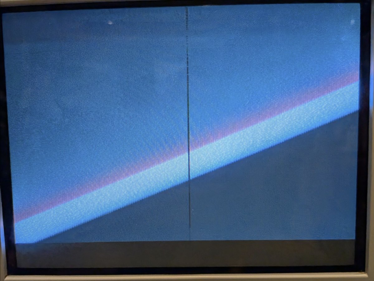

Only problem I found on original JAM hardware with 1.5 scaler, is the splash screen doesnt display correctly, it flashes and is trying to do something, but its not displaying anything recognizable.
I will dig up a TE stack tomorrow if I can to see if its a scaler problem or a platform problem.
All Eproms checksums passes aslo, so i dont think its a corrupt rom.
Note, I left 4 original JAM eproms in place, they showed as green on boot, so I can also burn those if needed for testing ??

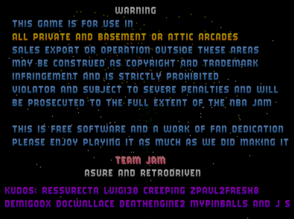

Just trying this on a non-TE NBA JAM board, plays great!. Quick question, is it due to the 1.5 UF5 chip that the main splash screen doesn't display right?
Edit: turns out it was just the inital screen after power on which from starting the ROM in MAME is the Warning screen from Team Jam :) Only 'issue' I've seen so far on a T-Unit with the 1.5 UF5 chip.
Well, we don't know.
This screen is used in the game at a certain point that's very hard to reach for normal users. I just recycled the code for the warning screen and it uses a different font. I've tried to debug it with another user, but lack of time has prevented me from running it on real hardware. All variants of code i tested worked fine on Mame, but it doesn't behave like real hardware. It's not the UF5 chip, they are identical except for protection calculations, and that part is not used in this screen at all.
