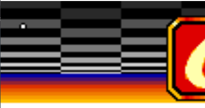

I haven't really looked at what those addresses are but I'm guessing 501AB8 is perhaps relevant since it's nearer the other player memory locations (5051B4 is speed, listed in the pugsy cheat xml I directed you to in the other post). Perhaps the rest go towards driving this pixel in the corner of the screen, I don't know I didn't really look too deep. I don't know this processor and I'm not about to learn, but it feels relevant that this byte is set when you enter the code. I would set watchpoints for these and see what happens after the game starts.
