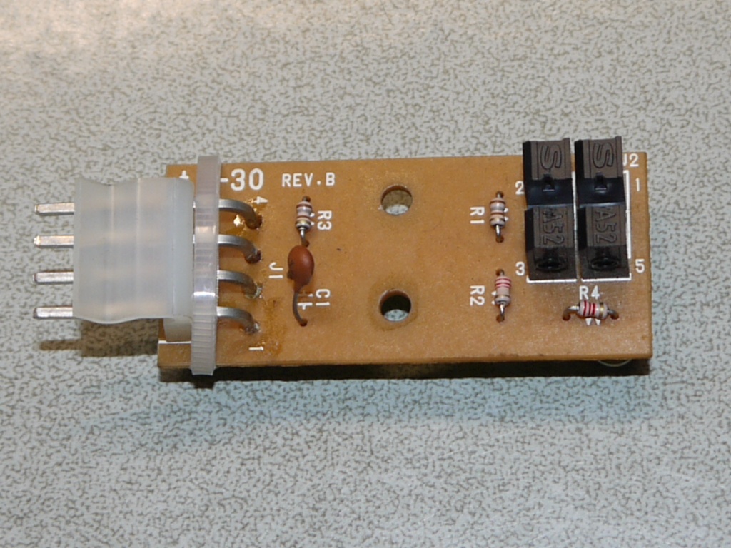

The ones twistedsymphony linked to have the Taito logo on the encoder PCBs. However, the ones that I have have spindles that are plastic instead of metal and the encoder board just has the text "TS-30" on it.
do you have pictures of those. I don't think I've seen that spinner before.

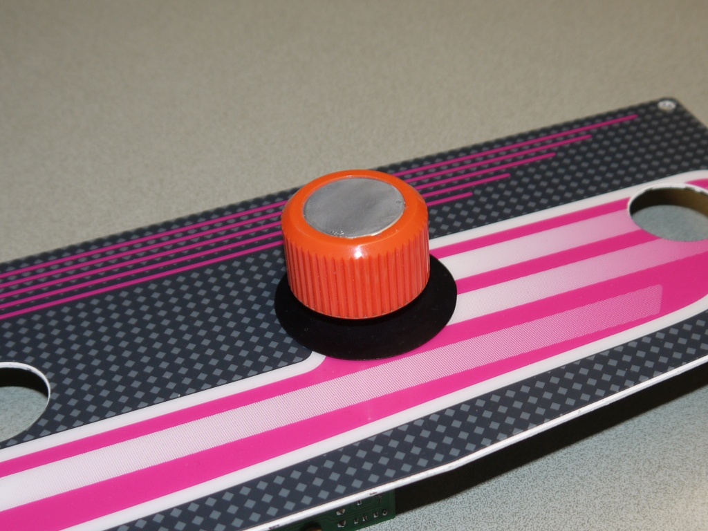

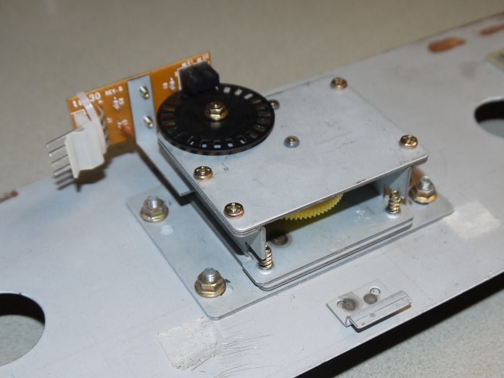

Oops, completely missed this post of yours, TS. Here's some pics:
Anyway, the photointerrupter on mine stopped working. Punching Sharp and A52 in to Google, first result is a GP1A52HRJ00F. Knowing nothing about photointerrupters, does anyone know if that's a suitable replacement?

The device looks like a Seimitsu LS-29 but the optical PCB looks nothing like the original PCB ?
