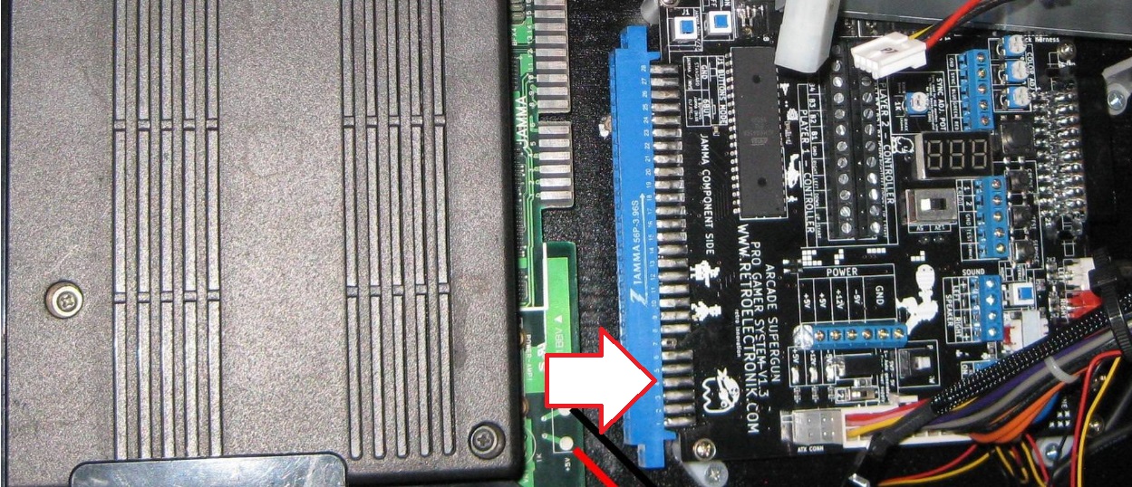

@PascalP I'm not entirely sure how to check voltage on the Jamma side when it's running, but I think I have an idea? Can you please view this picture to tell me if I have the right idea where to place the leads on my meter for testing? I have also put a circle around the power supply because I think it is the information you are looking for?
Image 1
Here is the info from the picture that I think you may want though?

I would rather measure here (see attached)
It cant hurt trying with the other Supergun or PSU, although that PSU should be good enough, so problem comes IMO from either Supergun or microSD.
