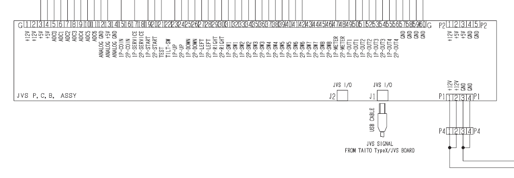

This is my control panel for my Chewlix. I have to build a Taito Vewlix harness from scratch but I wanted to make sure of the pin-out first.
My question is does the pinout from the Vewlix manual still match how you have your PCB laid out?
My concerns are mainly with buttons 7 and 8 and do they still correspond to Brooks layout?
If it matches one for one that's awesome, and I am on the right road :)

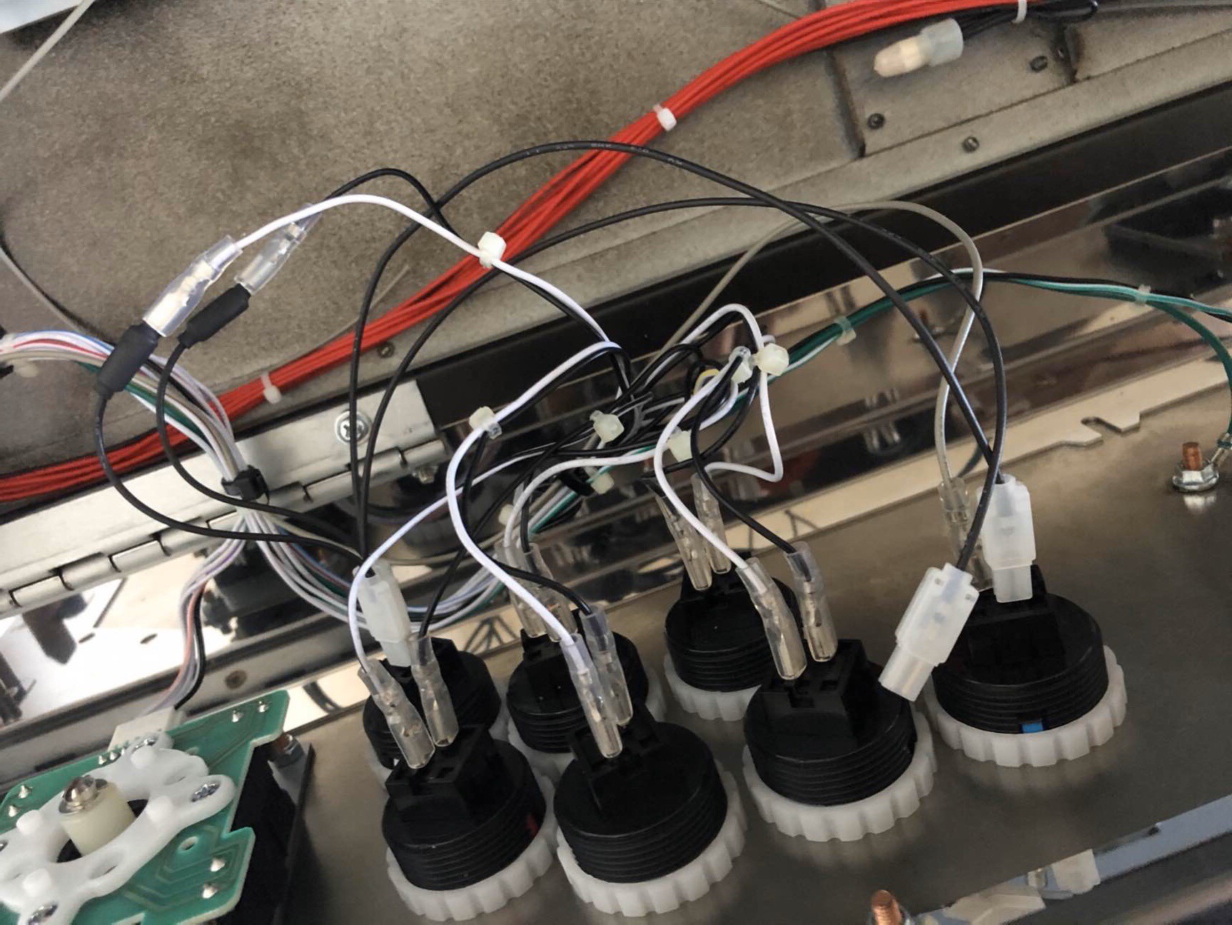

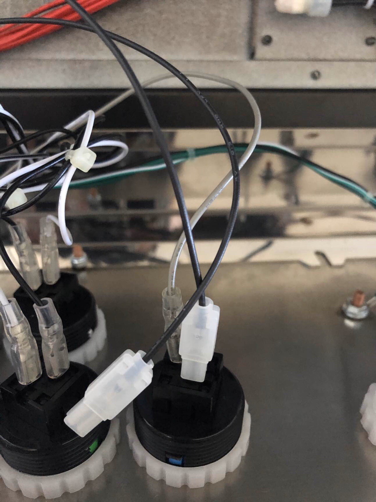

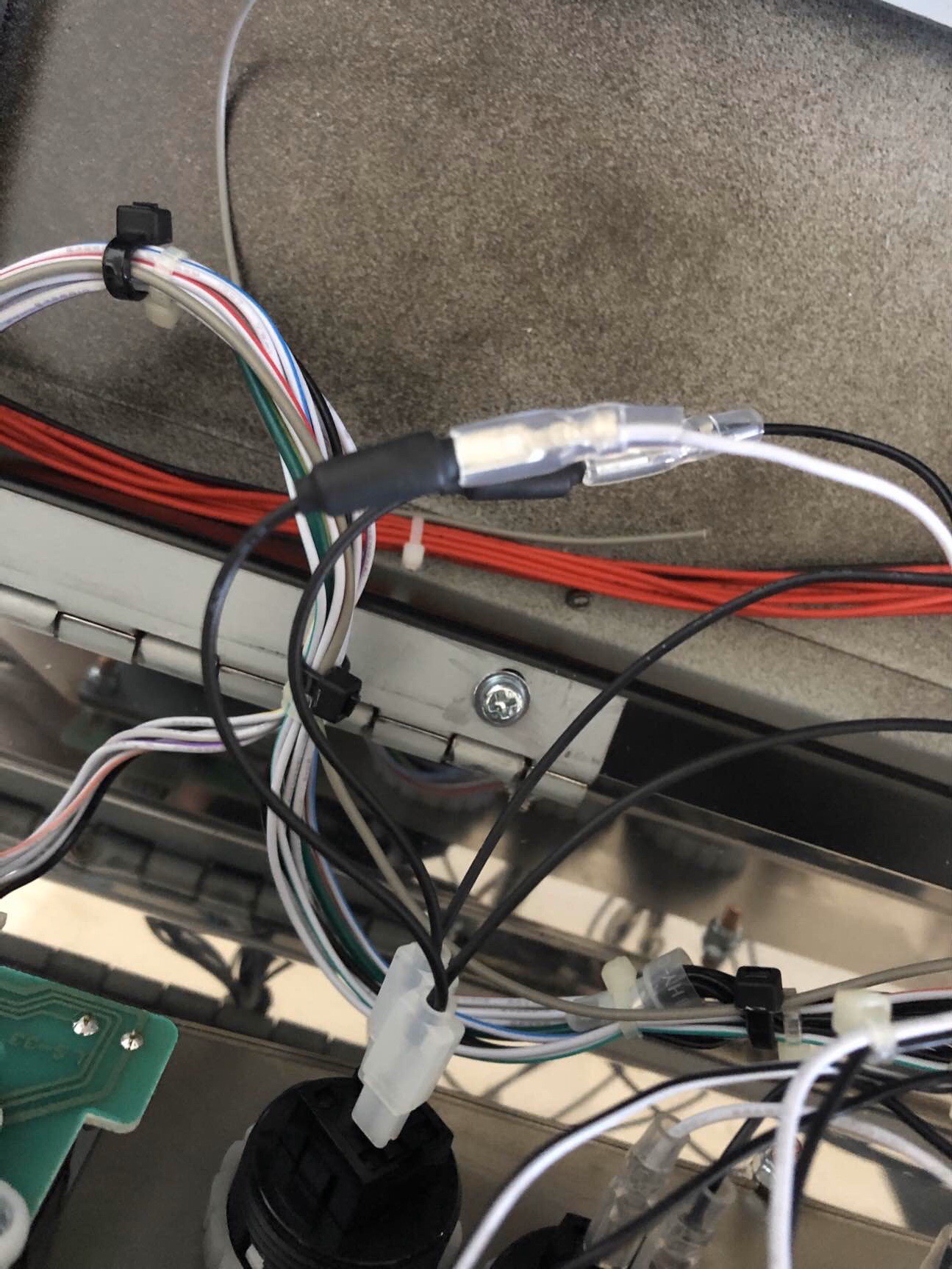

so my solution for getting a ground connection to button 7 is a mirroring wire that is mostly used to mirror button 4 to button 7 to play MVS.
i mirror the ground wire from button 4.
In my pictures for those wondering I'm using 2 mirror wires, one to mirror the ground wire from button 4 to button 7 as i explained and the other is to mirror the actual button 4 to button 7 for MVS playing , its as easy as disconnecting the gray wire (button 7) and connecting that extra mirror wire that hanging.
So i got some guy from France to do the wire for me and its now available on his ebay post. (Your welcome lol) for those who want some.

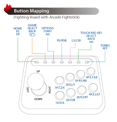

I am trying to do this (see below) with my sub-panel but it does not seem like the Brook(s) UFB are seeing any of the button pushes.
P1 COIN [15] --> P1 BACK
P2 COIN [16] --> P2 BACK
P1 SERVICE [17] --> P1 Xbox Button
P2 SERVICE [18] --> P2 Xbox Button
Test [21]--> R3
Tilt [22] --> L3
That's not how the buttons are wired to the Console I/O. If you want to connect those buttons you need to wire them to the header on the Console I/O PCB labeled "Auxiliary Buttons." Look at the back of the PCB, it has the pinout listed directly on the silkscreen. The connector is a 6 pin JST XH.
For L3 and R3 you have to connect those to the J4 header on the brook UFB. That connector should be a 4 pin JST PH 2.0.
