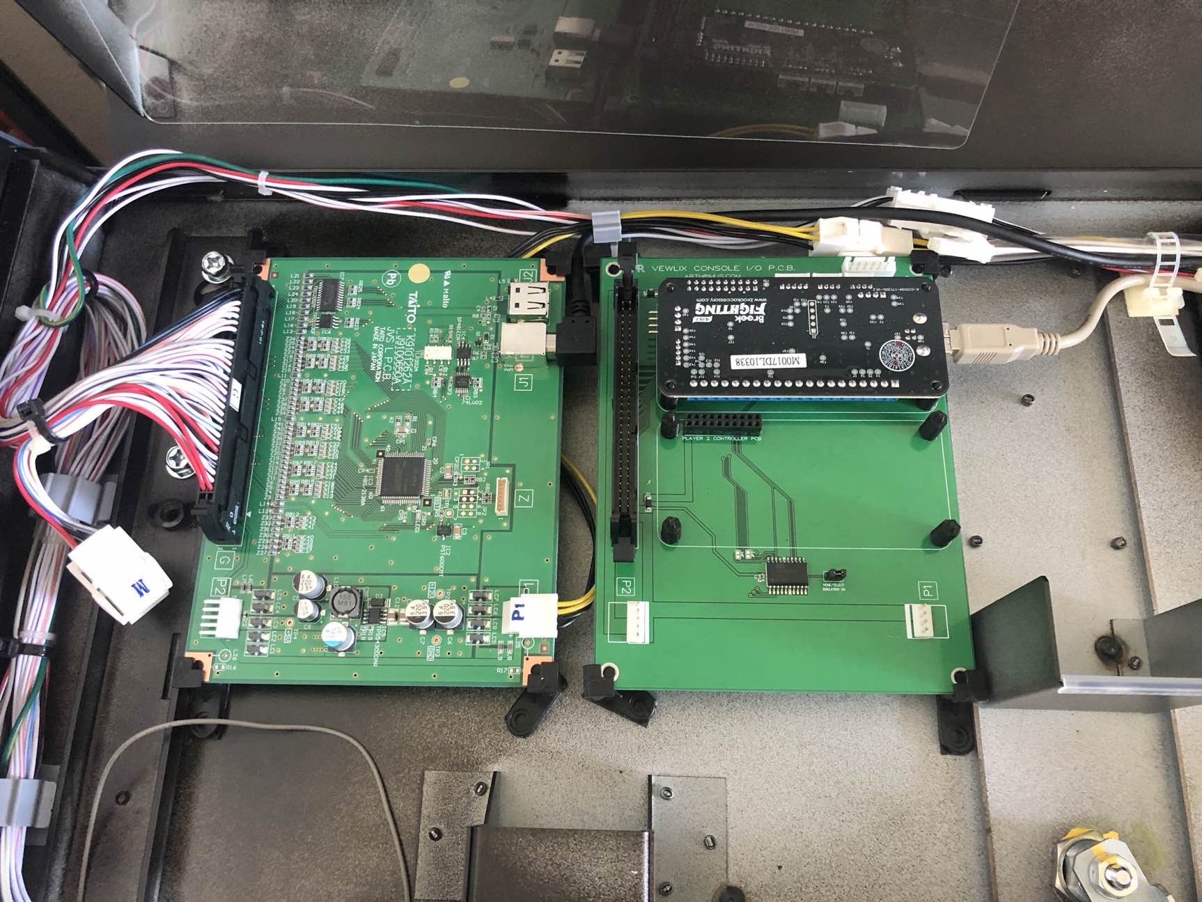

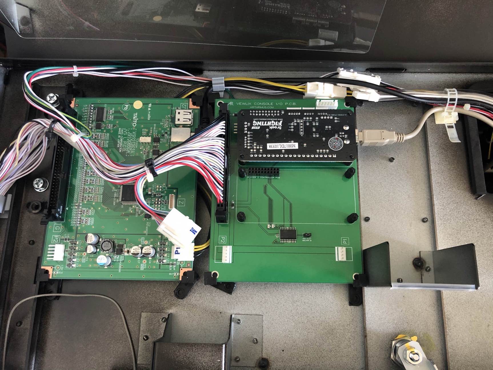

this is my current solution to having console i/o and jvs i/o in the same vewlix cab. It sucks that i have to unplug the G harness from 1 i/o to the next but until this brilliant man @Arthrimus come out with that solution this is what i do.
i dont have to remove the power adaptor to the console i/o because it gets power from the usb.
they both fit side by side and i got an angle usb cable for the jvs i/o since a regular straight one wont fit and the board are held by some pcbs legs and double sided tape

I'll have the same thing with 2 brooks soon enough. Smart to pre populate with two different usbs vs swapping that too if you don't need to do that as well. Not sure why I hadn't thought of that. Looks good and also can't wait on a solution that makes it even easier without going into the CP!

The only thing i swap back and forth is the G harness.

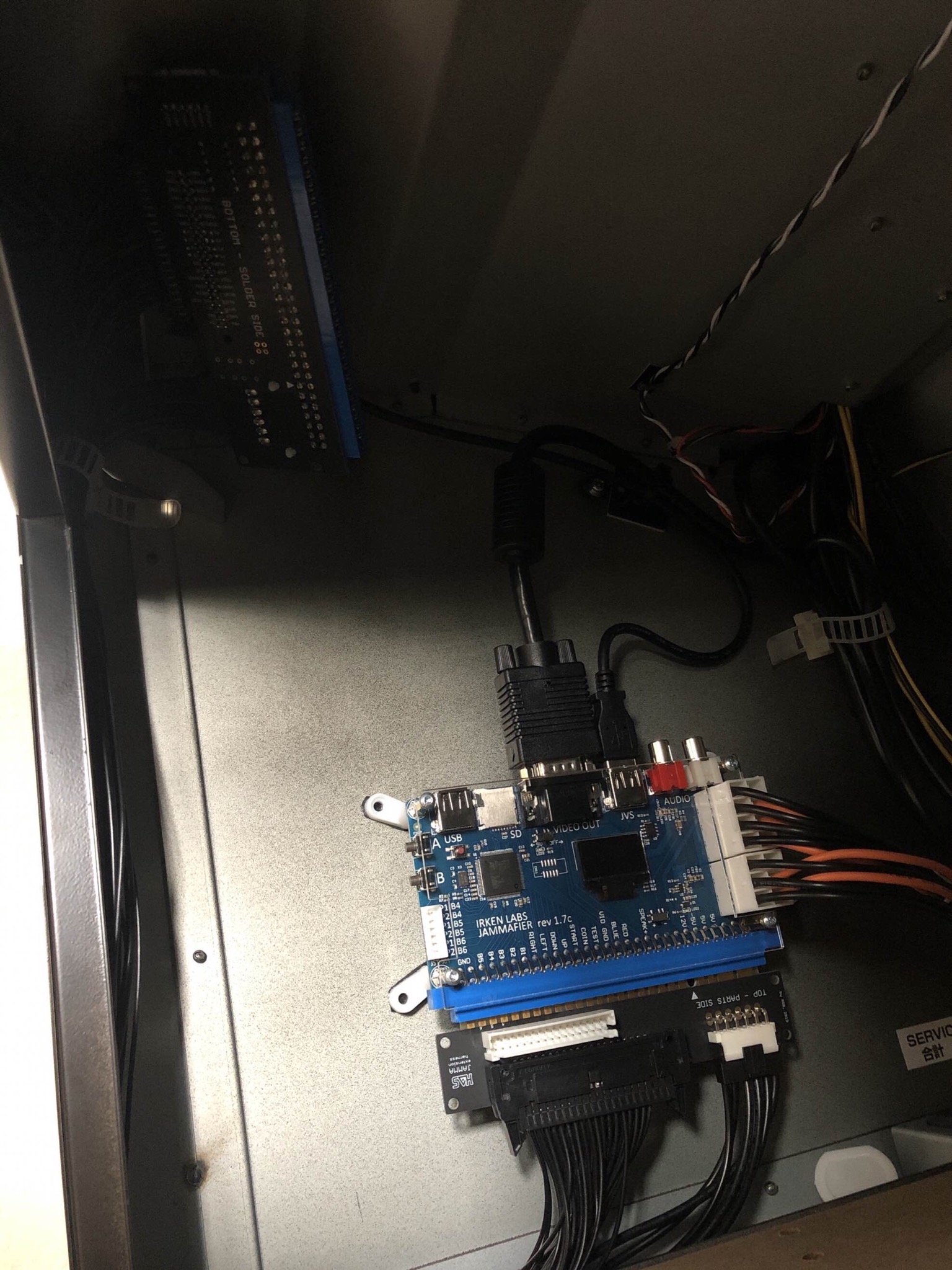

lol well dam thats gonna be a task , maybe all that can fit on the side of the body of the vewlix like i have my jammafier but then you need a G harness extender.
Hmmm. I am working on a tray for the jammafier and the ossc, gonna have to tinker with this a bit then. I wish the ossc had a remote display/controls.
