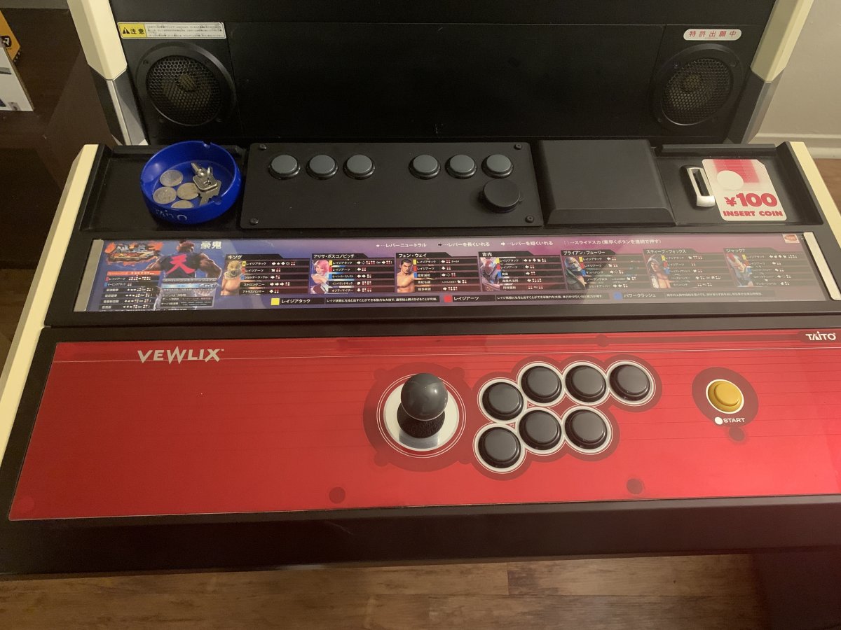

I really wanted to find a way to add a wireless phone charger to my Vewlix F where it would still retain its default appearance. I originally wanted to try to get it installed in my Nesica card reader. Here are some of the things I learned in case anyone else wants to give it a try and/or improve upon it.

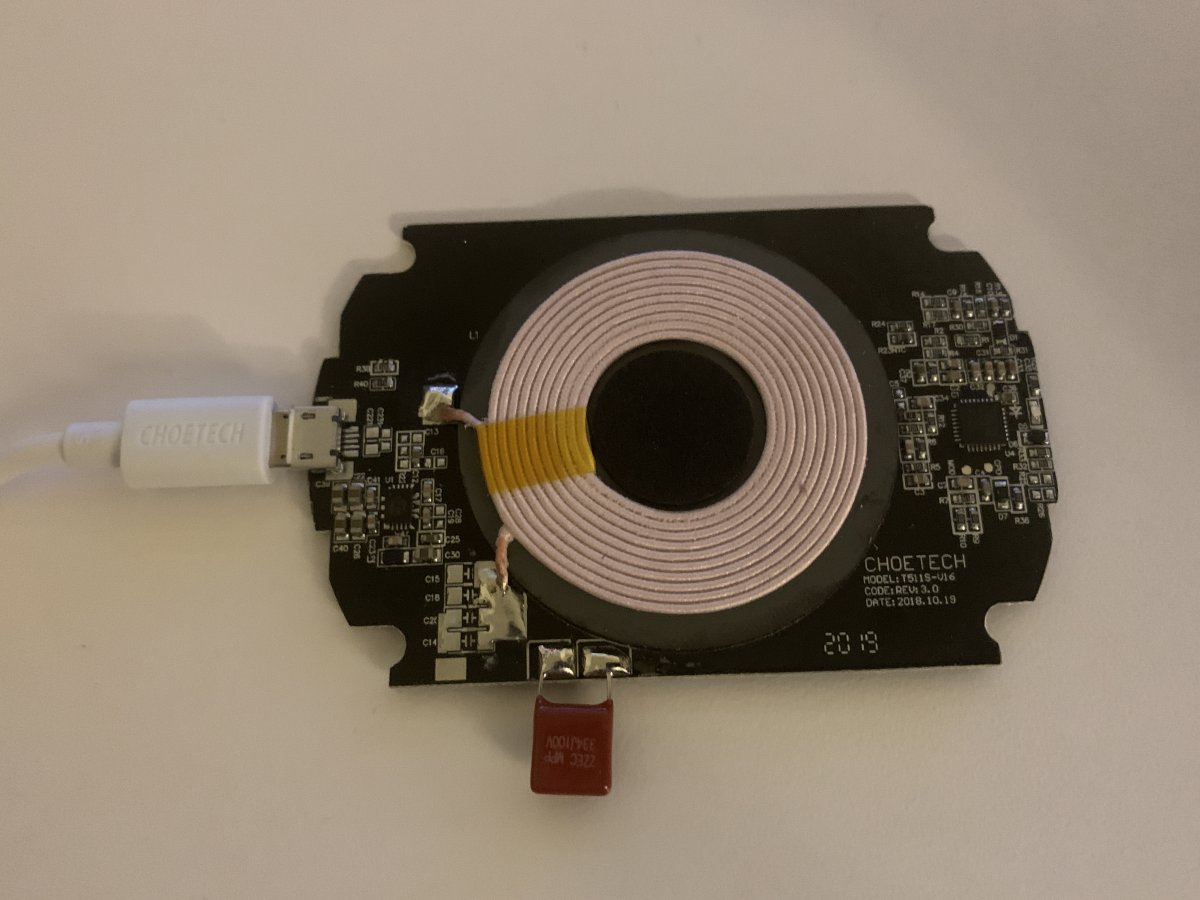

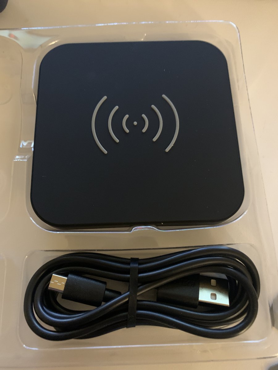

The first thing I did was buy a CHOETECH Wireless Charger 2 Pack from Amazon. This was because I was absolutely sure I was going to break one of them in trying to make this work. I chose these since they had a small vid in the listing showing the internal components, and they looked small enough that there could be a chance they could fit.
I then found that I could unstick the bottom four soft pieces on the bottom of the white wireless charger, so it was pretty easy to unscrew the screws underneath and pop it open.
Funny enough, the black wireless charger does not have screws under its four soft pads. I later had to use pliers to force it open. I was lucky that I opened the easier one first and understood where everything was at inside so I could brute force the second open.
Here is what the internal components of the charger look like

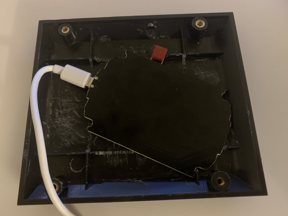

I then was able to procure a card reader panel cover thanks to some generous folks
The problem was that the underside of this particular one has a bunch of ribbing. This prevents the card reader from being close enough to the plastic, especially when it is plugged in. The fat part of the plug extends quite far, so I had to take a knife and hollow out an angled space so it could sit flush against the ceiling.
After a number of adjustments, I was able to get it to fit like a glove
Got it all plugged in and it works. I love that the default look is retained (ignore the extra button panel, haha), and that I can just set my phone on it to charge it up.
