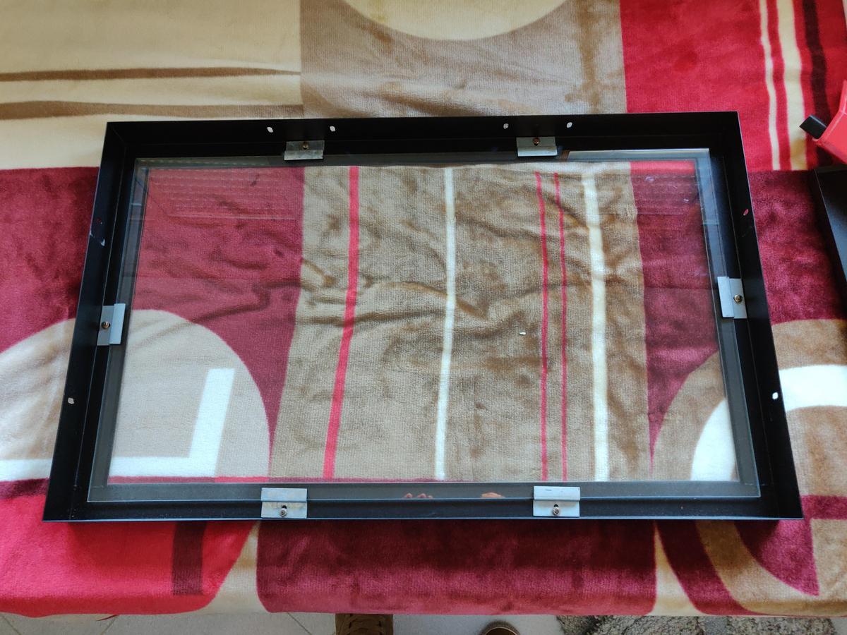

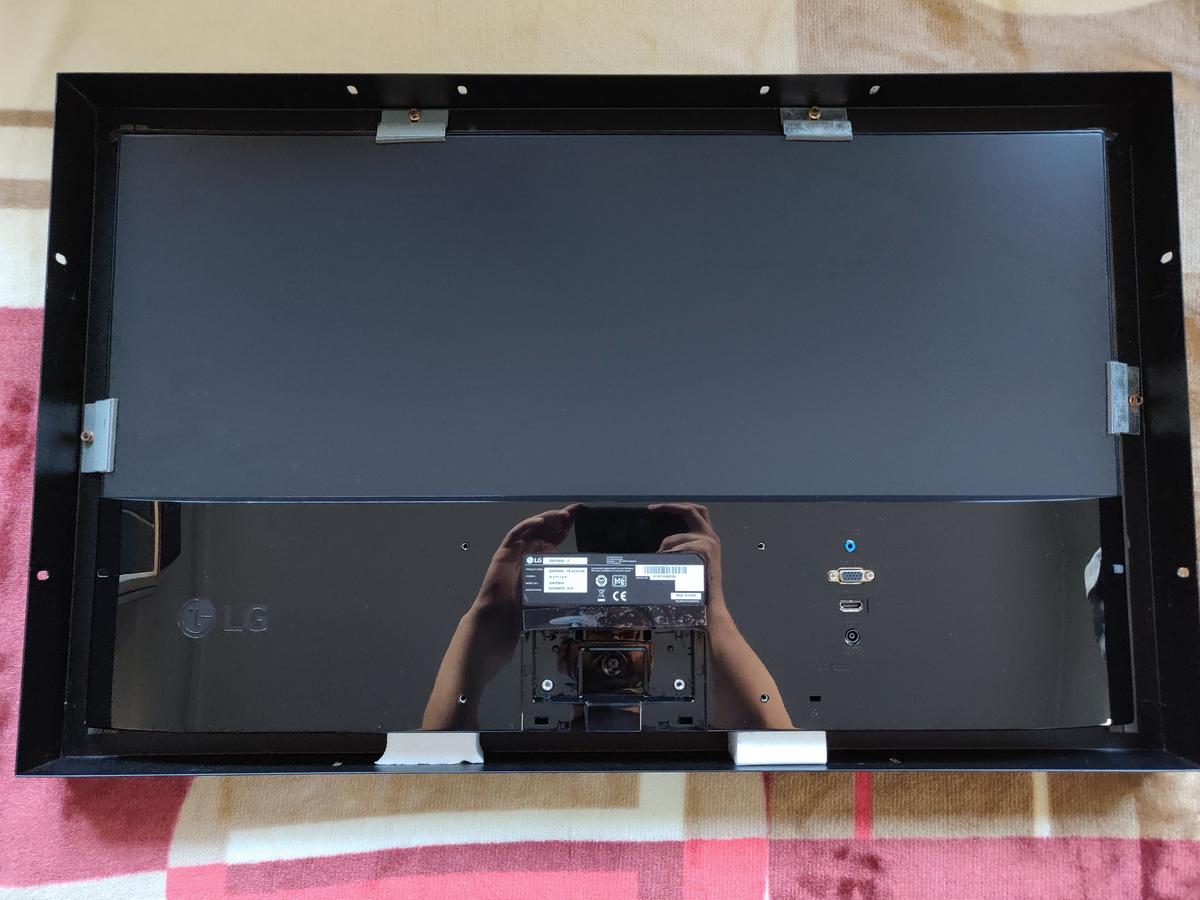

Has anyone here tried the monitor swap posted on O-A?
It looks like the monitor swap on the Chewlix is much easier to perform than on a Taito Vewlix.
On the Chewlix, the metal bezel & glass float over the monitor by 4 side brackets. Once you take this frame off, the glass is held inside by a series of large metal clips. This does not exist on the Taito Vewlix.
I dont understand how the monitor is held into the unit if your not using the VESA mount?
Is it just resting on the speaker boxes?
I was thinking the same, it looks like the monitor is resting on the 3m tape (glue) and since the monitor is light weight it does the "job".. what I see is a repo Vewlix monitor frame enclosure that attach to the monitor vesa mounting holes and to the Vewlix/chewlix back to secure the monitor. But getting to the monitor's menu to change colors settings per game will be an issue..

Office Depot next to my work says it has 1 in stock @ $189 so did an in-store pickup and will find out. Figured I would give it a try, suppose I could return it if it doesnt work. Feel like it would have to be a lot better than the old stock screen and I doubt I would change the colors setting once I dialed it in.
