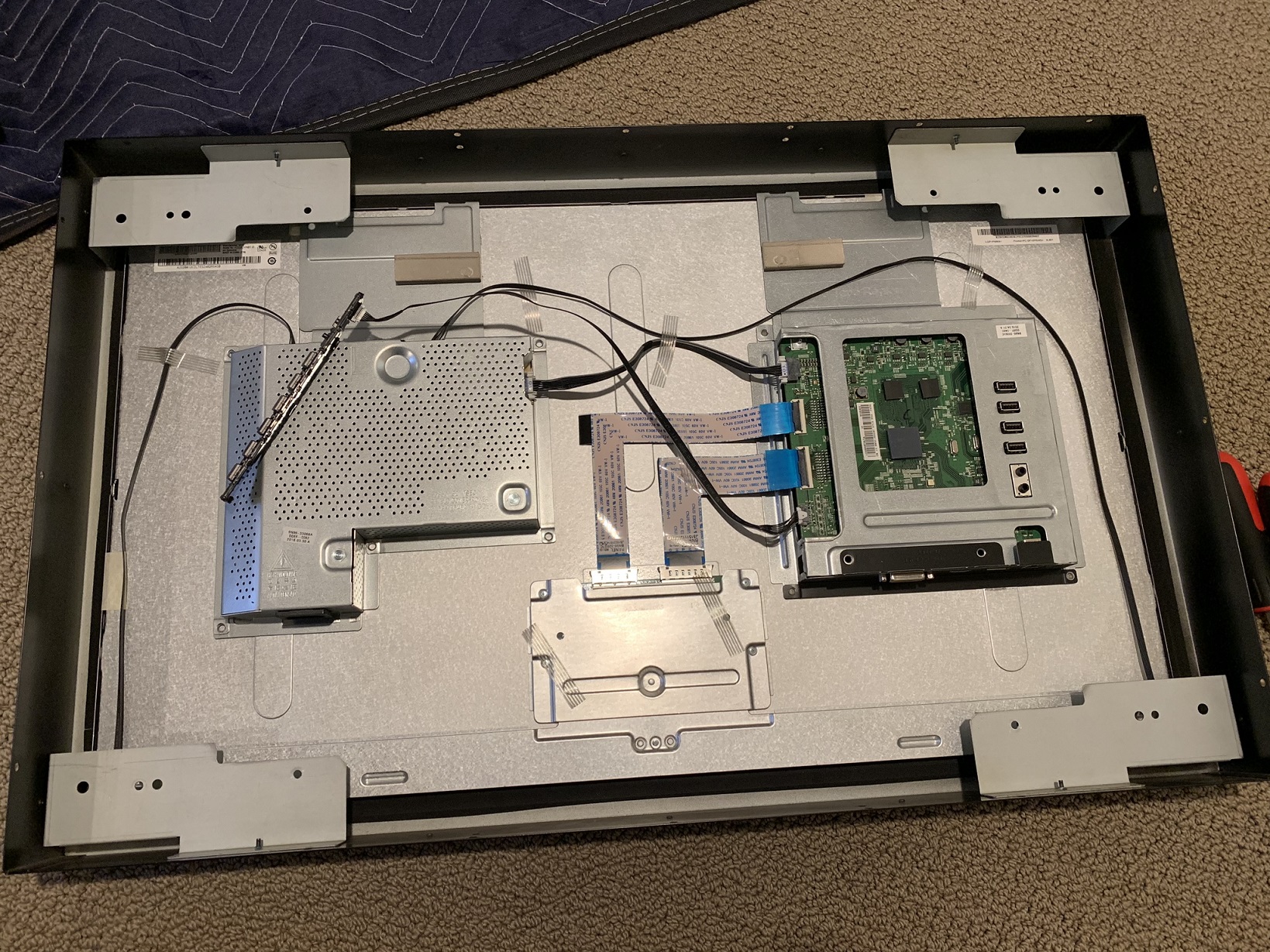

I am in the process of swapping out my 720p Vewlix L monitor with a new 1440p Samsung monitor. It is not as easy as the Chewlix which has the metal glass clips inside the monitor frame. Right now I am trying to figure out how to secure it properly.

Yes you can but it is empty inside, so the challenge is how to get the new monitor to stay in place without moving.
Yeah, post some pics, we'll help. Maybe it's something 3D printed custom brackets can solve.
Sure i'll post some pics later today.
Here are a few quick pictures I took on my lunch break. I took the Samsung panel out of the monitor casing and laid it into my original Vewlix L monitor frame. As you can see, the original corner brackets will not work. Not only are they too far away from the back of the panel, they also do not touch the corners of the panel for corner support. If I pick the bezel upright, the monitor just slides all the way to the bottom of the frame.

So if you have something to fill up the gaps, the problem would be solved right?
Then you would need:
4x corner (L-shape) "blocks"
4x bottom blocks (to push the screen to the front/glass)
Definitely solvable. Probably a lot of ways to do it, but 3D printed brackets seem like an obvious answer since you need 4 of them that are roughly identical, just mirrored.
What I would do is build a concept bracket out of cardboard or cardstock, something that lines up with the mounting holes on the frame, has the 90° bends necessary to press down on the monitor and secure the corners etc. Get it all right 'on paper' so to speak, and then you can unfold it, scan it or take careful measurements, and that can be converted to a 3D model.
How did the monitor fit when still in the case? I feel like this could also be solved with wood pieces connected at a 90 degree angle on each side.
This monitor had a sunk in bezel rather than a perfectly flat one so for this reason I removed the casing as it wouldn't look stock. If you look at my one picture I removed the front buttons. I can always extend the wires and put the control board where the original one went in the Vewlix.

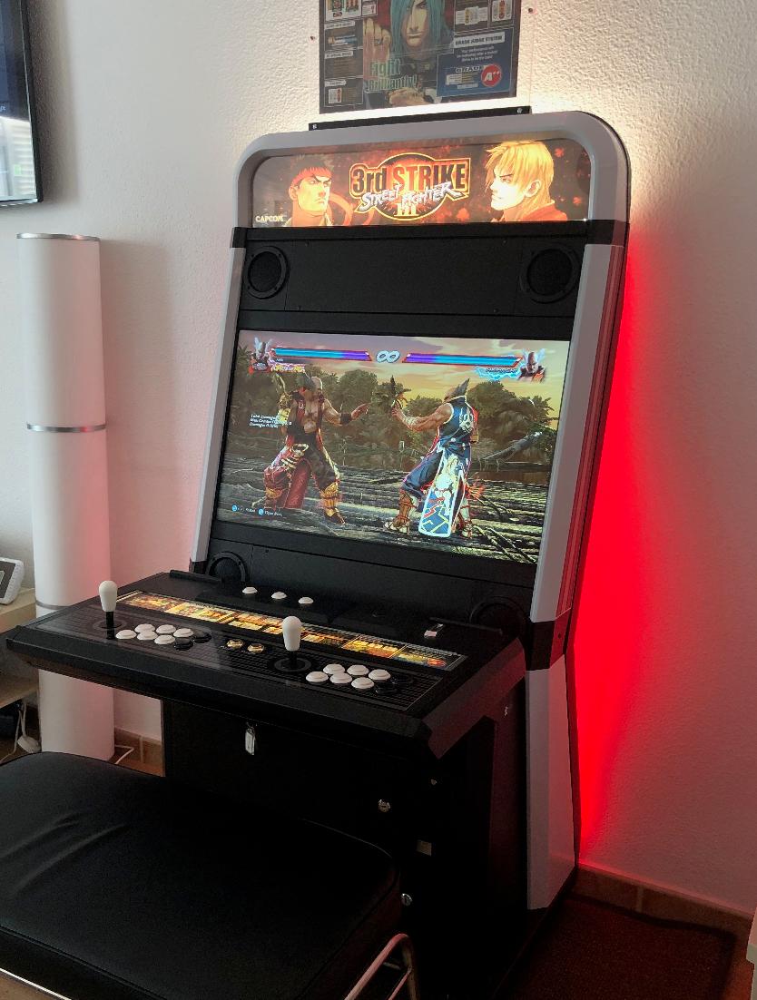

Hello Jassin, I'm the owner of the Vewlix you mentioned above :)
I think it's a complete different point of view, and I found you really hard, especially because as surprisingly as it is, I like proper work, and you'll understand why. I'm not saying it's the best option, I'm saying it's an alternative one.
1. No need to unframe any screen and/or to find a compatible LCD panel to fit in the original frame.
2. Warranty of the screen kept (mine cost me 600$, a 1440p LG 32GK850G-B).
3. No Vewlix (chines or not) will be hurt. There is no glue/solder. So: with 8 screws you revert by the original Vewlix screen (woaw, what an horror show...).
4. You place the screen you want, even 4k or maybe one day OLED (that was my first intention if you read the first topic).
5. No dust, easy to clean (as I removed the glass).
6. The screen is sticker to the frame, improving the feeling that the frame and the screen is one piece.
7. By removing the glass you cancel all reflections.
8. You can place a sharp 1080p screen for 180$ within 20minutes with no skill, without damaging anything.
All this points couldn't be done with the original screen. And remember the point 3: you revert the setup within 20min in the original state.

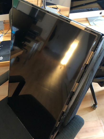

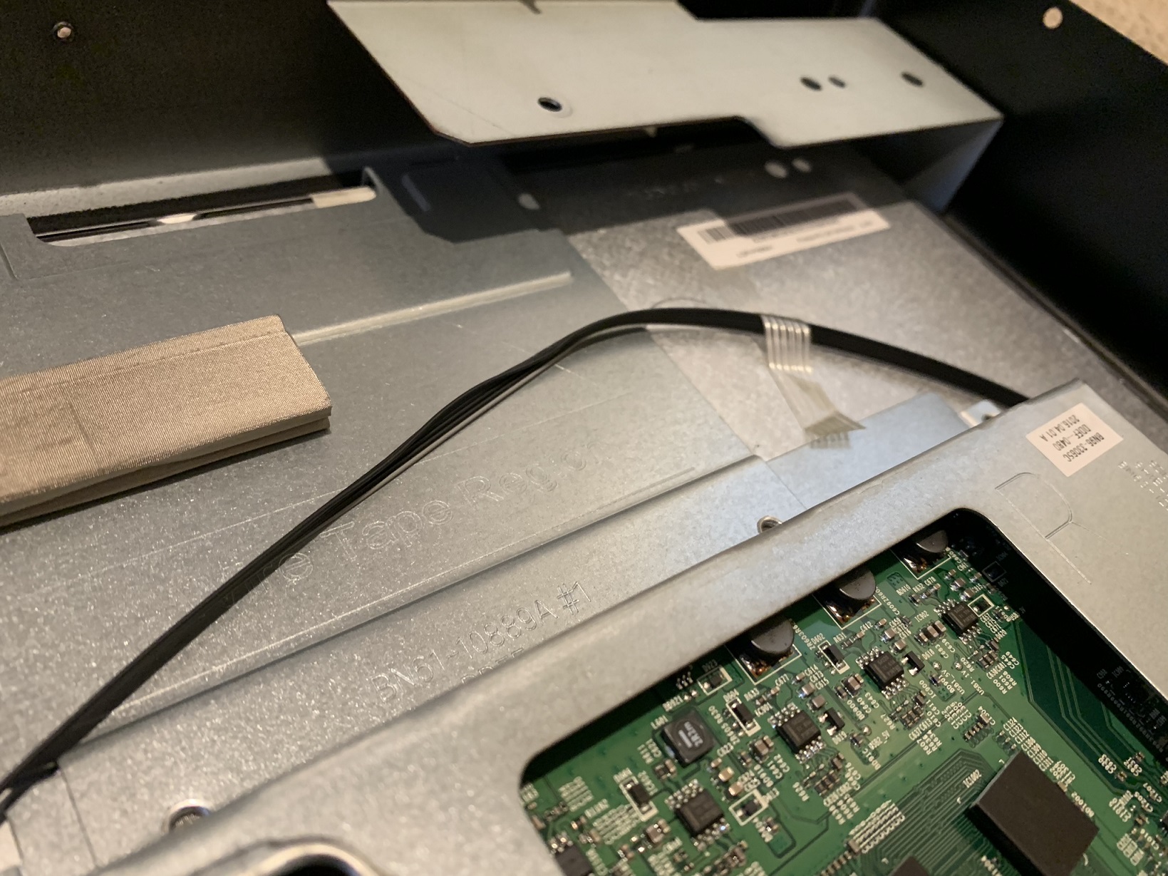

It's important also to understand that I'm giving an easy and alternative solution for people with no skill to change the screen they want. NO, the vewlix won't be damaged. When I had this idea in mind, I also started to unframe the screen I bought. unfortunatly, even if it's the same model Taito are selling, the case was a bit different :
So I was stuck with an unframed 1080p screen. I decided to reframe it, and then I realised...why not putting the monitor, directly in the frame? So yes, I cut 2 pieces of wood quickly to try my idea ;) and I could improve a bit the fixations, but I wanted to show that with no skill, everyone can do it, and I'm pretty sure many people already changed their screen because of this topic.
I took the risk to buy, unframe my first screen, facing an issue (LCD fits, but motherboard on the side can't be screwed on the original frame), and finding a solution that is WAY BETTER. With almost no information on internet regarding screen swapping, I'm really happy to offer this "reversible" alternative.
Regarding the "poor Vewlix". No worries, it's in good hands. When I received it (second hand) the guys was what you think I'm haha (hope you changed your mind?). And I spent more than a month cleaning, putting back all missing screws, buying brand new plastic set, rewiring all boards properly, changing the speakers and...the screen ;)

But also trying to improve, like backlighting the top marquee (which type of paper, etc etc), sound speakers. Here is what looks my Vewlix today:

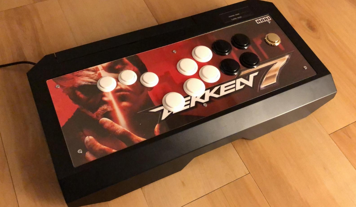

@HighFlow
Funny to see you here! I finished my Hitbox with your plates! Guide is coming soon, here is the result:
