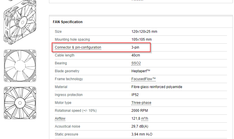

Seems that it comes with a 3-Pin connector:
And also in the accessories tab appears this:
Perhaps is a dumb question but I´m not very good with electrics stuff,so any detailed help will be very appreciated.

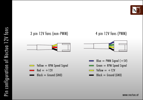

3 pin fans, when sent their rated voltage, will run at max speed. The signals are power, ground, and a tachometer output for monitoring. You only need to hook up power and ground. Running a pc fan (especially a Noctua) at max is not a problem and wont be too loud in the back of a Vewlix.
A pc would control the fan by lowering the voltage of or low frequency pulsing the power line.
There's another kind of fan, PWM, which is 4 pins. You don't want one of those for this kind of application.

I didn't bother with a connector, I just clipped the old fan, clipped off the PWM wire, and crimped butt connectors onto the the power and ground. Quiet, works great, no fuss.
This is the way. Very easy to do with some closed-end crimp terminals and a crimping tool. Amazon sells these things for pretty cheap, prime gets them to you next day typically. Ground to ground (look up your fan's manual to be sure, but typically marked with a "1" on the connector, and normally a black wire within the Vewlix), hot to hot (again, see manual, but normally right next to the ground on the connector, and normally a yellow wire within the Vewlix), any other wires can be sheathed in their own separate nut/terminal. Takes like 10 minutes for the underfan, though the upper fan requires monitor removal (not hard, just a little extra time).
