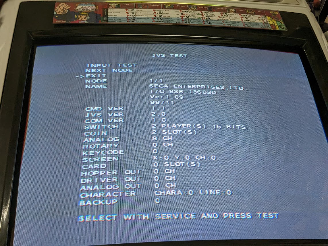

Make sure the IO is appropriately powered, but regardless of that, there are 2 buttons on the motherboard above the PIC slot. Using these you should be able to navigate test menus etc. You can probably fumble thru the menus to find JVS IO info/tests for your IO to see if it's even being seen.
I can confirm the 2 buttons on the lindbergh itself does not work with every game. In the game that did work was Virtua Tennis 3. I tested all of the Virtua Fighters and none of them work with those buttons nor the ones on my super gun. I did get a tip from someone outside of here on the exact jvs I/O board to get but yeah, my naomi 2 jvs to jamma does not work. It does work in the multi menu but only down and start. My thing is, since my cab is jamma, I have to find away to make some harness that goes into the new sega I/O I have to buy and convert that to jamma or somehow make my cab a jamma/jvs hybrid but I am not super adept in the JVS which that will be a learning curve for me.

Also forgot to mention, every single game I chose automatically went to the test menu besides Virtua Fighter 5R which was searching for a network but I could not bypass that due to it not reading my jamma jvs I/O

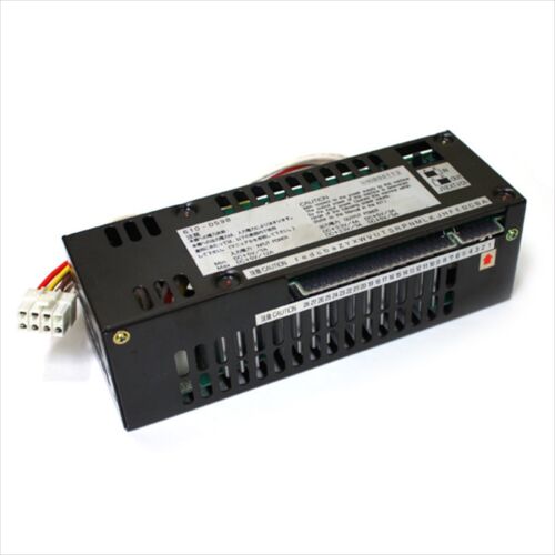

I have spare 838-13683-93 and 838-13683-02 Jamma IOs. I can test them out with the Lindbergh. I'm like 99% sure they work.

Yeah, 838-13683-93 and 838-13683-02 are the v1 Sega JVS Jamma I/Os. They're pretty bare bones and just have a video amp (I think) and handle controls. They don't generate 3.3v or have an audio amp.
So in my testing with the Lindbergh Multi using Sega Jamma model 838-13683-93, there seems to be some kind of issue where this adapter disables SW1 and SW2 on the Lindbergh when playing certain games. I have not tested all of the games yet as I am only interested in playing Virtua Fighter 5 vanilla. In my tests, Virtua Tennis 3 is the only game to allow the use of SW1 and SW2. In the input test, all the buttons registered fine. I used a Neo Geo Aes controller and a Street Fighter 4 Mad Catz Xbox 360 arcade stick. I have yet to connect this to my actual Jamma loom but so far with a supergun, this is the issue that arises.
