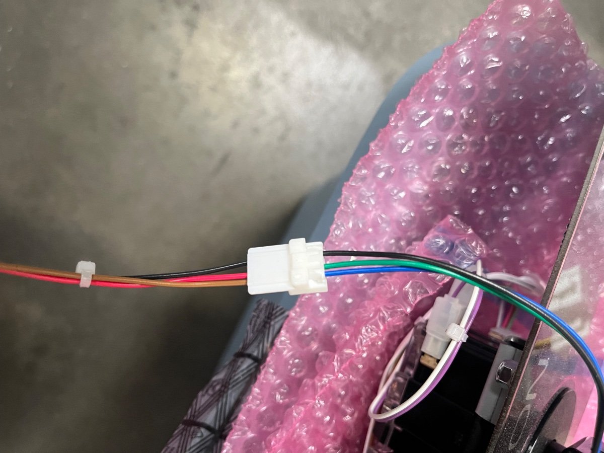

Thank you. Do you know where I can purchase the materials to make the harness?
Also, which outgoing wire is for the top button and which is for the trigger? I’m guessing the black is ground.
The black wire is likely GND . You can use a multimeter in continuity mode to trace each wire back to its corresponding button.
The connectors are typically JST or Molex,you can check their product catalogs for pinouts. However, if it's for personal use, you can simply cut and solder the wires directly without worrying about the connector type.
