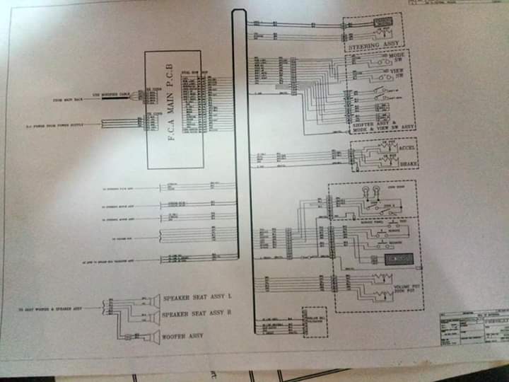

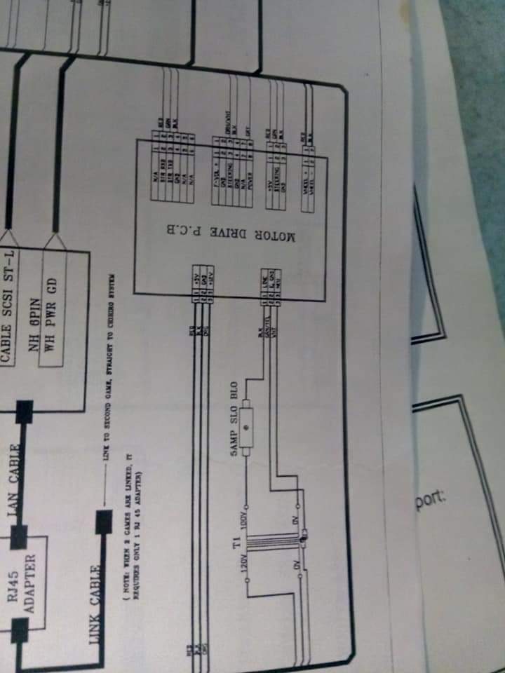

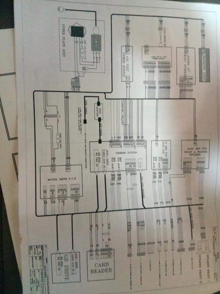

I have the manual for the cab. The one on the internet is for Wangan 3 I will try to upload it this week. Need to take to office Depot or something so they could scan. My PC is broken.
@freddiefiasco what kind of cab do you got. I mean wangan 1,2 or three. Because the one I got is 2 but it's the same for 1. The manual I have only shows 1 fuse and the cab only got one fuse
I uploaded the this if it helps.

I have a WMMT1 converted to WMMT3 console. 1, 2 and 3 use the same wiring.
There are some cabs that have 1 fuse, mine just happens to have 2. If i have some time this coming week, I will try to trace both fuses and see where they go. In the manual, it only shows wiring for 1 fuse for whatever reason. I will give that reason once I collect more data for you.
