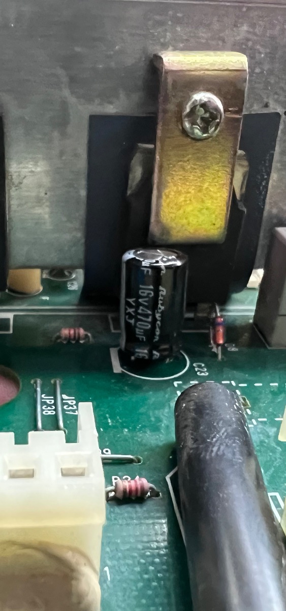

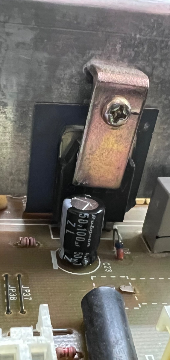

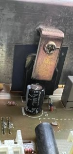

Yes, both pretty much identical. The one with the 100uf cap works perfectly fine, outputs all the corrects voltages.470uF 16V is correct for 400-5261.

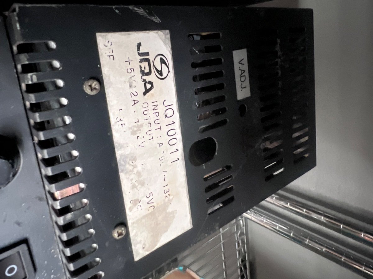

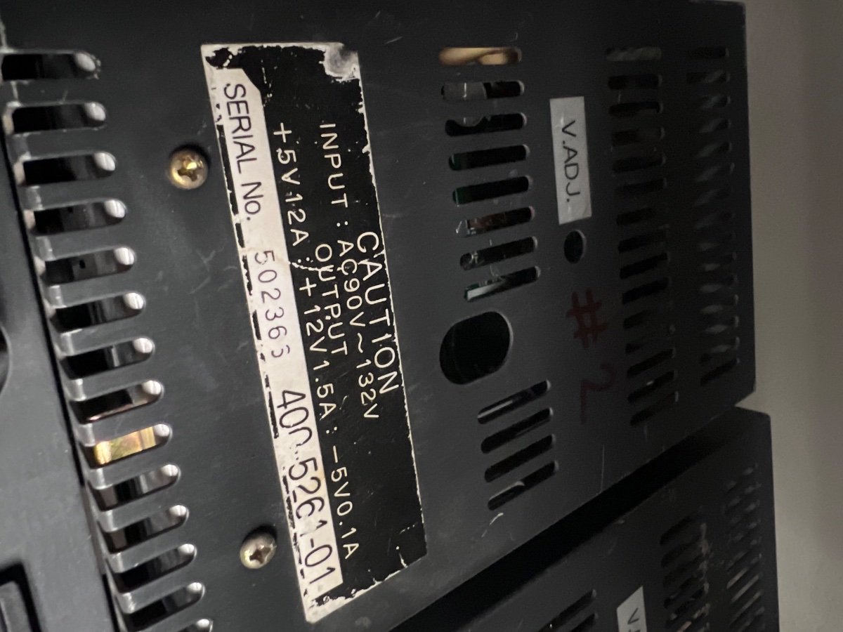

More Astro City PSU recap work. The models are:
400-5261
Code:Capacitor Diameter Qty Location 0.47uF 50V 5.00mm 1 C11 3.3uf 50V 5.00mm 1 C26 100uf 25V 6.30mm 1 C25 470uf 10V 8.00mm 1 C28 470uF 16V 10.00mm 1 C23 470uf 200V 30.00mm 1 C5 1000uF 35V 12.50mm 2 C21, C22 6800uf 10V 16.00mm 6 C12, C13, C14, C15, C16, C17
400-5198-01Y

Are the PSUs identical otherwise?
Yes, bothDo the solder joints look like the cap has been replaced at some point?
