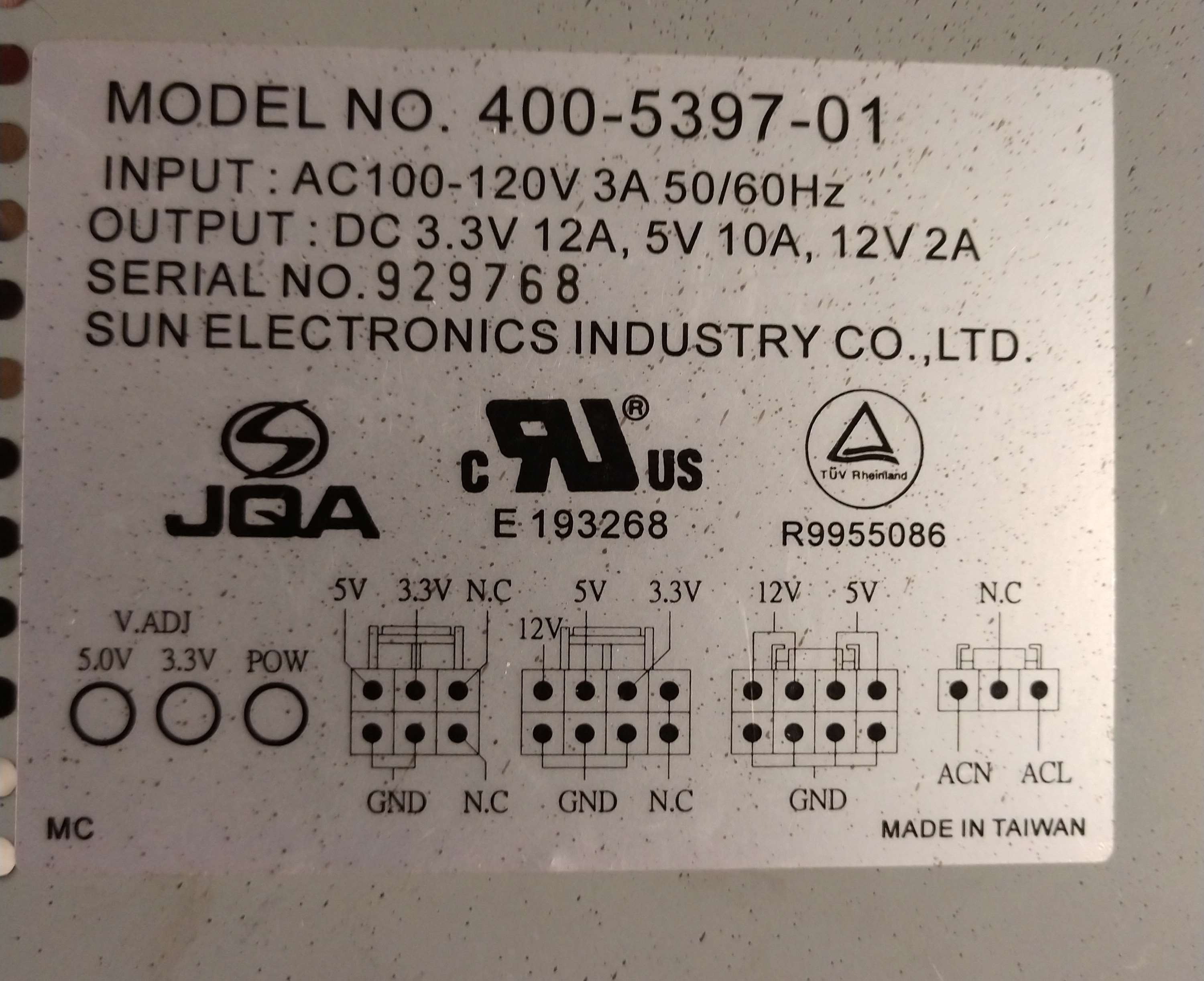

There are versions that vary slightly but any of these will power a Naomi 1 or 2. The other versions are just beefier and meant for larger driving cabs with extra components.
