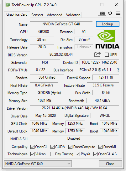

Model 405 - Puzzle & Dragon
video card: MSI GT 640 (1 gb ram)
Firmware: MSI GT 640

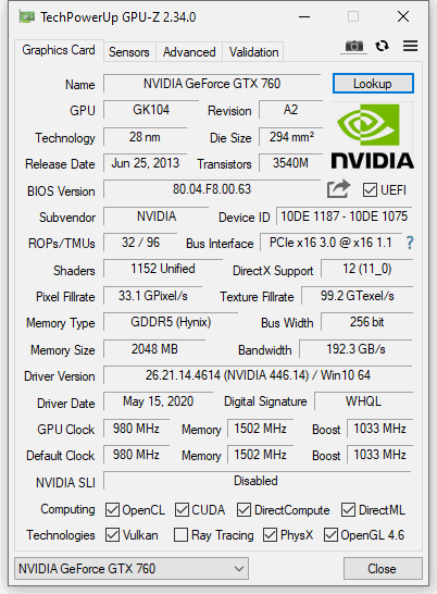

Model 407 - Figurehead A
video card: NVidia GTX 760 Founder's Edition (2 gb ram)
Firmware: NVidia GTX 760

Just for anyone who stumbles across this thread in future.
We now know that the issue with video cards not booting is that you require a NON UEFI bios on your video card. This is why a lot of the newer cards don't boot in the TTX3 system.
You need a card that works with a NON UEFI bios, pretty much all cards after the gtx 7** series cards don't have non UEFI bioses available.
