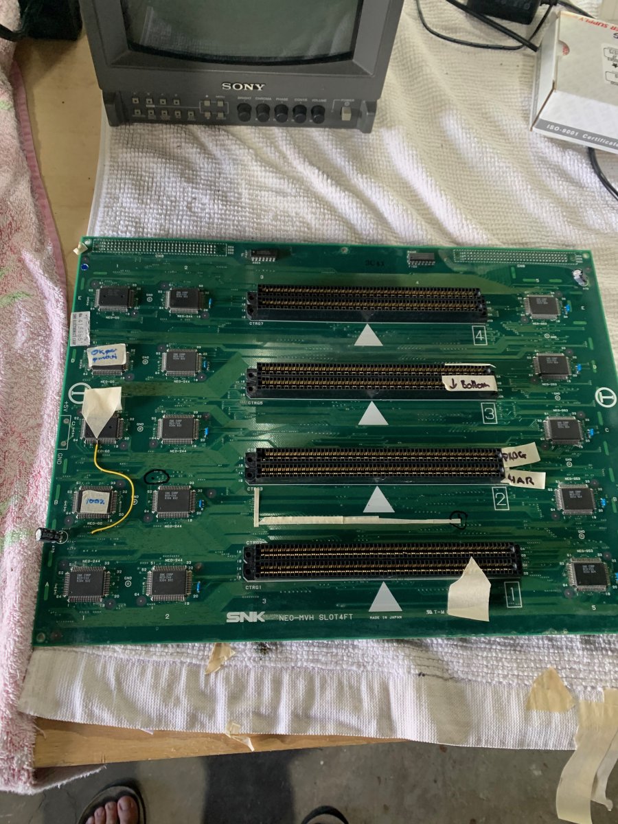

Then I took the top board off the MV4F and ran the standard Universe bios sound test, worked perfectly
Then I put the top board back on and ran the standard Universe bios sound test, nothing
So the problem is in the comms between the bottom board and the top board.
The top board is a pigsty - will clean it up so I can see what's going on and start looking for bad traces
so maybe a multiplexer between the lower board and the romslots.
hopefully not a custom 4 chips in one package job.
So a quick wash of the top board and I think I may have to do some trace repair before messing with the C1

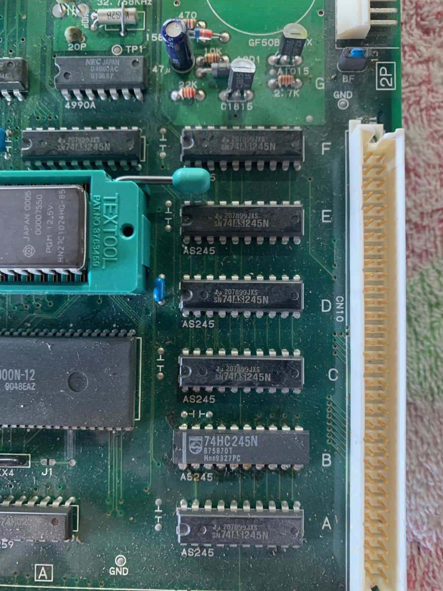

on the bottom board it looks like someone has replaced one of the AS245 chips wth an HC245 and bodged a resistor array onto the back

It would be extremly tempting just to swap the top boards over, but SNK thought of this and have kindly offset the connectors by 2.5mm between the MV4T and the MV4-FT2...
as afaik can handle more current than hc and is probably faster
you really want the AS version of that logic IC, "Advanced Schottky" can't be replaced by the slower ones successfully IME

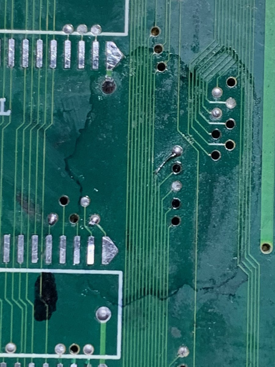

also, there is a lot of rotten traces on those PCBs
the dark patches/discoloured traces, every one of them is a candidate for being disrupted, vias can be rotten too
these PCBs have a high tendency for rotten traces, often on the top side where things just fell onto it and had decades to do stuff
for simple cases I scratch off the solder mask and re-tin the copper beneath it, if there is any left
short jumpers are fine, the shorter the better, you don't wan't to route fast clock signals through shitty jumper wires that are a foot long ;)
these rotten traces can even be beneath ICs, but fixing the obvious ones comes first IMO

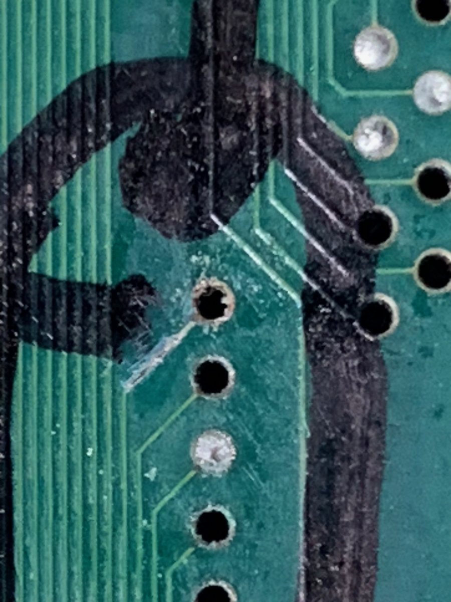

And the reason it does not... There was a tiny, absolutely invisible break in this trace
Here it is with the solder mask scraped off, still impossible to see
And here it is fixed - now Upper BRAM pin 19 (IO8`) does go to 68k pin 54(D15)

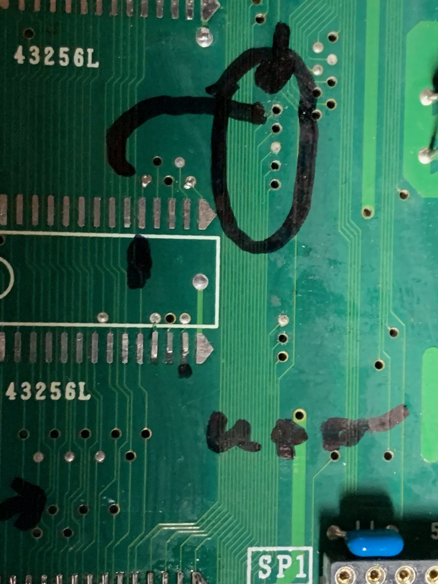

But the course of true love never does run smooth. Now I have to fix these three other pads I damaged in the process :) Then I should be able to clear the backup RAM error
So close - so close.
Have repaired the pads where I could, jumpered the other one, and re-installed the ram.

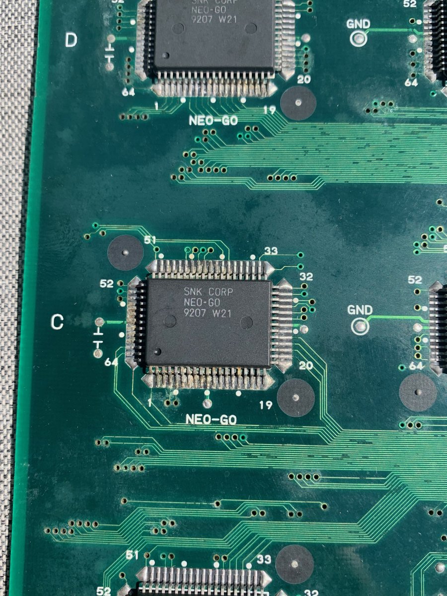

Slot 1 is now fixed -I'll post my notes and pinouts later but the TL;DR was
Symptom - distorted digtial audio on Slot 1 only. Digital Audio on all other slots OK, music on all slots OK. Passed neogeo diagnostics with z80 test OK.
Solution - No continuity between Slot 1 PROG B51 and NEO-G0 at C1 on pin 8. Jumpered Slot 1 PROG B51 to NEO-G0 at C1 on pin 8 to restore clear audio to slot 1
Details
Digital Audio is on the PROG board on the B (Bottom) side, SDPAD0 - SDPAD7 (B41-B48) and SPRAD0 - SPRAD7 (B49-B56)
Unfortunatley there is no easy-to-follow pinout for the MV4-FT2 top board so I had to beep and guess every single pin
Eventually found
SPRAD1(B50) went to pin 7 of the NEO-G0 chip at position C1 on the top board
SPRAD3(B52) went to pin 9 of the NEO-G0 chip at position C1 on the top board
BUT
SPRAD2(B51) went nowhere when it should (I assumed) go to pin 8
Reflowed NEO-G0 at position C1, no improvement

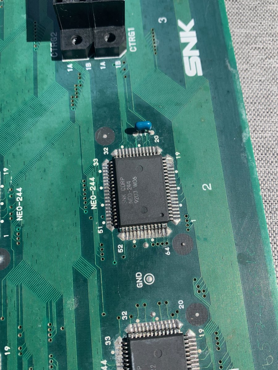

The broken trace was actually UNDER the NEO-GO at C1
here it is after I tidied it up a little bit - I left this one as obvious as possible so I can find it easily later.
So this one was not too hard, I already knew roughly where to look
