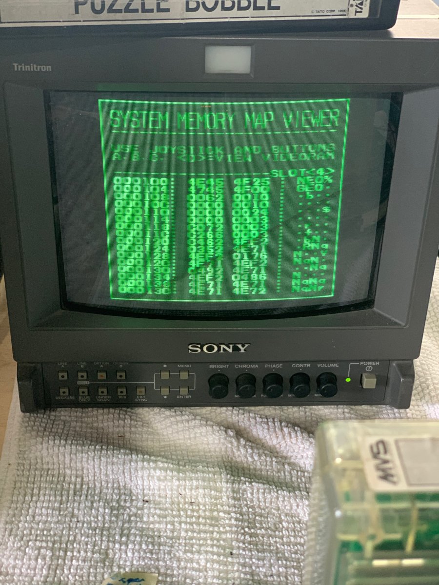

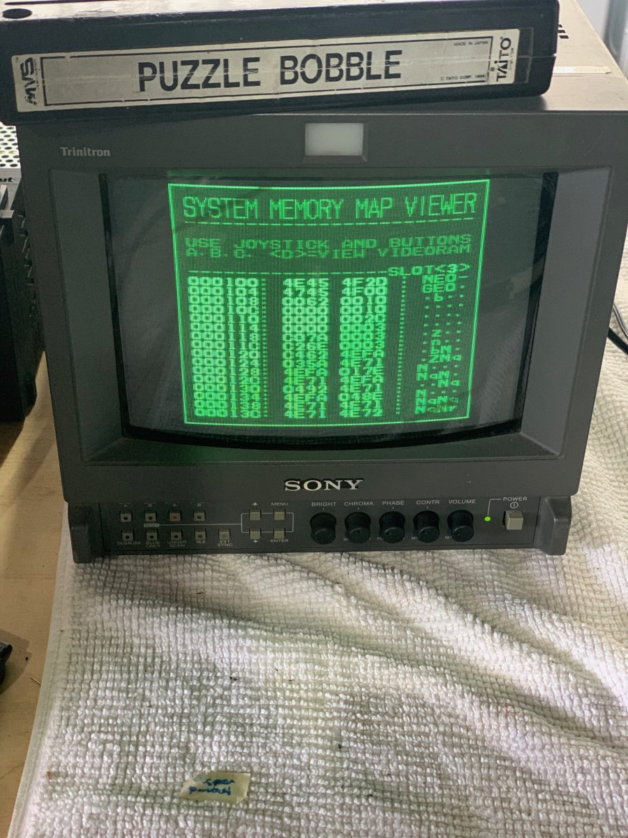

To trace the remaining fault in slot 4 I looked at the memory map from slot 3 and slot 4 and compared.
The 4th bit is wrong (stuck high) on slot 4. That 4th bit is addressed by d3 which is pin A8 on the prog board

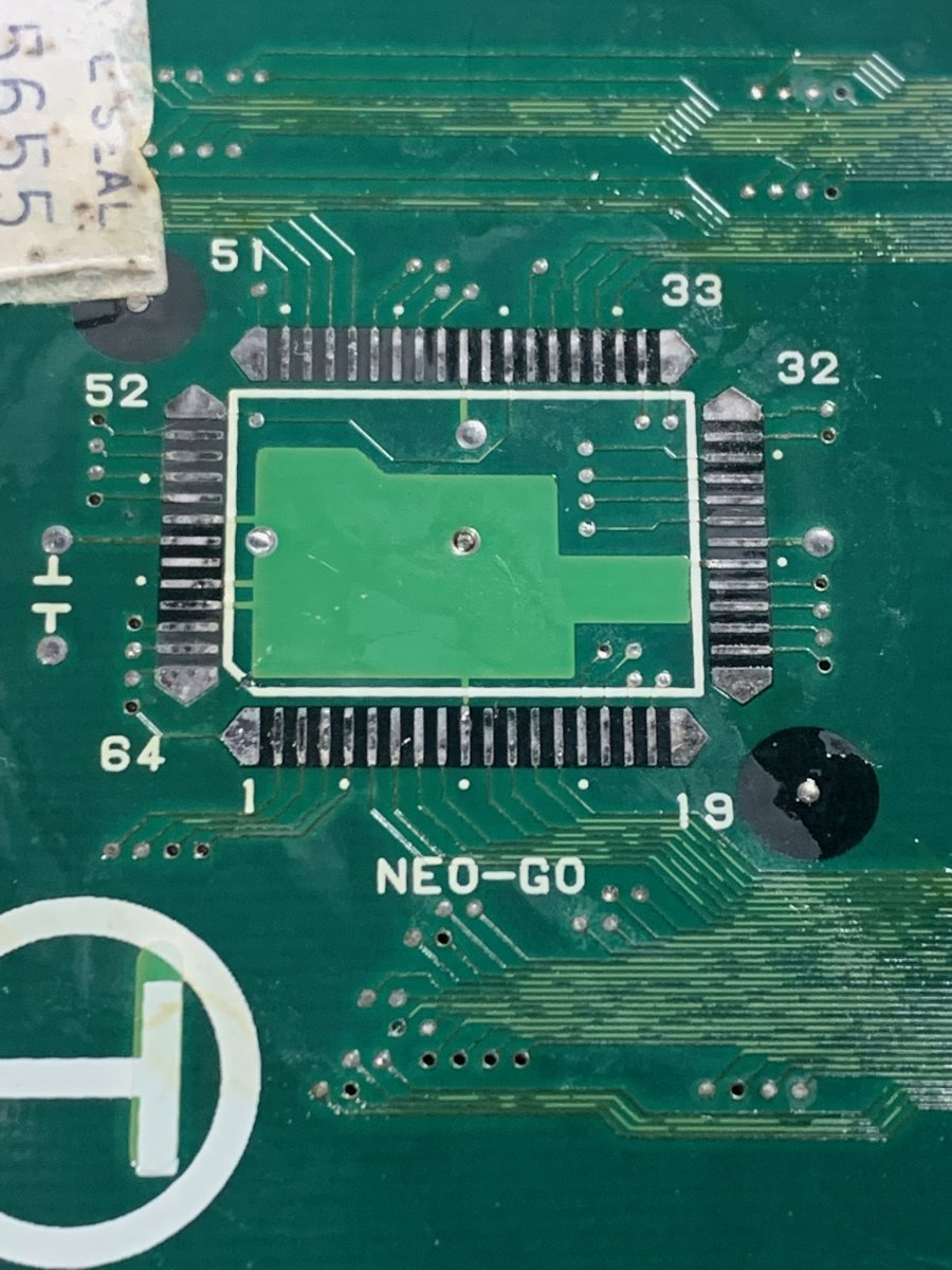

All the traces are good - really that leaves me with a possible bad AS245@C11 or a possible bad NEO-G0@D1
Changed the AS245 = no improvement (I didnt really expect that there would be, but it was much easier than changing the NEO-G0)
So onto the NEO-G0 at D1
Looking inside the NEO-G0@D1 it looks like it is made of 4 x AS245’s all mashed to together on one chip
https://wiki.neogeodev.org/index.php?title=File:Neo-g0_internal.png
All of the problems seem to be associated with the address lines for slot 4, all of which are switched in what used to be U3 an AS245, before they all got bundled together onto the custom.
The AS245 is an SNK custom chip - furrtek on tindle makes replacements, but I was able to borrow one of the MV4F with the z80 problem

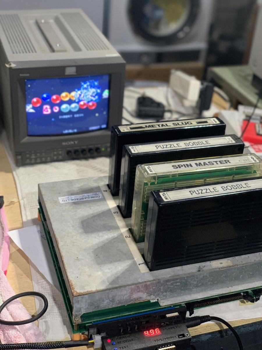

And now, finally, working perfectly. Flawless Victory!
I'll write up my notes properly shortly - before I did that I wanted to say a huge thanks to everyone who has posted in this thread. This project has taught me more about electronics repair than I ever thought possible - thanks team!

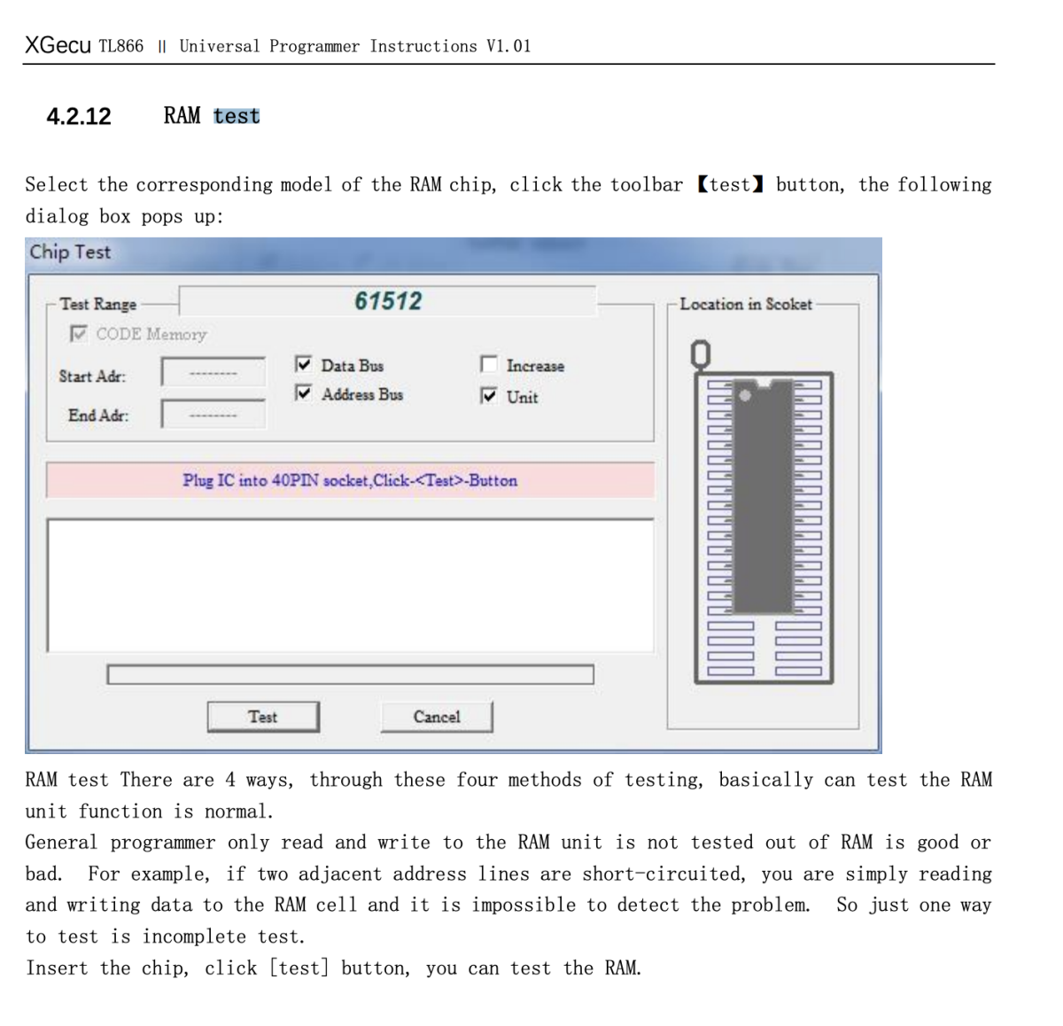

can your programmer test sram?
I’ve been looking for a low cost sram tester. Would have helped with my recent repairs. But the common TL866 series of eprom programmers doesn’t seem to. Or at least I couldn’t find a way in the software. There are a number of different open and closed source projects for memory and other chip testers, but even the kits tend to run in the hundreds of dollars. Always been to expensive for a tool I’d use maybe once a year.
It does work, use the compatible generic JEDEC types, its just a simple test so it won't verify the timings of the ICs, but the general function will be tested.
The retro chip tester doesn't test the timings neither. I wonder if any programmer actually does (seems to be harder than I thought, with lots of false positives).
