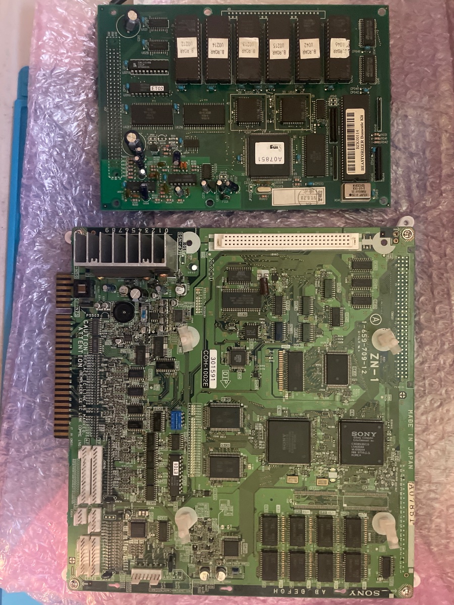

Yeah i think now best thing to do is try the romboard on a known good main board.
Send a pic of your mainboard too! Maybe it's a missmatch...

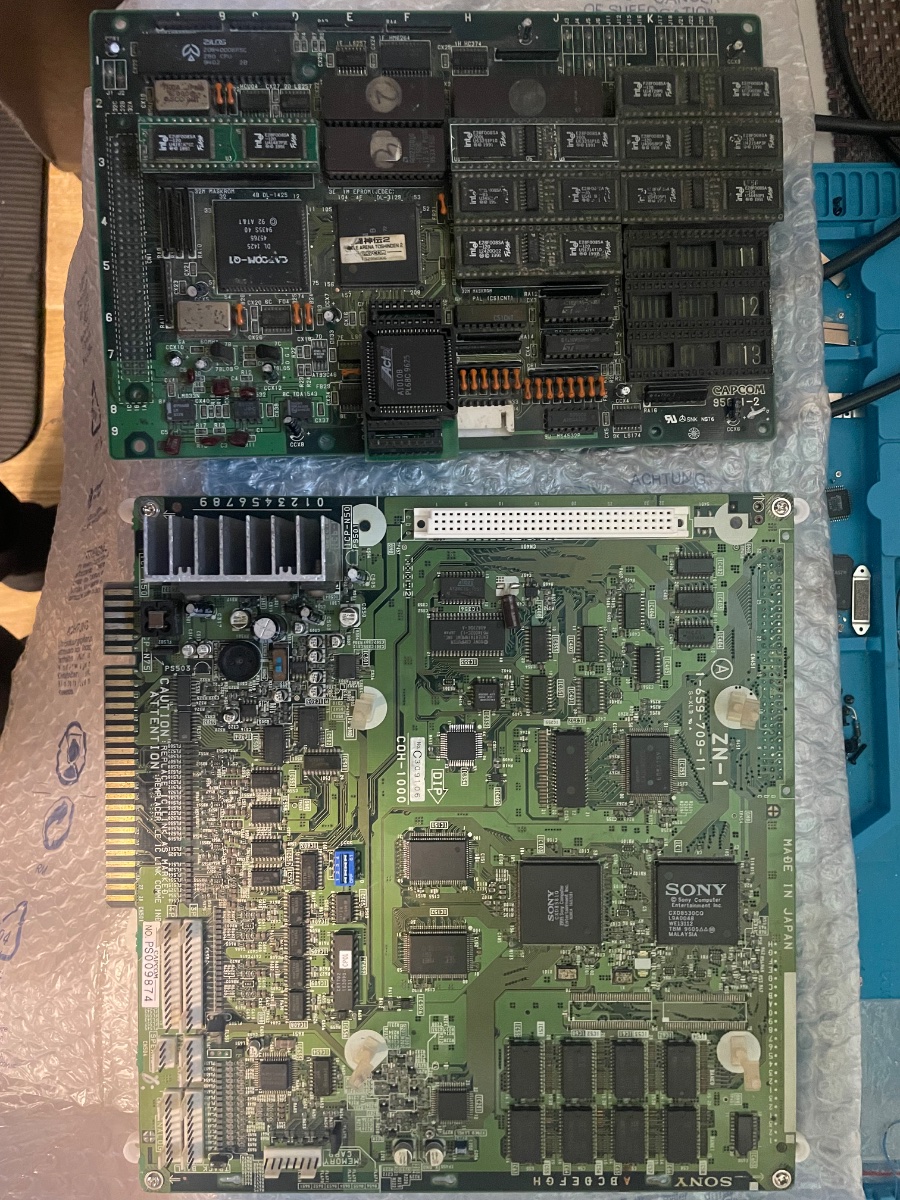

I also have this arena toshiden 2 according to the sticker on the top board , but the EPROMs read as street fighter ex so I guess someone converted it with those flash chips? The top board with the socket empty has that bigger Actel chip going there (have it laying beside it)

Yep that looks correct!
Does IC353 say -54 on the chip?
Yeah that's a bootleg conversion , would of been a toshinden originally.
Is this one also non-working?
Probably a good candidate for bios board :)
The 2nd VRAM is clearly added on too :D

remove the top board and see if you get a blue screen or cannot find program rom....
-54 beastorizer gives me a blue screen but no code, with the bootleg top it gives me a code
Bootleg bottom board just boots to black without a top board
COH1002C is not compatible with capcom games.
I think the motherboard is fine here, but there's a top board fault
i think the black screen bottom board will have other issues
The top board maybe alright ...
Swap IC's 652 and 353 from the capcom motherboard onto the raizing board
Then try the capcom top board with it... Probably it will run... :D
(put the DIP chip in socket)
If not, remove them chip carriers and burn all the roms with 322's from the mame set and try again :)
If not, i could do a "lame patch" so you can remove that actel thingy :)
This should leave you with the faulty raizing top board and faulty motherboard (and a couple of loose chips)
I would not do any more to the raizing top board for now, best to wait until i have tested the mach dumps.

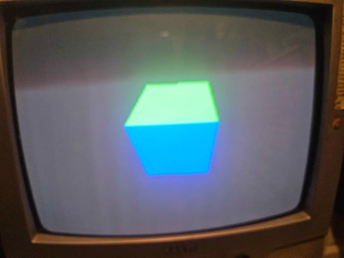

Spicyjpg has ported OPENBIOS to ZN1 :o
So now homebrew / PS1 porting is possible!
https://github.com/grumpycoders/pcs...nges/3e6bf9845be84f10b56e1ea5e2b27d4d1666f2b6
I tested it, and it Works great!
https://drive.google.com/file/d/1B1KilYPx1CZ6zw0wTBOf3U5qDIYcO1wT/view?usp=drive_link
So, if anyone has bios boards, you can now load PSX.EXE's from rom (providing they fit in the remaining space of the 512k/(4mbit) bios bank)
The EXE needs to be compiled into the binary.
Stuff needs testing and there's 1000's of things on PSX so give it a go with some random demo's / small games if you can :D
<expect crashes if the software you are testing may use CD commands etc>
The openbios is running on K573 hardware too, for those who missed it! :D
