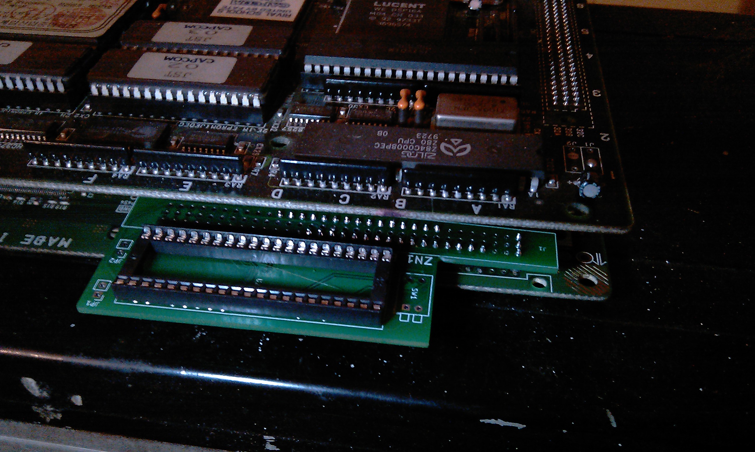

Good times, The v1 of the bios board arrived today. This post will document how it goes...
This is still W.I.P. Project, LOTS TO DO and LOTS UNKNOWN armed with this PCB that should slowly dwindle.
Thanks to @Mr T Guru @CoolFox @smf @caius for your ideas and work on this concept.
You all seen the psychic force insane video, this is a streamline version of that hack.
These are DECRYPTED not re scrambled versions!

Hammy brother , you know what to do further ! Hope more friends to be involved in other projects you've almost done too (at least ZN2 will be a very big hit)

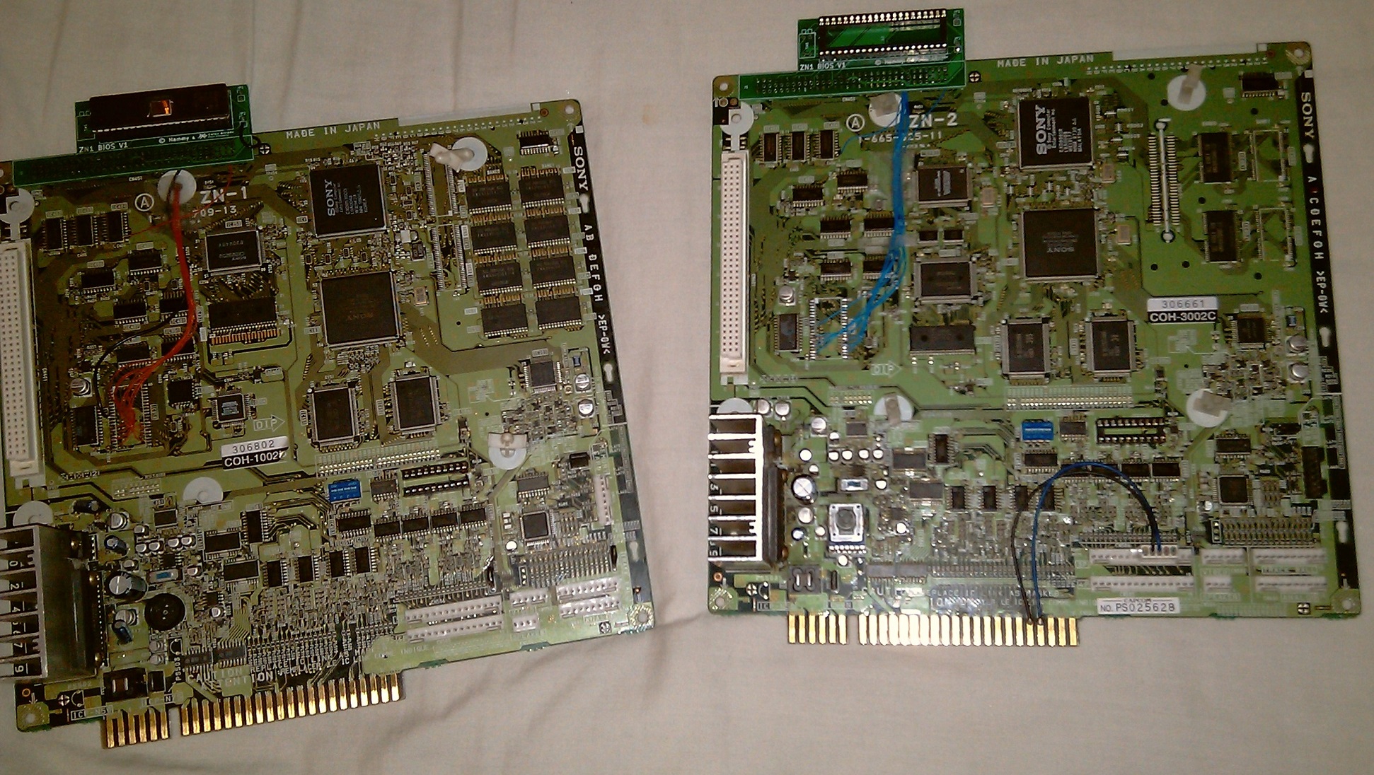

I'm sorry but I was misunderstood I don't mean the gnet games.
But since the gnet is composed by 3 PCBs and the main board is a Sony ZN2 (if I'm not wrong) I was asking if the mainboard can be used with the proper romboard for a future product from you :)
Prob. not worth modding, it would then be useless for the g-net.
The GPU's are different on the ZN1 and ZN2 also , mixing the hardware prob won't work.
