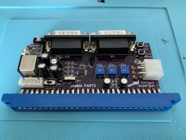

Sir ... i must crim the psu harness between Minigun and PSU and i don't know how to match the color to terminations and i don't know long must be the cables i must crimp. can you tell how to do it ? :whistling: will be my first harness made by me

I think voltages are silkscreened on the underside of the MiniGun. So dry fit the connector and check with a meter as you go along to be sure.
American wring color scheme is:
  • Ground = Black
  • +5vdc = Red
  • +12vdc = Yellow
  • -5vdc = Blue (typically)
Japanese wiring color scheme (by Sega standards) is:
  • Ground = White
  • +5vdc = Yellow
  • +12vdc = Red
  • -5vdc = Brown
Pick one scheme and go with it (I'm American). You can always go with one wire color as long as you don't cross things up:
  • +5v off PSU to +5v on the MiniGun
  • +12vdc off the PSU to +12vdc on the MiniGun, etc.
As for length, about a 8-10 inches should be the goal so you don't have a rat's nest. But this is situationally dependent on your wall power source location. Do you want a long AC cable to your PSU, and thus a short power cable from your PSU to your MiniGun? Or do you want a short AC cable to your PSU, and therefore need a long power cable from your PSU to you MiniGun? In my best bench setup, I want a long AC cable to the PSU. And I want my PSU close to my MIniGun so I can dial in voltages. So I opt for a short 8" power cable.

Thank you for this project! I just received the pcbs and the parts, soldered them and it works nicely.
