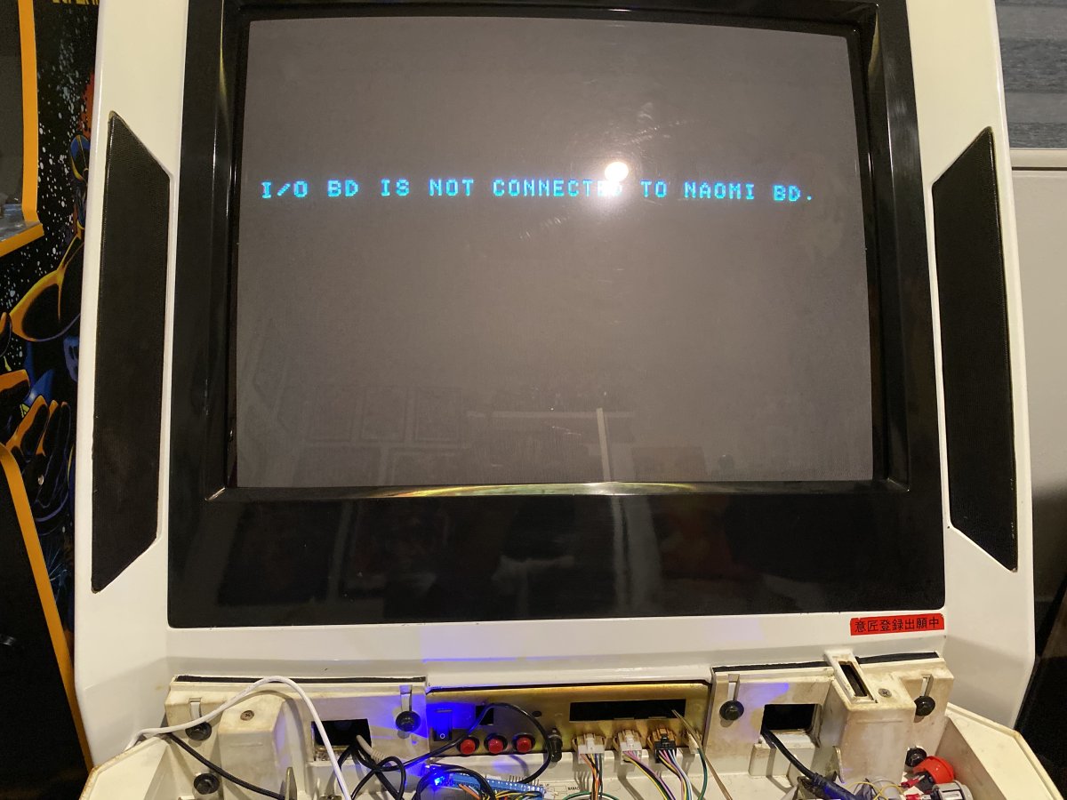

btw, I tried loading Initial D Export and Initial D 3 Export and still got
"i/o bd is not connected to naomi bd"
However, I was able to play both Crazy Taxi, Jambo Safari AND Club Kart (Naomi 2) just fine.
I'm using the US bios.

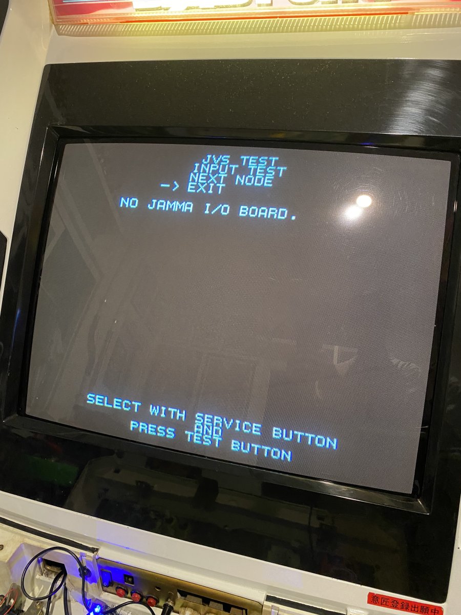

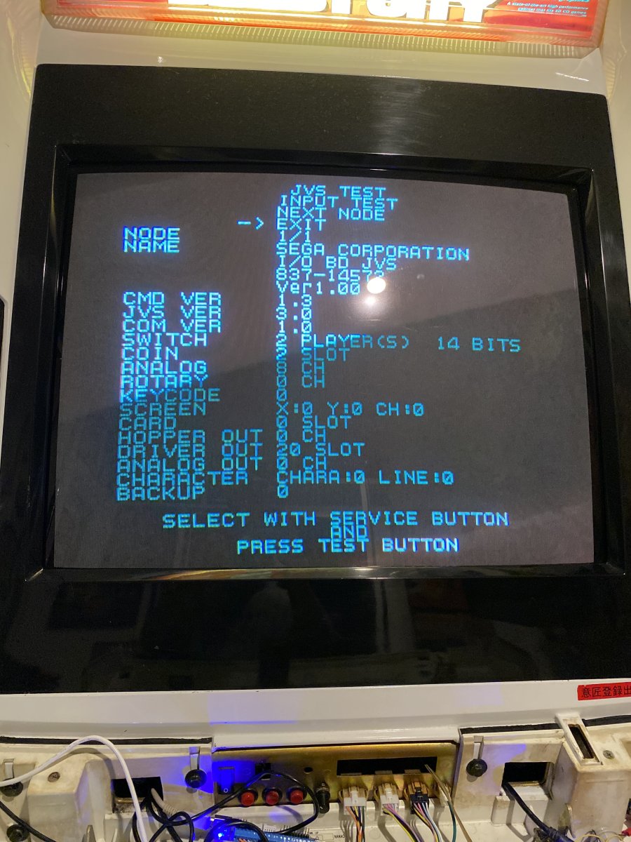

The JVS test screens confirm Crazy Taxi and Jambo Safari work. I can see the analog move.
With the Initial D Export, the test screen says
"NO JAMMA I/O BOARD."
Using v6 AIO image from your google download.
Are you using a physical IO board or OpenJVS? Sorry, I'm not sure what you're demonstrating here, that the v6 image somehow doesn't seem to work with Initial D games? I've used a type B Sega JVS to Jamma adaptor and OpenJVS and both work fine, I wonder if maybe it's an issue with the revision of your IO board? If you're not using OpenJVS, all the Pi does is netboot the game, it has no bearing on IO detection.
