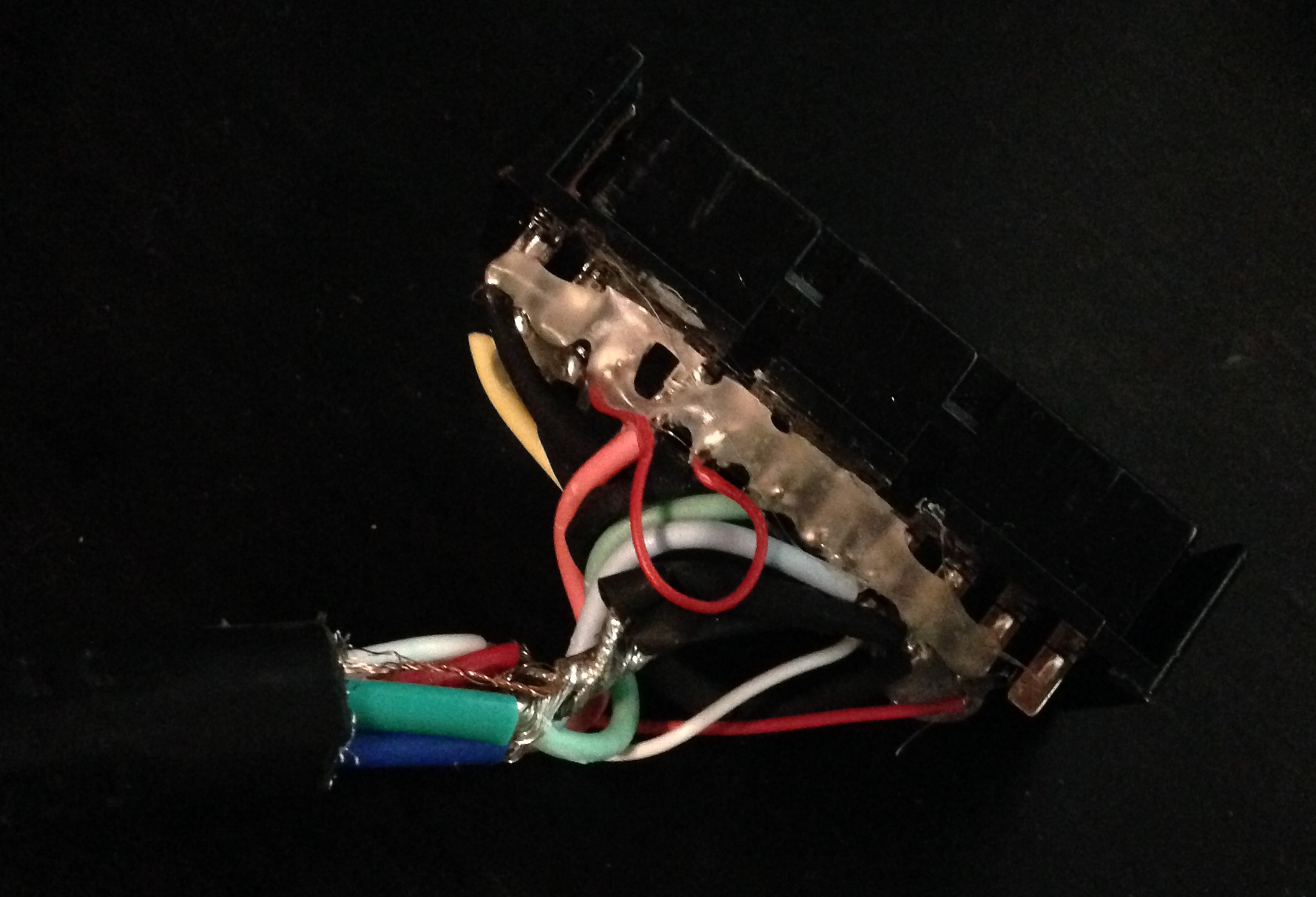

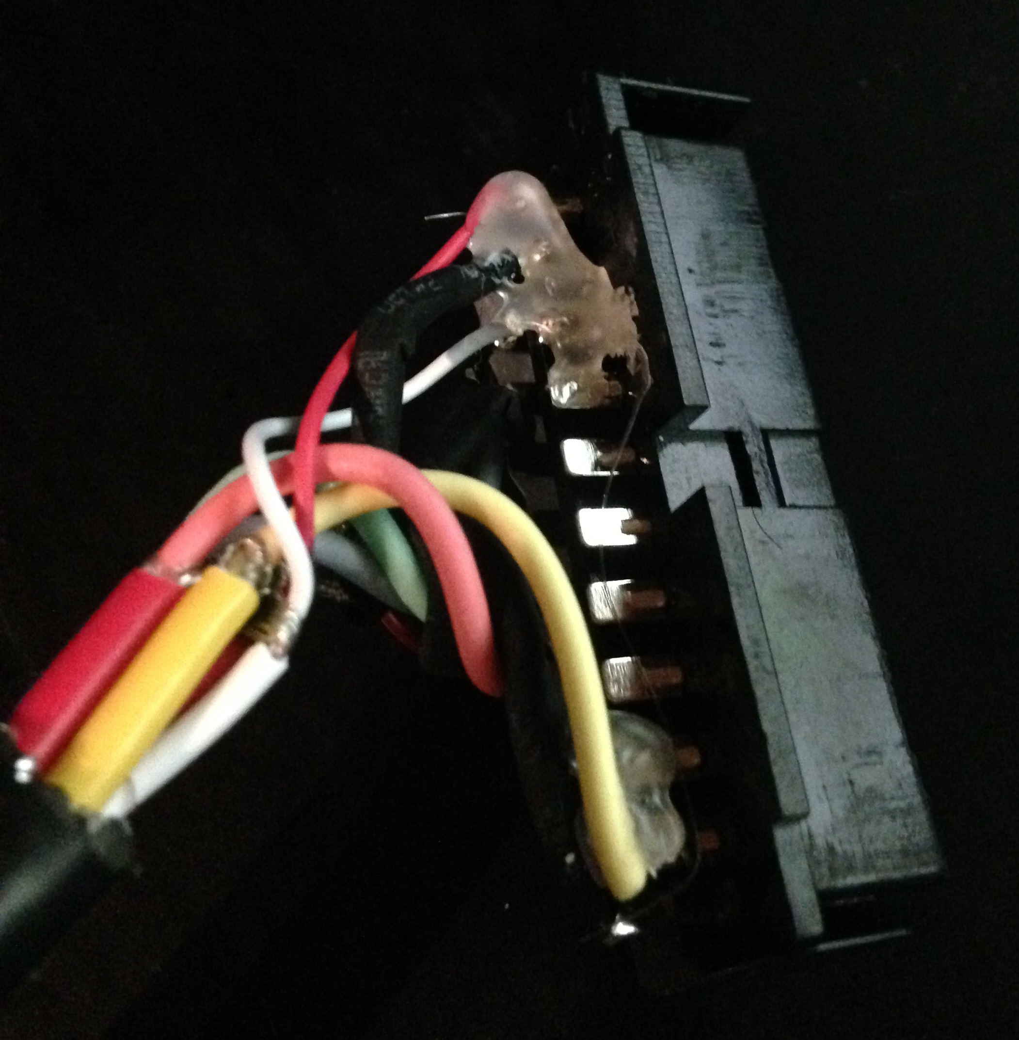

Would a multimeter help me figure out which wire is properly connected to the gold point or not? I won't be able to do much about until next weekend when I should have my hands on a good paste flux.
Good choice. ;)
Yes a multimeter can be used to confirm your wires are properly connected. You would put the multimeter in continuity mode, then use one probe to touch the pad on your CPS2 multi (not touching your wire) and the other probe touching the pin on the CPS2 B board (again not touching your wire).
Your CPS2 multi isn't ready until it looks like this... ;)
<X <X <X
Holy hot glue and zip ties!
That ^
Anytime I'm questioning a solder joint I check continuity.
Sometimes a wire can look ugly but be physically connected just fine, it's worth checking before blindly resoldering everything.
Apparently its ok to use snot for insulation on a £24 cable from ret********cables.co.uk too...
