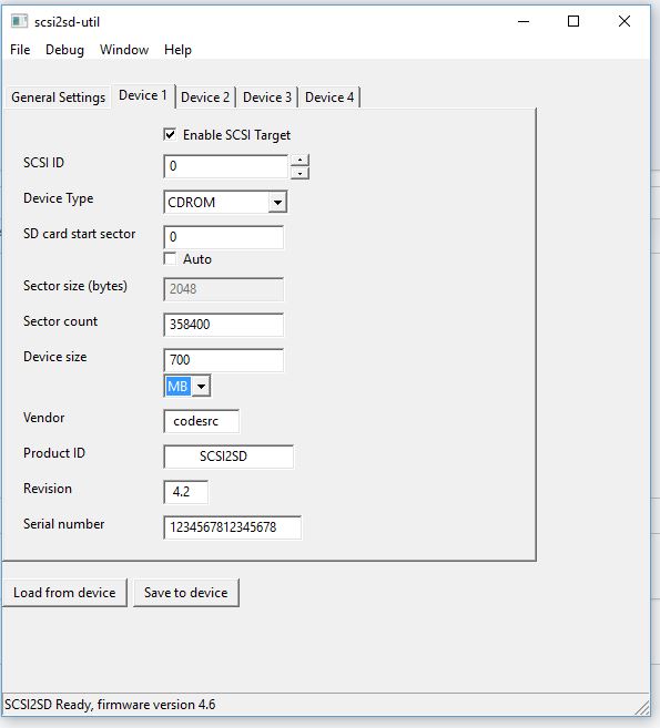

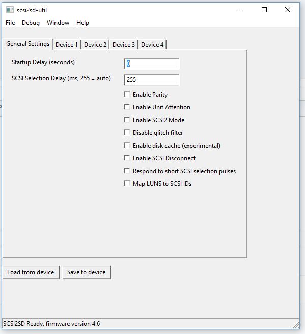

Just got mine - after much delay caused by eBay Global shipping system - the one I got was already at V4.6 Firmware and I had a 2Gb micro-sd out of my old Blackberry phone I could use.
I downloaded the iso for the custom SH2 (as I have a normal CPS3 cart with Darksoft bios) and used "Win32diskimager" to transfer it across so far so good....
So I fire up scsi2sd-util.exe - Symantec moans but I allow it to run and I get these two screens
I know I have to set it to CDROM and 700Mb but what about parity & SCSI-ID's or are they OK at the default values?

Followed the directions in this thread, working awesome!
