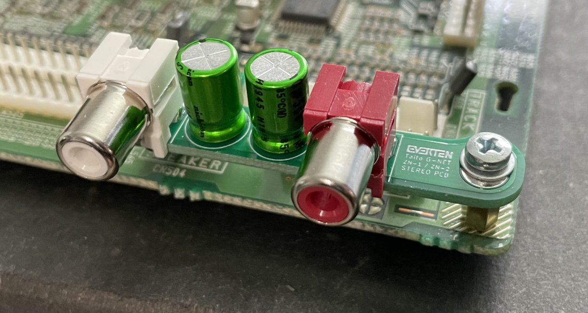

Just treat it like any other audio source. The add on boards are simply tapping existing audio outputs. The System 1 already outputs line level audio on the J108 headers. You could easily make your own RCA wire harness, without any circuitry, to accomplish the same thing if you are concerned. My board is just a more elegant solution, does not require any real modification, and can always be removed.This might be a silly question, but anything I need to know about the audio out on those RCA jacks in terms of risk to the system I'm putting sound out to or back to the arcade board? Namco System 1 if it matters, but also sort of a general question with the add-on boards.
I have the design and physical mounting figured out, but need to revisit the circuit.Hi,
