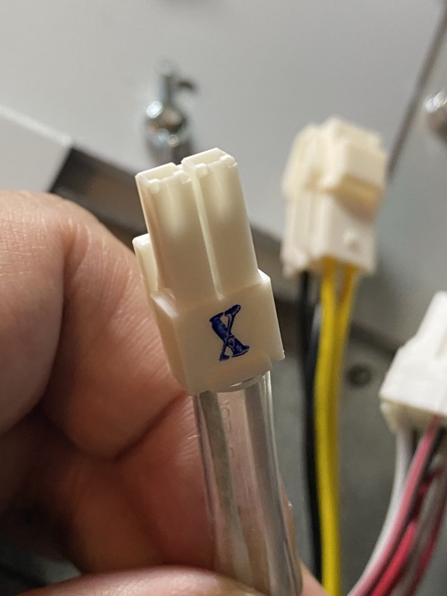

Hello. Could somebody please direct me to more info on the "X" cable inside my control panel? Is it for the move strip LED that I don't have?

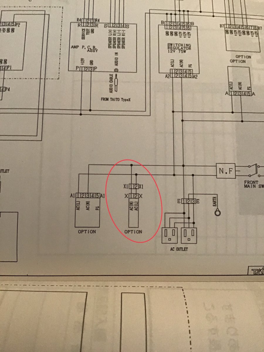

According to the schematic in my Diamond Black manual, it’s straight AC. Could be for a LED with power adapter, but it’s just marked as option.
Great! Thank you both for confirming this is for the move strip light.

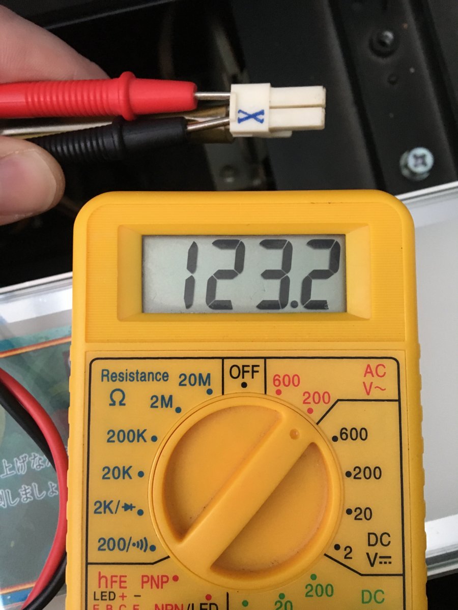

Ummm, the wire marked X is 120v AC not 12v. Be careful.

Yes, it is. I'm just trying to say "convert the line down" to 12V for LED lighting. But I'll leave "X" connector alone and just get my 12V somewhere else.
