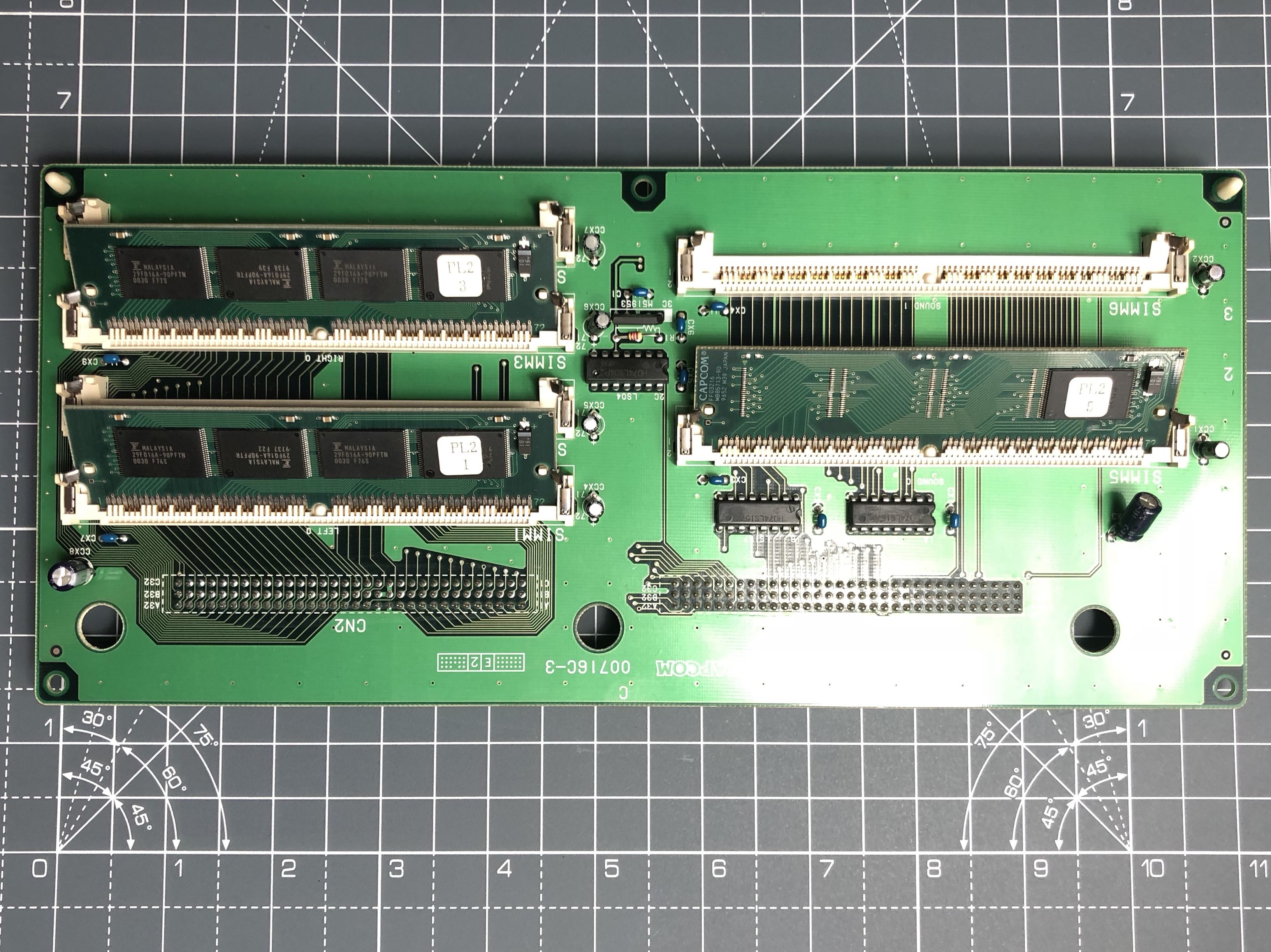

Do CPS2 Simms work on CPS III? I have a Puzz Loop 2 board I plan to use with CPS2 multi with (2) 64 and a 32 SIMMS. Odd thing is the 64's don't have the usual Capcom text (model #, size). The flash chips are only on one side, so I'm assuming they are 64.
32mb simms can only be used to to run New Generation. Slot 3 is the only slot that accepts it if my memory is right.
Those 64 mb simms should work though. Pop em in and try it out.
Edit: It's actually simm 5 that accepts the 32mb simm.
The 32 will work in slots 3-7 but is only used in slot 5 by games. But yes the cps2 simms are the same as cps3.
they're the same as you can use a cps3 pcb and cps2black to rewrite the simm with phoenix/avalaunch roms to resurrect them if the battery fails.
I did it on my sf2ha all in one board.
So if they have 4 flashes on the front and
are 64Mb they're good to go.
