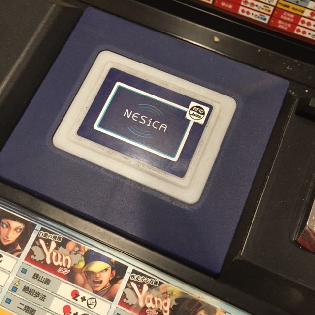

Does your multi work with the fast IO? I got 2 new vewlix cabs that have the below Jamma/Fast IO boards installed, but of course my ttx2 units dont have the fast io cards installed in them. I am waiting to get JVS replacement boards. Is there any advantage with the fast IO boards? To use them with DariusBurst maybe??
The cabs also have the RFID readers, I guess I cant really use them for anything.
Fast io is only used for nesicalive game and a few dedicated setups. Older dongle + hdd games are jvs only except for a couple games.
for the games we have now for the multi a fast io is useless. This may change in the future though
Ok, good thing I have the jvs pcb boards on the way, I will just have to leave the rfid bases in place or I may source the black covers. Thanks for the info.
The only thing I found strange is why they put the jamma connector on this board?!
Nope, Only works with JVS. Those are the correct I/O boards for nesica but wrong I/O boards for Darius Burst. When the FastIO games do make it to the public most likely a JVS to FastIO driver will be adopted since its cheaper and easier to source JVS.
With that being said, I'd still hold onto the rfid reader and I/O boards as if you wanted a "puriest" setup your almost there. Just need to get a DMAC. Which is the PCI-E card that goes into the x2.
Sweet, now to find that DMAC PCI-E card.
