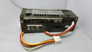

Rev. A being the Sega 838-13683-02?
Yes, the PCB layout is slightly different than the Rev B. the Rev A is also what came equipped inside the official Sega JAMMA Converter:
the Rev A is a lot more common and quite a bit cheaper but I've never noticed any functional differences between them.
