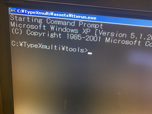

For some reason, when I get to the game select menu, I choose the game then press the Player 1 LK button and it takes me to the command prompt. Prior to this, the game would load. I have since loaded the version 2.0 image and the instructions are completely different but my controls no longer work, not even the directional controls from Player 1.

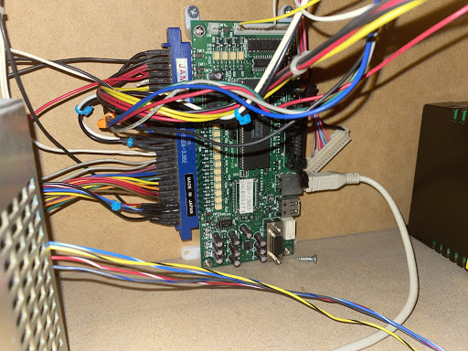

How do you connect your joystics to the JAMMA edge on the 838-13683-93 JVS IO ?
This probably doesn't help much. I will probably have to tear out the JVS and trace the wires properly to get better pictures.
Which ground on the JVS I/O should be used for the switches/buttons?
It's a little hard to take a pic of the wires as they are inside the cab but here are some images:
JVS I/O:

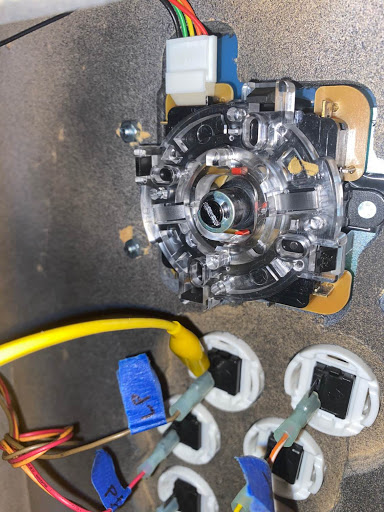

SANWA Joystick and PIN22 (LP). Ground is on Pin 28
I don't have the other buttons wired yet but I can't get to the System menu until I can get a game to load.
Command Prompt when selecting SF4 Import on version 1.4. (Version 2.0 does not let me select using PIN22.
Thanks for the pictures.

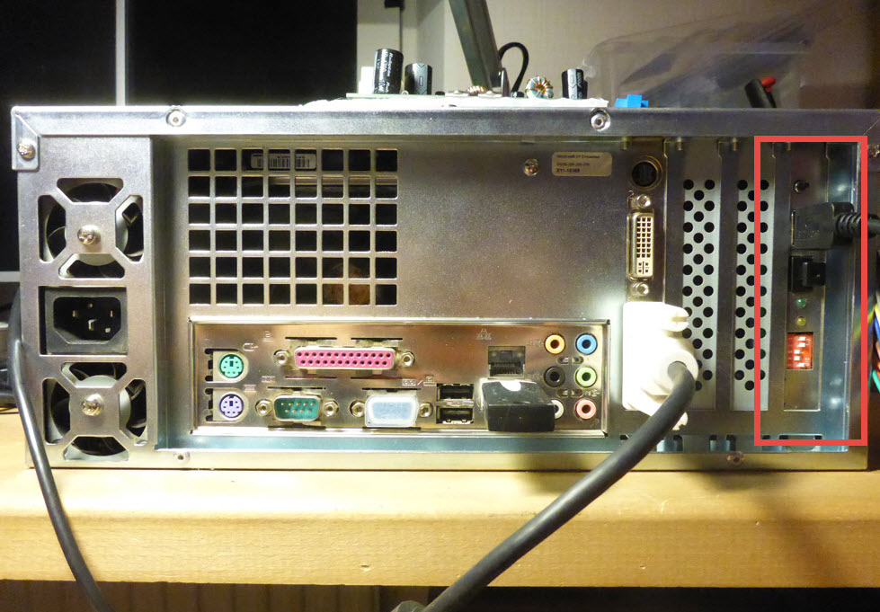

What kind of X2 do you have ? Do you have a FAST IO card in it ?
Model215A. I'm not sure it's a FastIO card but its the JVS that comes with my console. (Circled in red, this is just a sample image but similar to mine)
Model215A. I'm not sure it's a FastIO card but its the JVS that comes with my console. (Circled in red, this is just a sample image but similar to mine)TTX2.jpg

I don't see any Fast io there. You don't have it.
Fast io should be next to what you have circled in red, it should be an Ethernet port. Fast io is a PCI Express card, unlike TX3 one.
