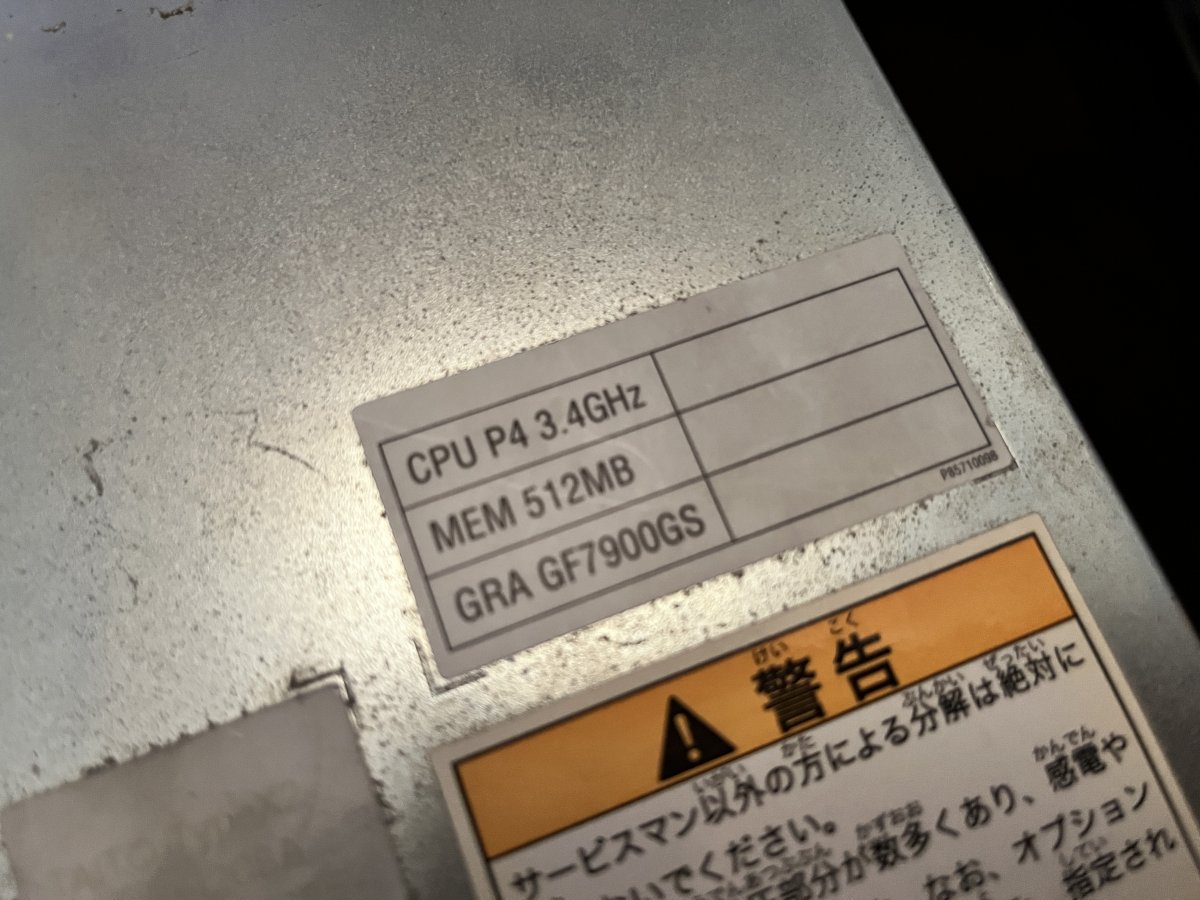

Out of curiosity, do you know which model number of Type X2 these are? It should be printed on one of the stickers just to the right of where the HDD plate mounts.
Resolution wouldn't be an issue here. All of these games run at 480p (worst case letterboxed on 4:3 displays) or 720p. My guess is either the image wasn't written correctly, someone altered the configuration, or you need to try another USB cable. I hate to be annoying about the cable, but I've read in the past about people having random JVS errors and it is because they were using a bunk cable.

Original stickers are:
The motherboard was replaced because it would boot cycle continuously. thats now fixed. The rev of the motherboard is an earlier one now. rev00b instead of rev01b. not sure if that makes any difference
There's 2gb ram in it now to. And i've tried various other configs above 512mb to

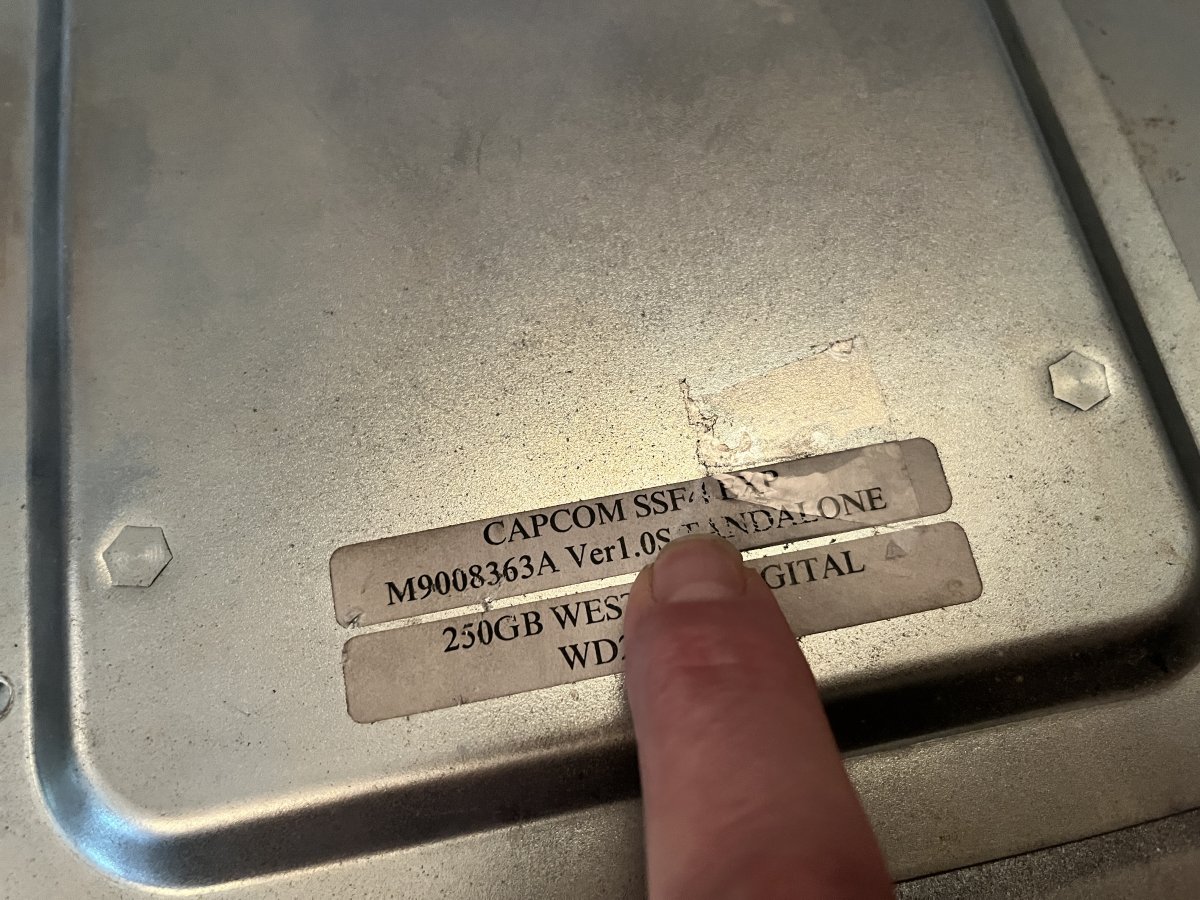

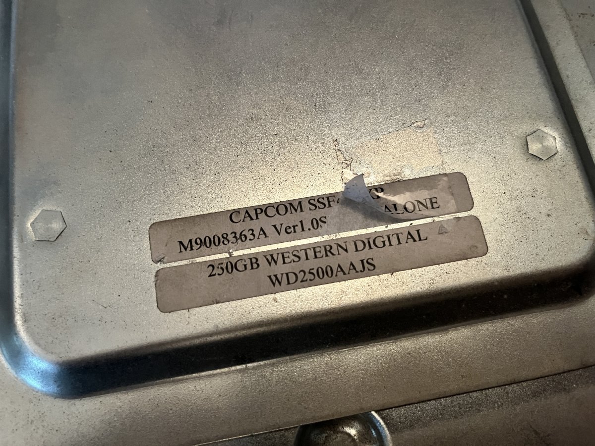

@mypinballs graciously supplied me with an image of his disk with
CAPCOM SSF4 EXP, Ver.1.0 (STANDALONE) so I could take a look.
While writing a launcher for it I came across something interesting.
This is the only SSF4 we have which is standalone i.e. two
humans can play against one another on the same machine.
Even if it is marked as EXP its really destined for :
South East Asia countries, the Oceanian countries and South Korea only.
Why don't we have a European or USA version dumped ?
Also why don't we have a standalone version for the original SF4 ?
The version we have is destined for:
Republic of Korea, ROC, Republic of the Phillipines, Australia, New Zealand and Singapore
This is also a non standalone version.
The other Ver.1.0 (NESYS) and Ver.1.3 (NESYS) both require a master/slave
network setup in order for two humans to play against one another.

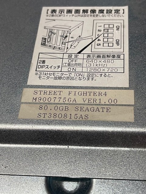

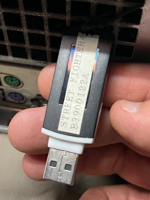

Please can you all check your archives and disks to see if we have any undumped versions ?
does this help? I can't seem to find the !@# HD so I'm hoping you tell me "no we have these thank you" ?
