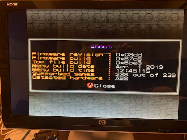

I had a picture of the version of both the firmware and the menu I was using
