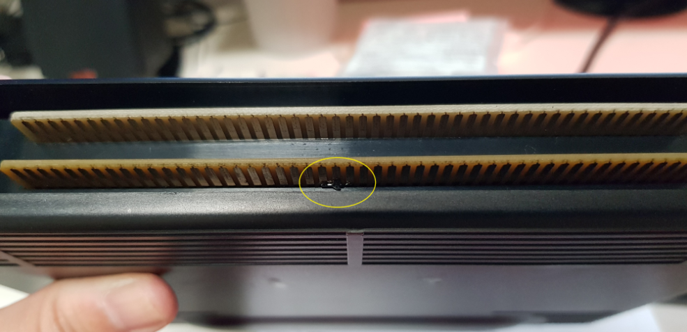

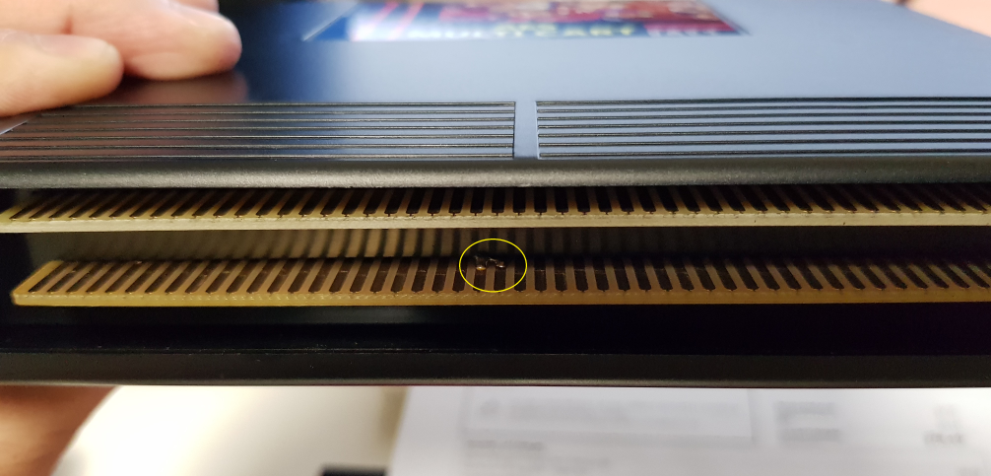

Is it normal to have the soldering sticking out on the below connectors?
I NEED HELP!
That's a fix needed for it to work on the NEO-AES motherboards.

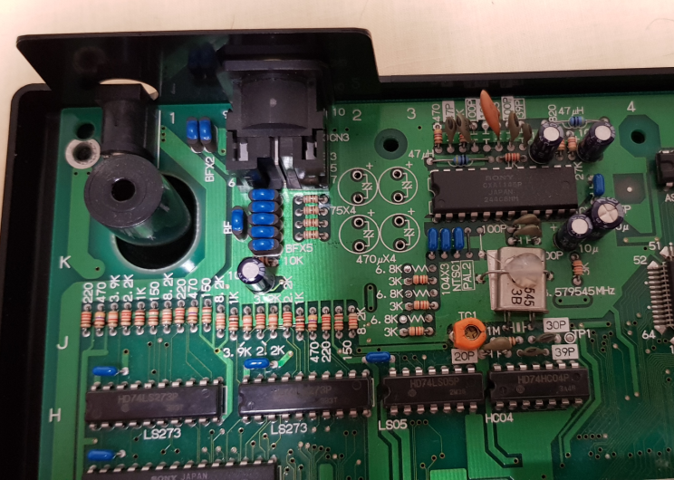

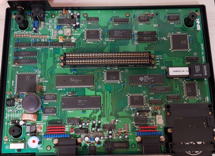

@FirebrandX
I turn my machine on with the cart the screen is white..
And here you go... the pic of my machine..
Okay so a couple things:
1. You have an internally regulated power circuit, so you'll want to use a 9V 2A PSU at a minimum (I list 9V 2.5A in my guide from Triad).
2. Your encoder output caps are missing, which indicates a DAC ladder RGB bypass. I'd inspect the underside of the board up there near the video output to see if resistors and wires are installed. If they are, take a photo so I can inspect the work. Shrink-tubing is advised for that job, unless the person doing the mod replaced the stock resistors with 143 Ohms.
3. I still need to know what color screen you get with NO cart in the machine.

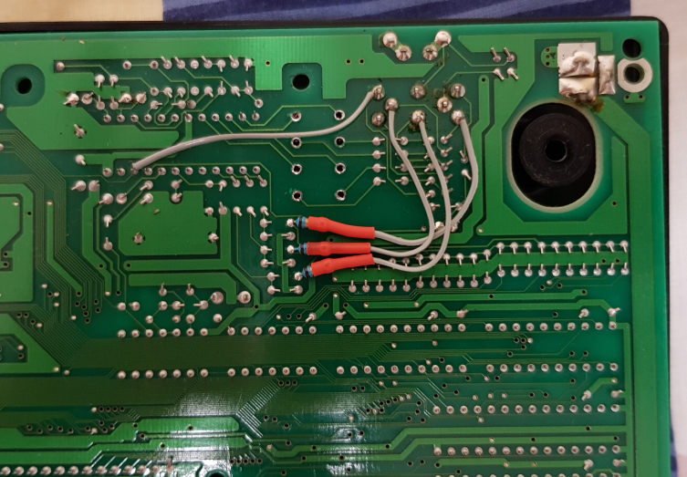

Okay if you're getting white screen with no cart, that's not good. At any rate, the area I'm referring to is the upper left of the board where you plug in the RGB cable. Unscrew the board from the bottom shell, flip the board over and take a photo of that area. You should see some bodge wires somebody installed there. I want to have a look at the work.
We may also want to try putting the original BIOS chip back in the socket in case somehow your UNIBIOS fried.

@FirebrandX
There you go..
