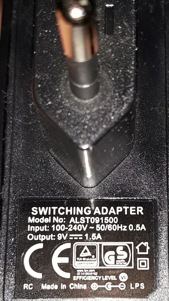

Btw how many amps is delivering your PSU??
See mine attached.
Same as yours, 1.5a.
