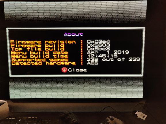

The about section photo is attached below.

It's clear. Thanks for info. We'll have a look at it as soon as we can.

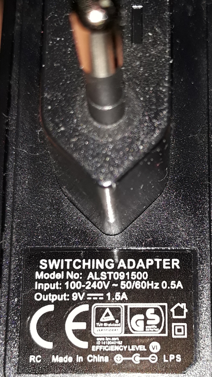

I got a 5V 3A plug but nothing happens when I turn on the Console. I have read something about changing the polarity? Do I need to cut the cable and wire it with the cable switched?
Or can I use a Mega Drive1 UK power adapter ?
The power adapter I use with my AES is rated 5v 1.5A DC and 9V 1.0A AC
No it says PRO-POW, yeah I'll not go plugging stuff in
Just don't know why the 5V 3A power supply does not work!
most probably you're using a psu which doesn't have the polarity inversed. In neogeo the minus aka GND aka black cable goes inside. See picture attached of my PSU.
