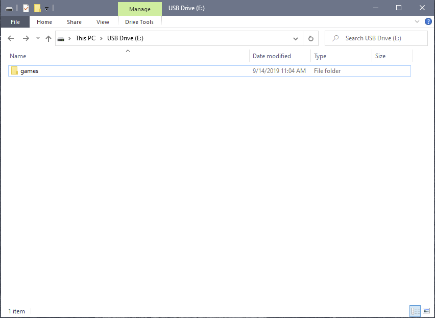

I followed this exactly and it is saying 'error no games found' when I boot it up.Here's step-by-step instructions for a Windows computer:
1) Download the application "guiformat" from here:
http://www.ridgecrop.demon.co.uk/guiformat.exe
2) Connect the SD card to your computer.
3) Run the guiformat application. Choose the drive letter for the SD card, set the Allocation Unit Size as large as it will go, and click Start to reformat the card.
4) Download the latest Darksoft Neo Geo pack from here:
https://archive.org/download/everdrivepack
5) Make a folder named "games" on the SD card, then extract the contents of the game pack into the "games" folder.
6) Remove the SD card from your computer, plug it into the cart, and power up. You should now have a populated games list.
The root of your SD card should look like this:

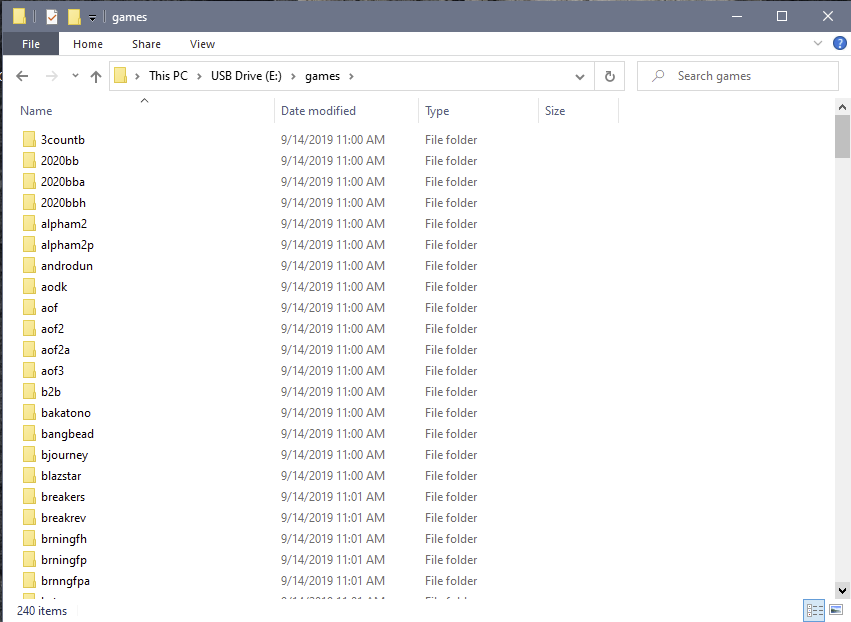

And when you open the "games" folder it should look like this:
