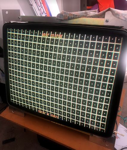

Here is the result with just swapping the yoke and not trying purity, convergence, pin, ect yet.
I am not familar enough with the 2931 to go much further, but even though the tube is an Orion (yuck), it does seem to work.
I have similar results with my yoke swap on Ms2931, i could never get rid of the top and bottom bows no matter how much I tweaked the yoke position
I have the same problem on one of my 2930s. No matter what I do, I still have the bows. I think it’s just these semi curved tubes.
The bowing can be fixed with magnets placed on the yoke.
The one in @djcalles pic doesn't even look that bad. I would be perfectly happy with geometry that looked like that.

It's way worse in real life, I'm living with it but would like to make it better if possible. never heard of the magnet on the yoke trick, I used magnets on the tube to fine tune purity though.
