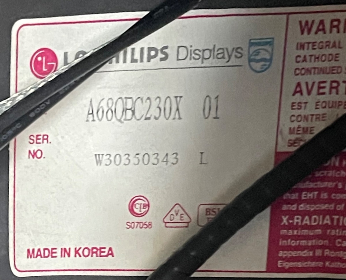

Compatible tubes based on curvature: LG-Philips A68QBC230X

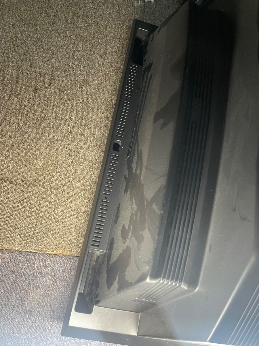

Well well … just moving it with the handles i though “what a nice case… i am keeping it”
After opening it, surprise surprise!
:) i guess it wont go in guitarfreaks to run guitar hero after all! 😝

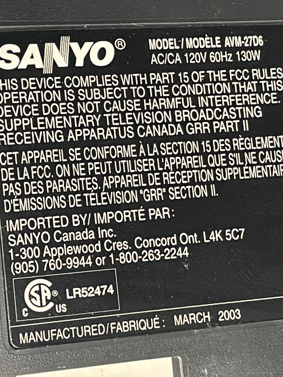

For info, the model#

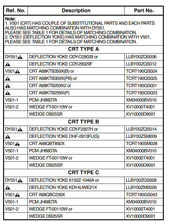

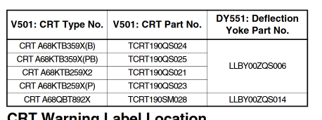

Service manual says it's either the Samsung QBT series or Orion KTB series
Nice I never thought to search for a service manual. All I looked at was the regular manual. Thank you. Don’t suppose you know if both would work? Guy wants 125 and it’s a 3 hour drive. Says it was his grandparents and it was put in storage after they died and they only had it for a year. I just looked at service manual and the way I read it yoke is not bonded
I have used the Orion with the MS2930 yoke. It works but the tube is not as nice as the samsung. IMO I would pay like $50 for it not $125
