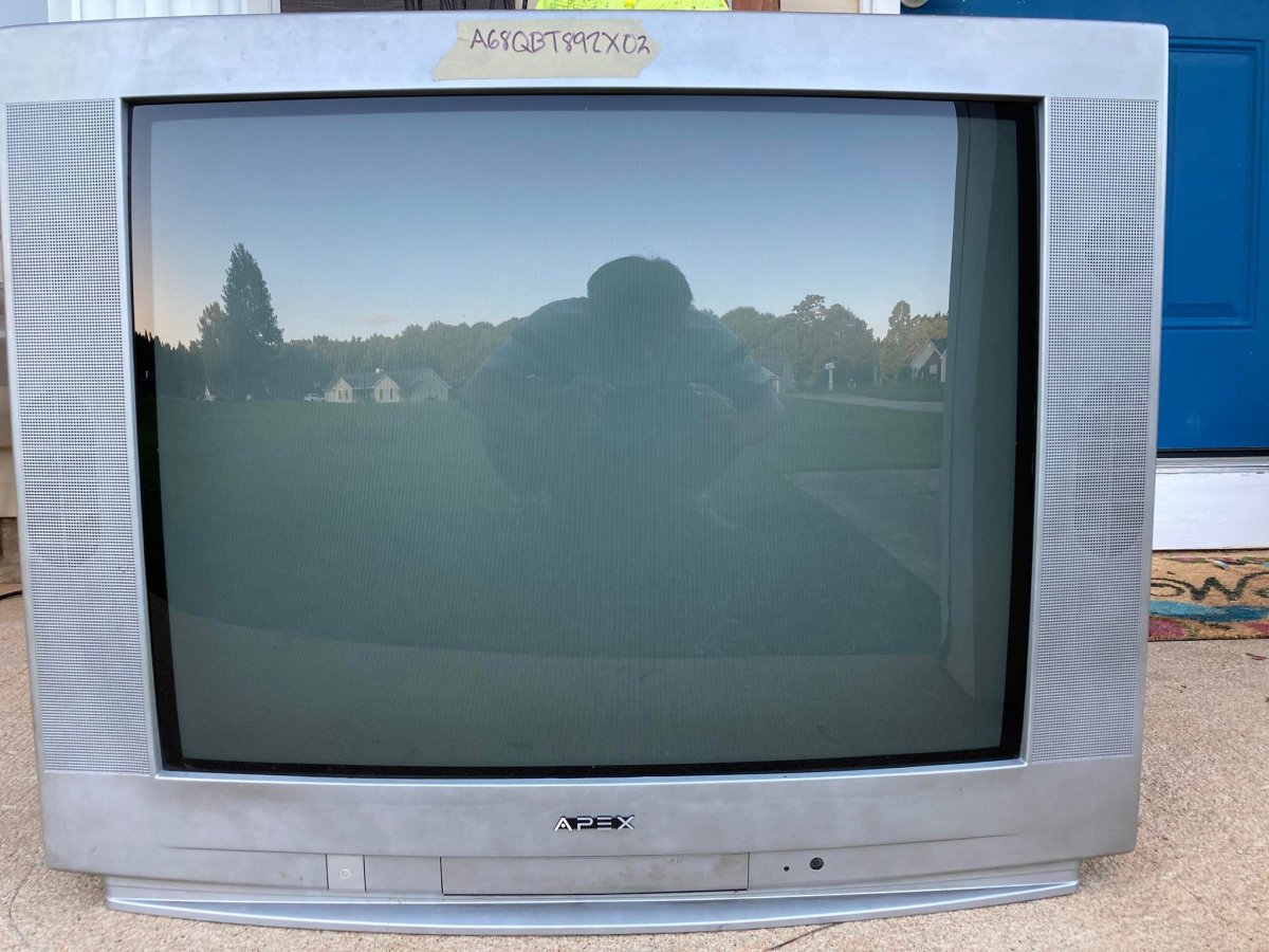

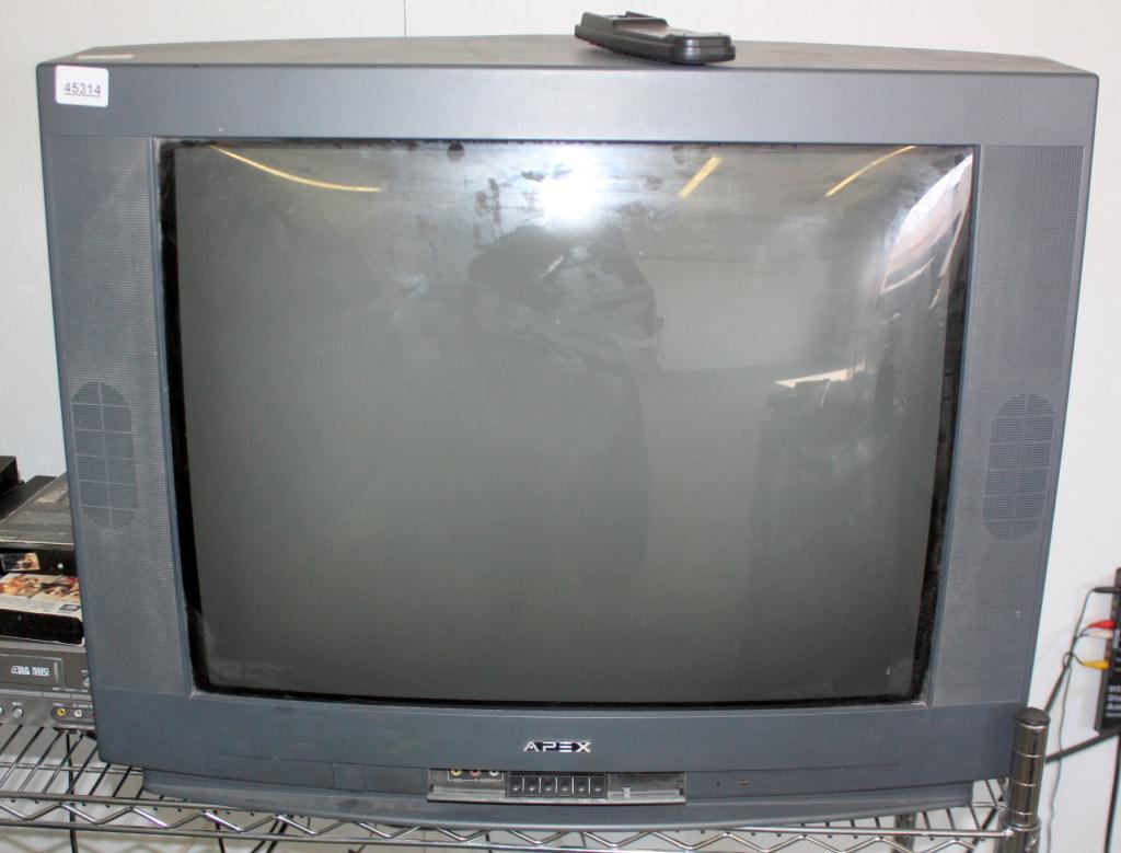

Apex AT-2702 and AT-2708: (There is also a dark gray version of this model with the same tube.)

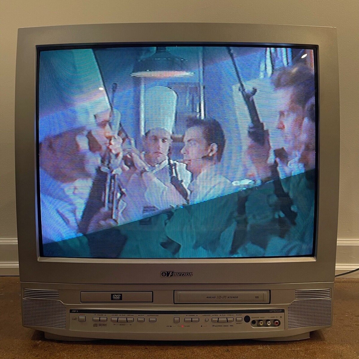

Hey, guys. So I've done some research into this subject, and I've discovered that a lot of Funai-rebranded TVs contained similar tubes that would be suitable donors for the later bezel design curvature found inside the Blast City, Net City, and Windy II.
Apex: (There is also a dark gray version of this model with the same tube.)
Emerson (Funai)

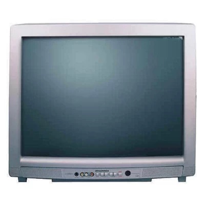

Sylvania (Funai)

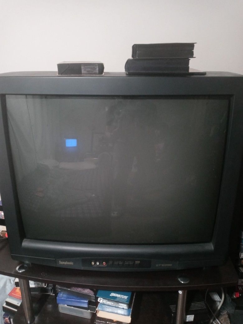

Symphonic (Funai)
Magnavox (This one made by Funai)

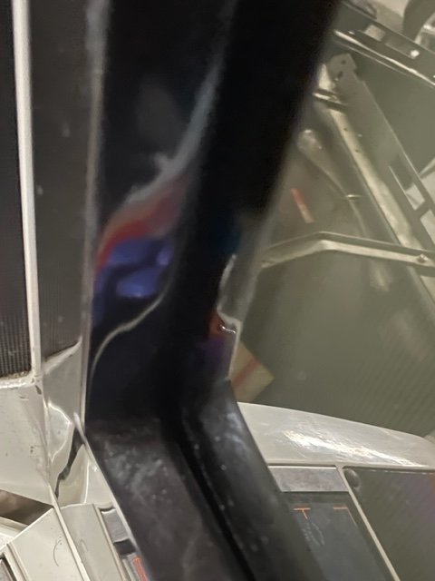

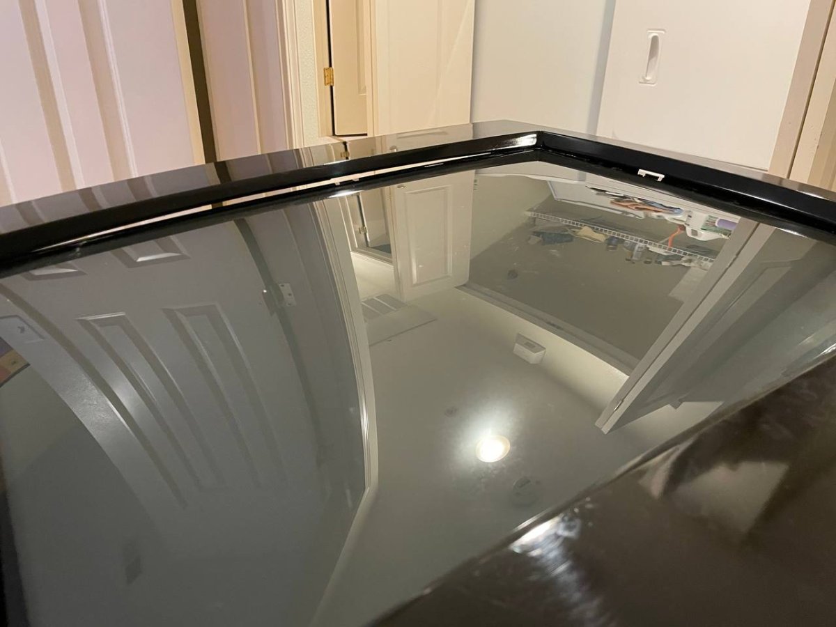

The hitachi ms9 tube found in alot of 90's racing cabs and maybe early time crisis(not sure) is a good candidate for the blast tube replacement. The pitch is a little rounder in the center but as far as gaps theyre less than 2mm depending on how many spacers you use when reverse mounting. This is mine with 2 spacers

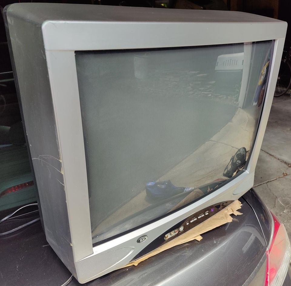

EDIT: picked up a Durabrand DWT2704B today. Everything I could find screamed Funai OEM, got it home and sadly Orion OEM. Tube Orion A68KTB359X05, curvature is about 5mm off on the corners. Damn, but at least it was free.
I ended up swapping in that Orion tube just to get the cab running again. Bezel fitment does have gaps which I used foam weather seal to fill--though it could be improved by changing out the spacers. The geometry is great and the tube has hugely better emissions than the tired old Toshiba; all in all it displays a great image, and I have no problems keeping it in the cab until I stumble across the correct replacement locally.

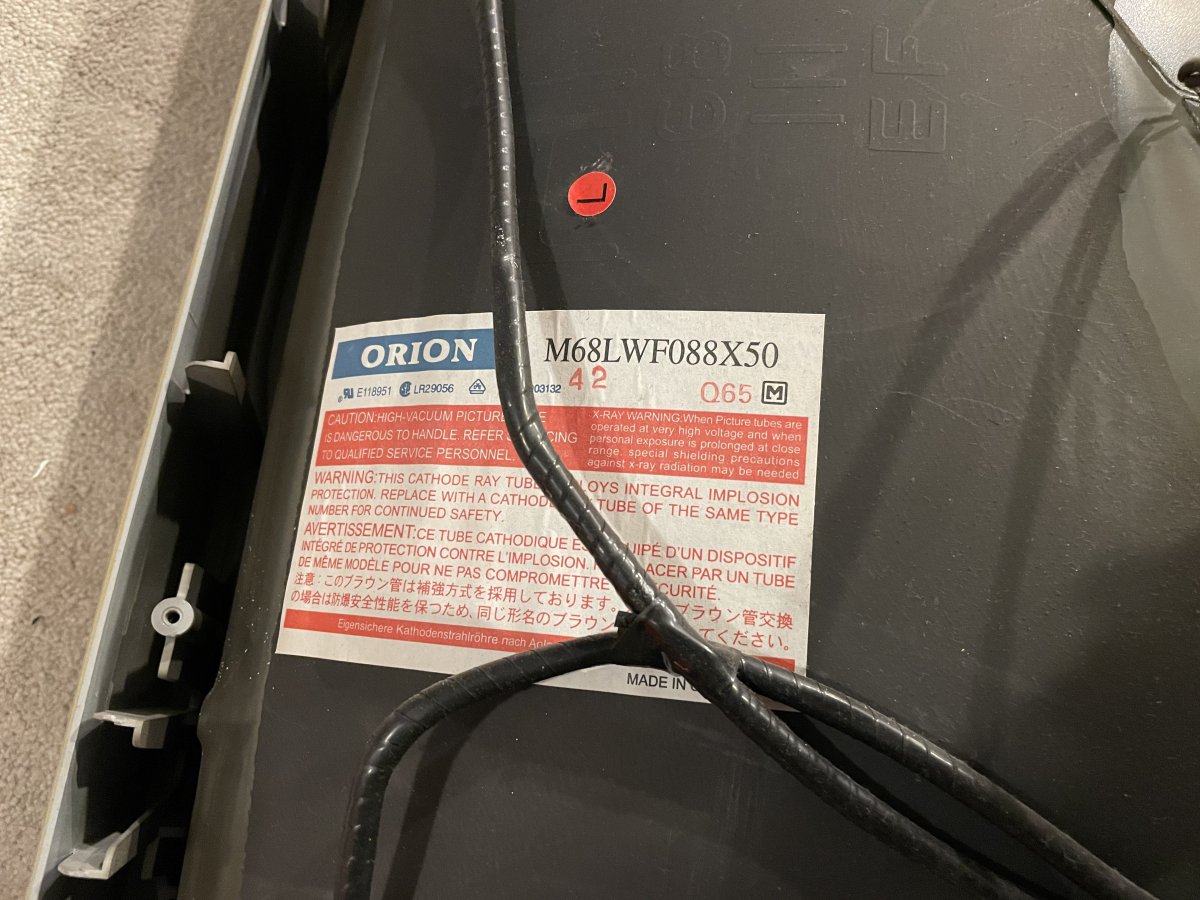

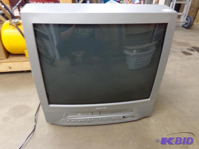

Picked up another one of these Durabrands, this time the guy told me the model was DU2701. It was free so I picked it up. When I arrived, I saw it was Orion again and disappointingly took it home. Opened it up and...
M68LWF088X50
Monitor grade, Orion branding, Panasonic tube... in a literal Wal-Mart TV
Well ok then. Unfortunately like the JVC D series someone mentioned earlier, it's too flat and has gaps in the center. However M grade is very tempting.

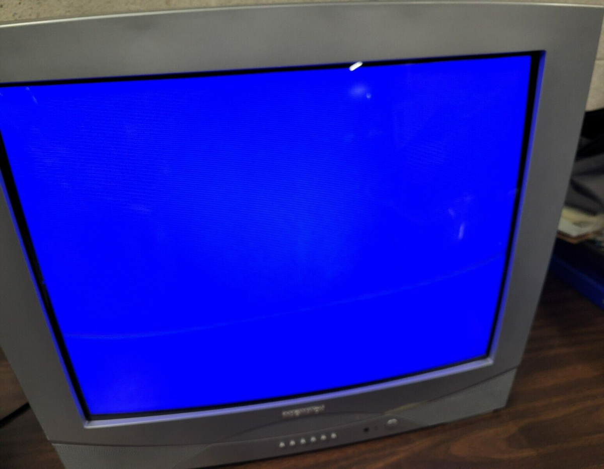

I am having a hard time finding pictures of the different durabrand monitors. I see a Durabrand listed on facebook marketplace. Did it look something like this:

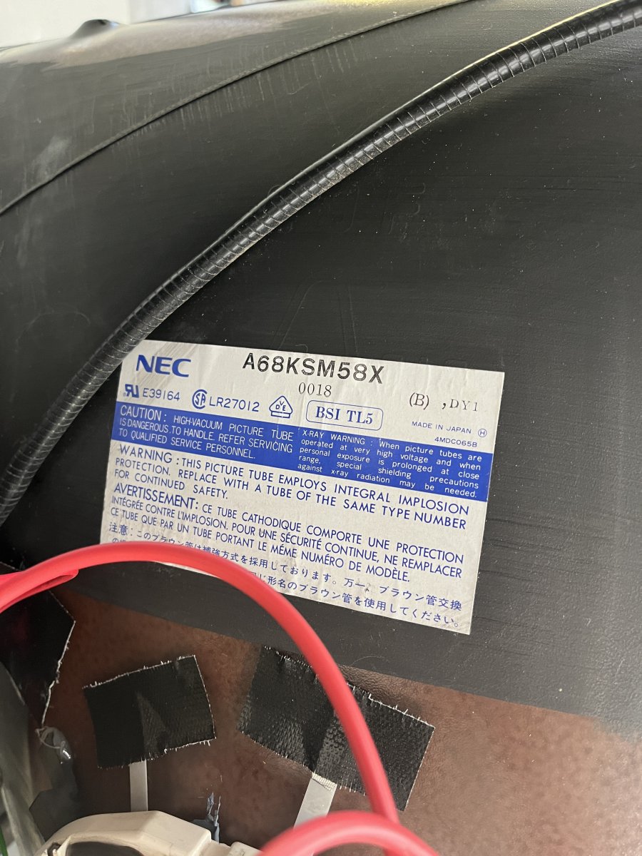

Not sure how rare these are, but some NEC tubes are a decent match
