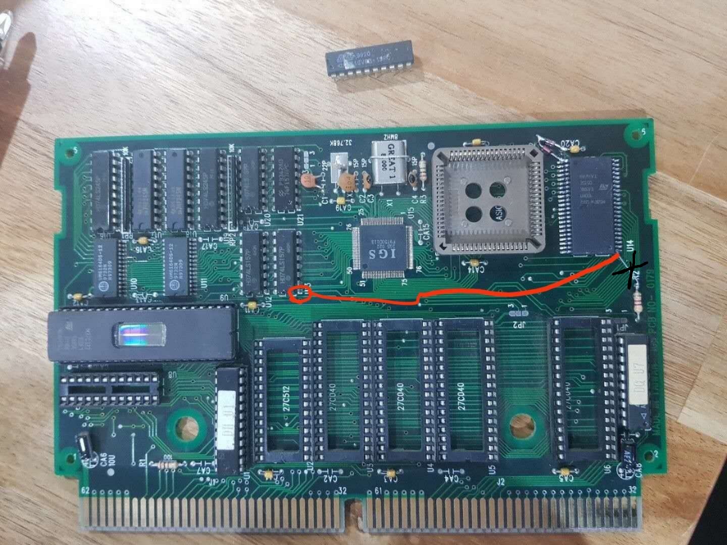

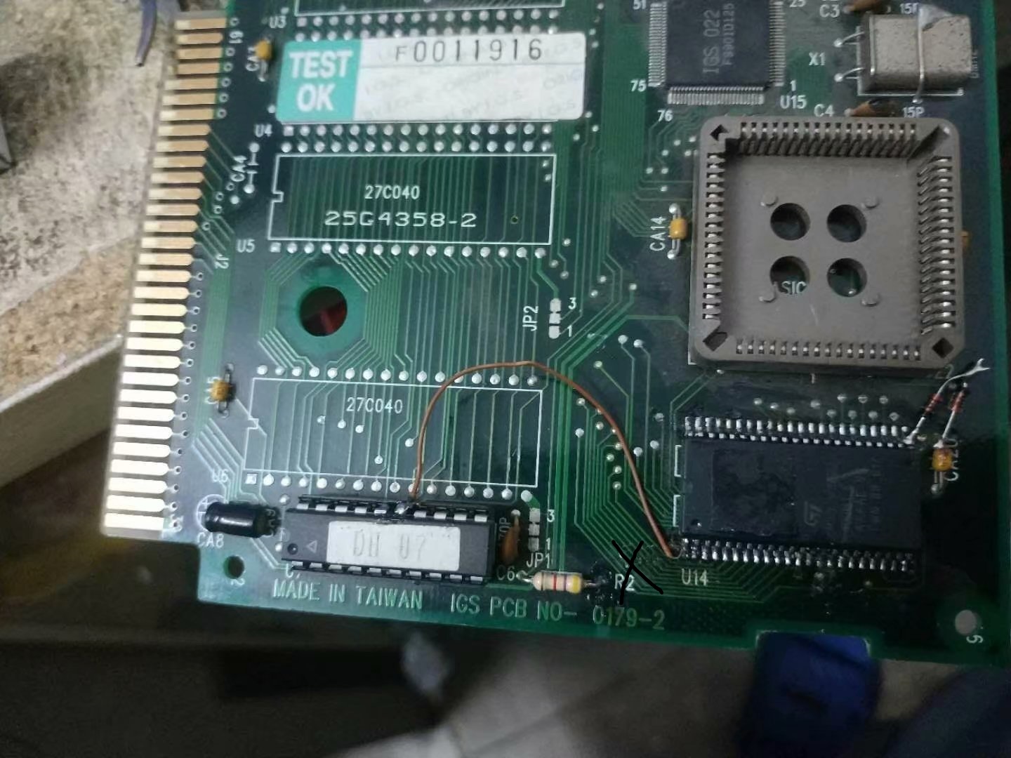

Both of the 2 pcs picture^+^,do keep the wire disconnected.(the black pencil we marked)
Picture 1,soldering like that(we mark with red pencil),and also exchange the encrypted IC.It should be able to solved.
Picture 2 ,exchange the encrypted IC,also keep the wire disconnected.
If still have some other question,pls let me know.
This is for the background tile fix you're sending out? We have to disconnect the wire (and maybe add another one)? Or is this for a different fix?
Excuse me, but what do you mean when you say “Encrypted IC”? Is that TTL chip you removed in the first picture? Did you replace it with another one placed in the socket in the top-left of the first image?
