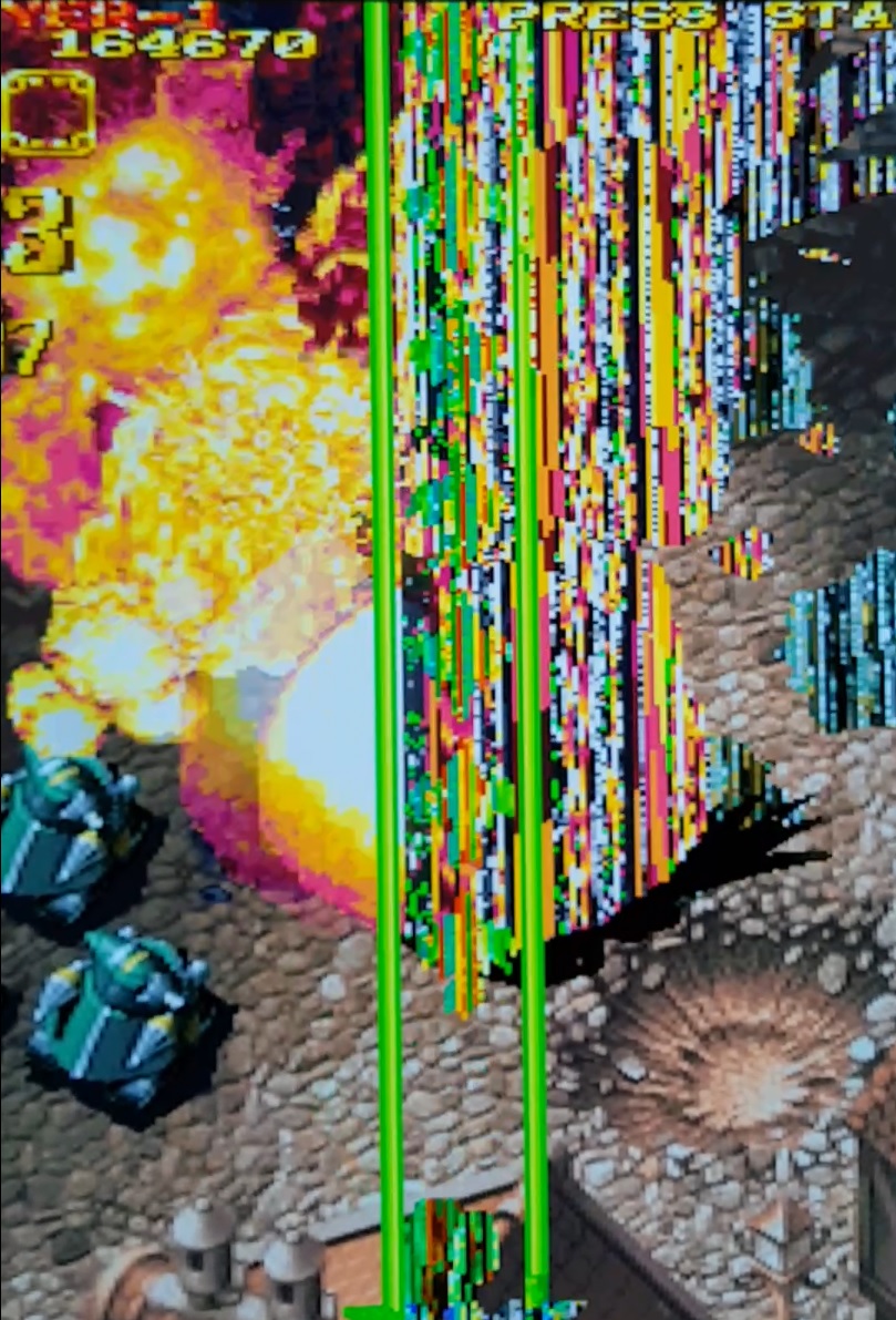

Managed to capture it on video here.
I see, that just happened for a split second there.
it looks like the Sprite color data (so one of the two roms on the top left of the GFX PCB).
Since this is intermittent and only happened during explosions (as in lots of sprite data changing) I wonder if it's related to not having a decoupling capacitor.
I've been debating simply desoldering the 5V pin on the existing decoupling caps (since they're really not being used anymore) and soldering it to the power pin on my ICs to serve this function.
If the conversions aren't using a proper voltage regulator, installing one could help as well.
The same thought actually crossed my mind. Playing the video back and stepping forward frame by frame, I noticed that the main character and the gems also glitched at the same time.
Definitely couldn't hurt to try. I'll do some testing when I have some time and report back.
Would be interesting to see if anyone can replicate the same glitch on their setup too.
Really? I find that a relief and also a massive WTF.
Very odd indeed.
Yeah man. Personally I love it. When I converted my pgm carts I was afraid that it wouldn’t have the glitching. It looks so badass
I 1ccd this game on pcb and this happens when you score lots of big gems from enemy death. So yeah youre playing well. Better than the guy in the recent cart review :)
Max sprite counter glitch :)
1:27 and onwards this player manages to do it in stage 1 with absurd gem/gold levels at that point btw.
HA damn... cave games are fun as hell with great graphics and level design but I feel like their hardware choices and design have always been pretty terrible.
Ouch, my feelings. JK, I have never been good at these shooters :)

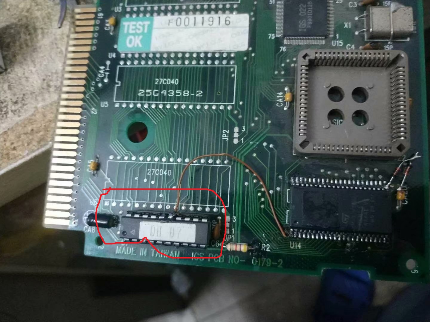

Any one who buy the espgaluda or ketsui from us.Pls check your game card,if the game card looks like the attachment's picture.(the killing blade)Pls contact us,we'll resend u another one encrypted IC to solve the problem.Of course,if the game card you bought is dodonpachi dai ou jou black version ,new c a v e pcb,or the game card is converted from kov2 nine dragons,u can pass it.^+^
Is it the "DH U7" that needs to be replaced with "DQ U7"? what problems does this cause?
PAL labels are in tact, and look original. DH U1 and DH U7. Here are the images from my boardset, I can work on pulling/dumping pals, but it'll probably be this weekend before I can devote much time to it. Also these we're just quick cell photos prior to dumping, I can get more detailed ones or trace out connections with my meter if needed.
Is that wire from smd rom to PAL marked in picture present in previous KB conversion pictures posted here?
Curious about "DH U7" PAL too... previous KB pictures have it or "DH U7-1" (like my KB carts). What's the source game from which is taken "DQ U7"?
