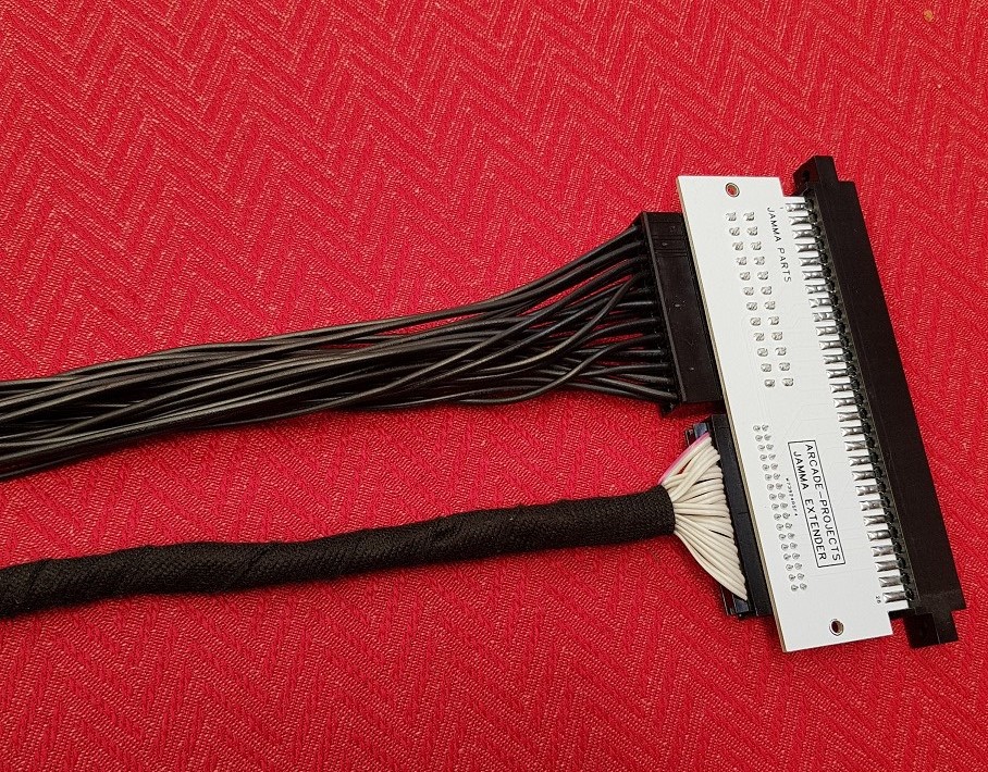

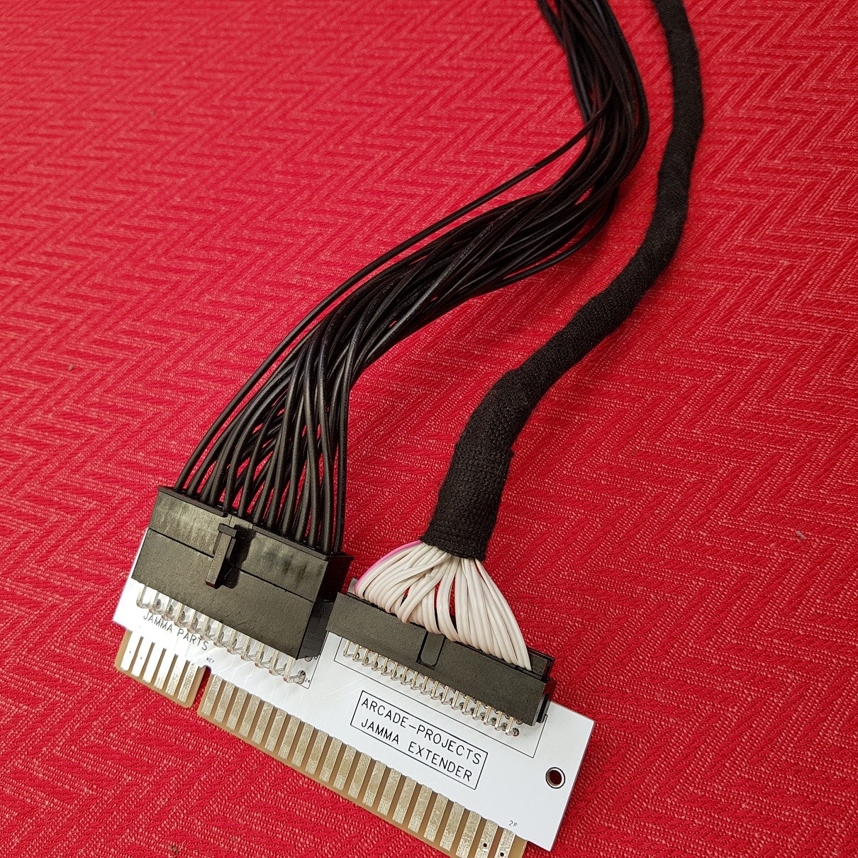

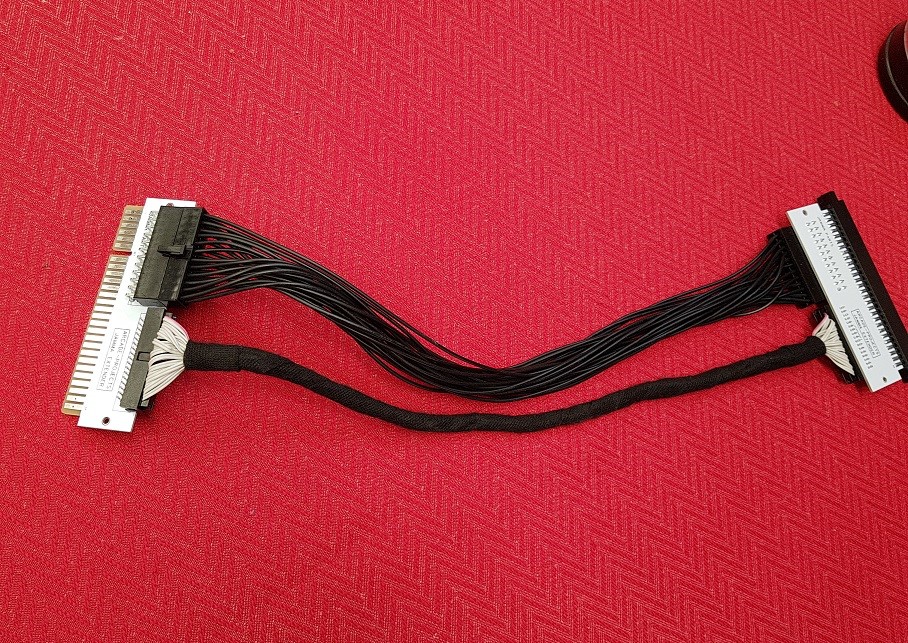

So I tried a few different options regarding the cabling of the extension.
The first thing I tried was bundling the cables together and using braided sleeving but the problem using that method was the cable was too rigid.
I ended up settling on what you see in the attached images, I cut the IDE into strips of 3 wires and wrapped it in fabric tape.
This method is quick, neat and easy and makes for a very flexible extension.
