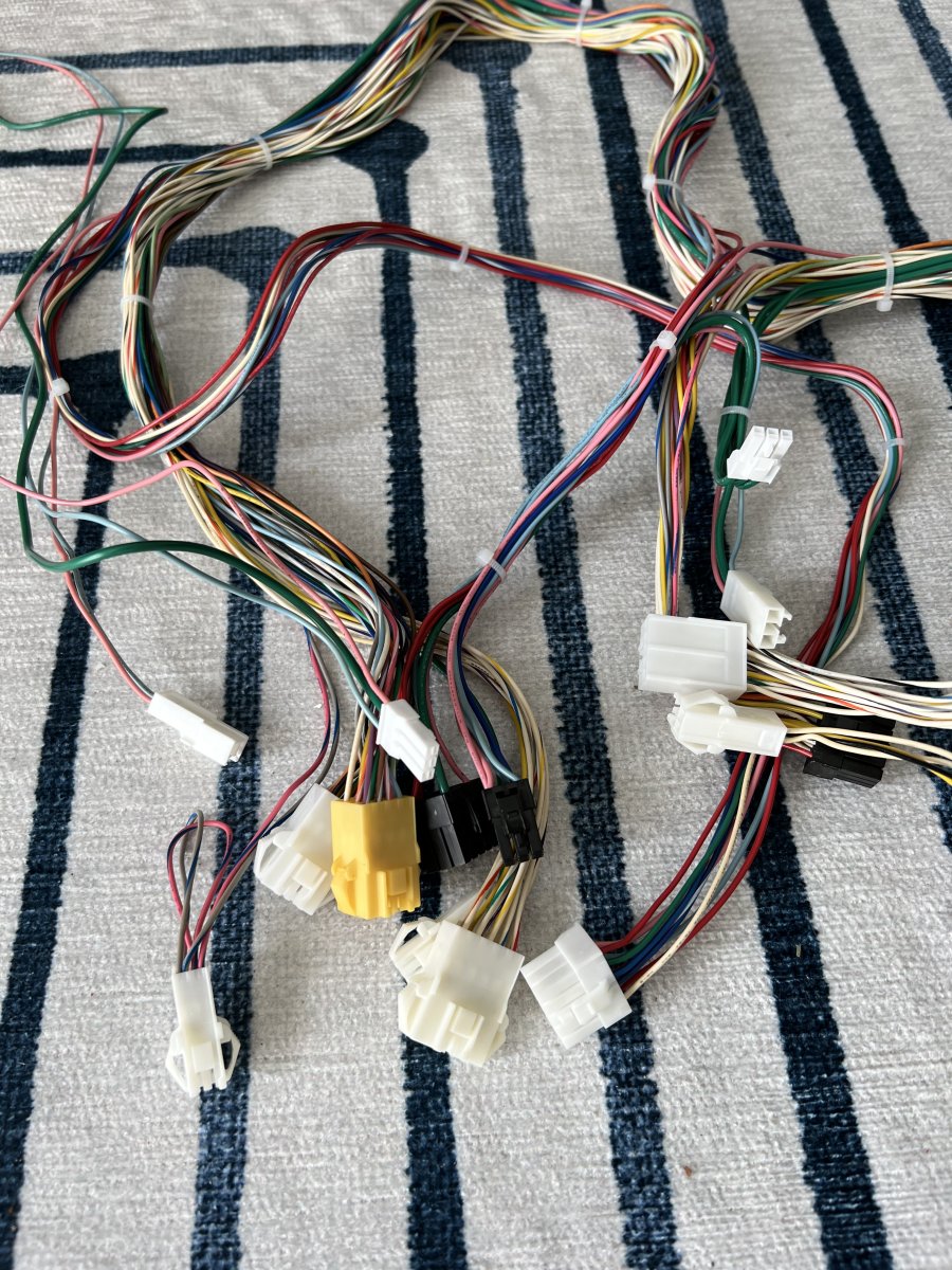

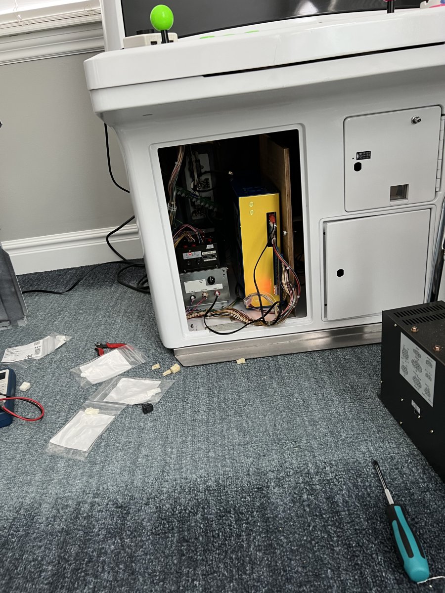

1. Got the rest of the AMP-UP connectors replaced on the harness. This thing is looking almost new at this point.
On the other Astro, I converted the harness from using the same connectors as the AC2 to using the black ones. It works!
It was a lot of depinning but other than that it was straightforward.

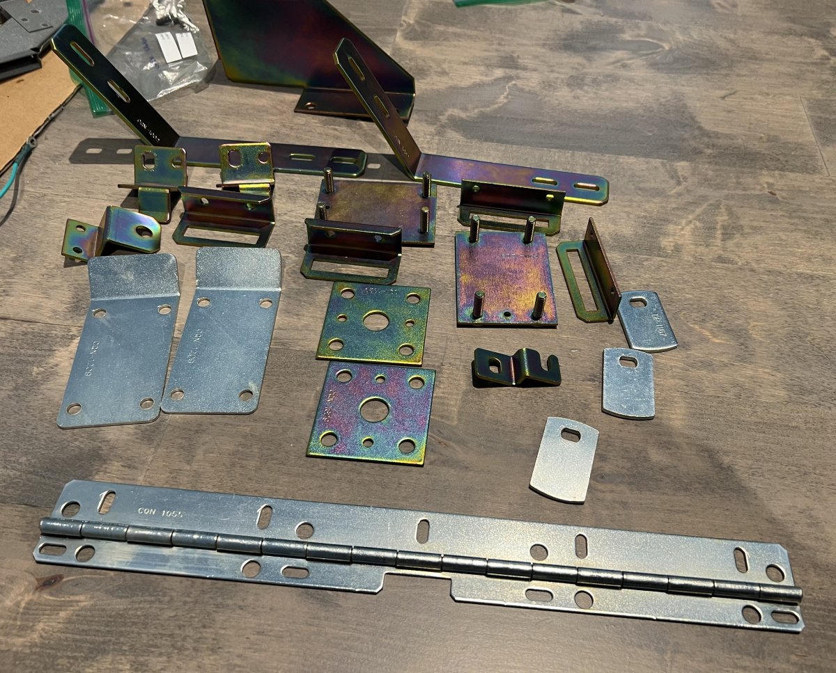

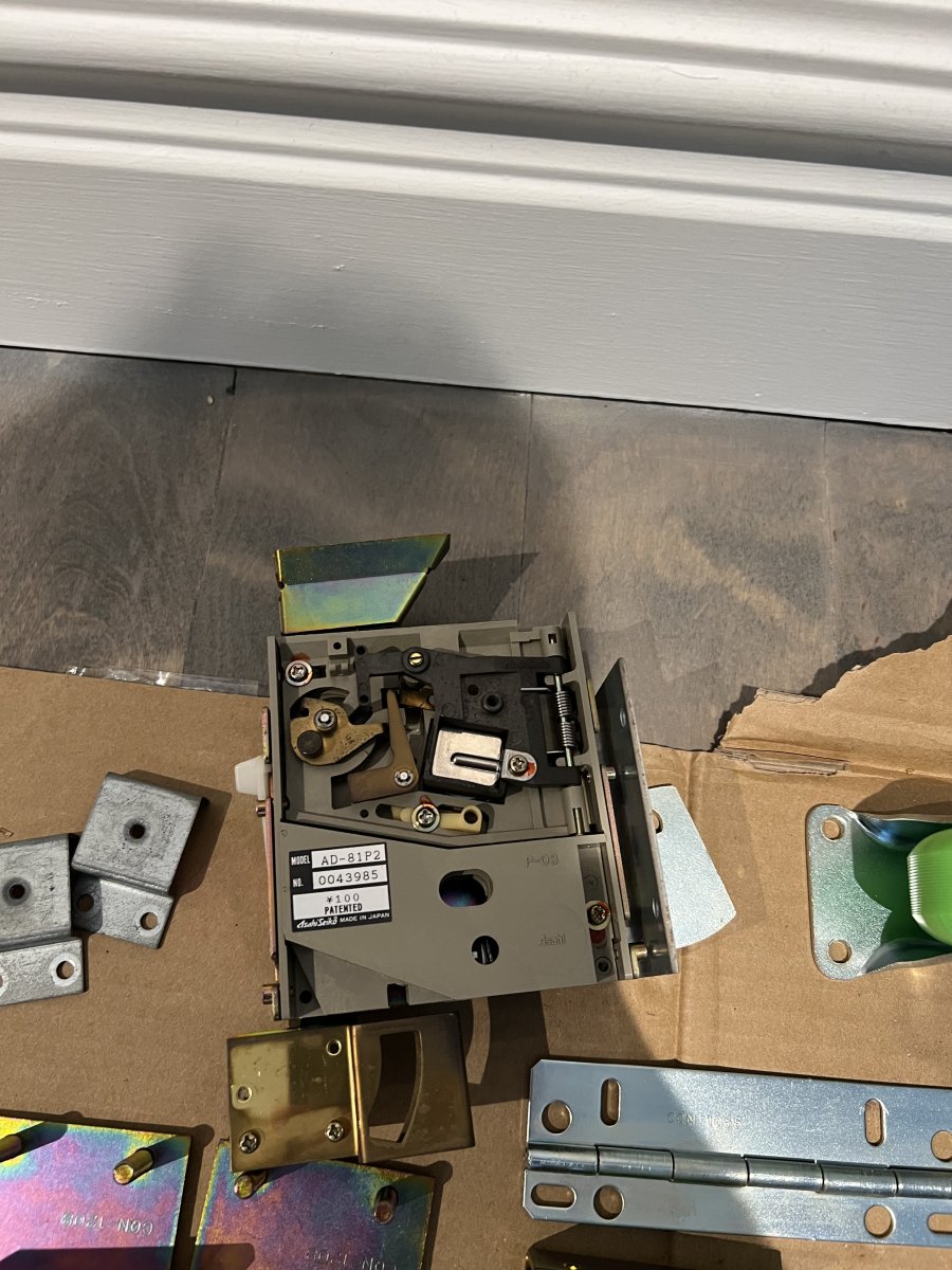

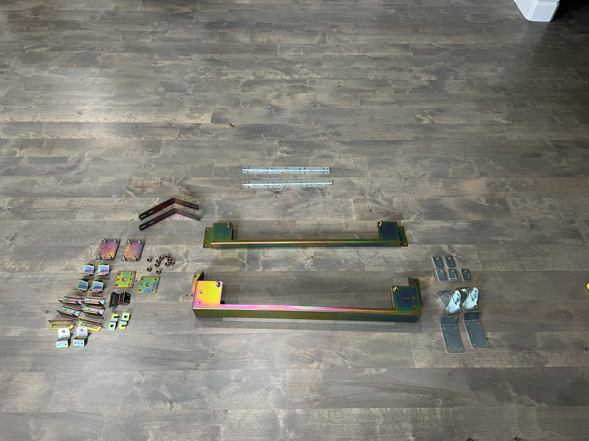

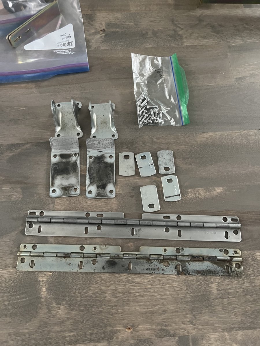

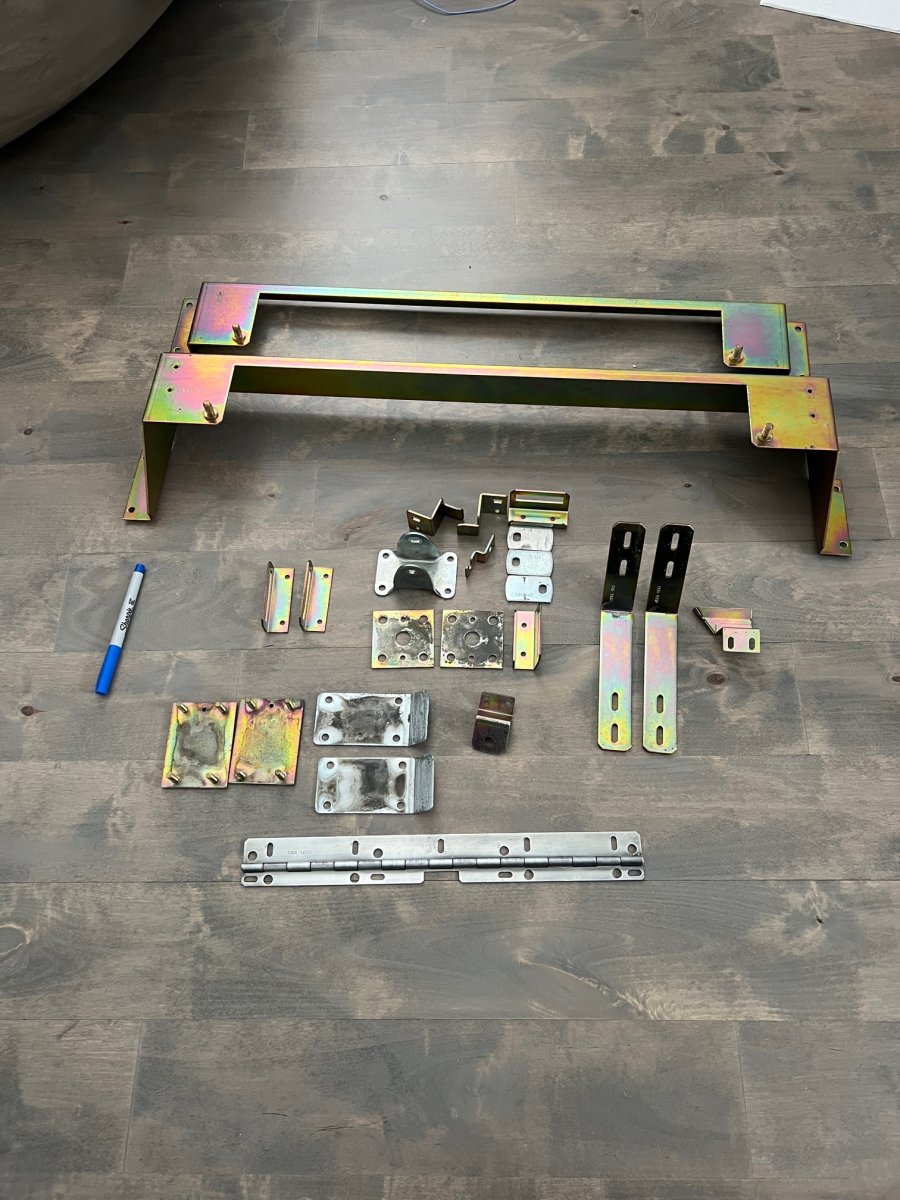

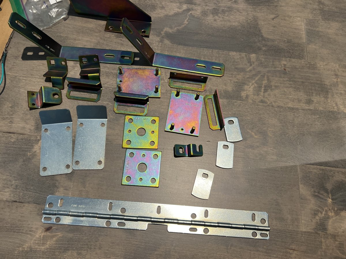

Parts have come back from the Zinc Plater! I got an email last night saying the parts were ready for pickup so I left first thing this morning to go pick them up. As we were looking over the parts the manager noticed that some of the screws didn't come out very good; so he offered to have them re-done. I was very appreciative that he took the initiative to do that instead of me having to ask. He definitely has my future business. Aside from that, everything went without a hitch! Here are some before/afters of the work. It's so nice to know that these have a fresh coat on zinc. Since I did both yellow chromate and clear chromate, the cost was about $290 after tax. Not too terrible. Had I done a single color I'd be closer to $175, but I wanted to keep them their original colors:
Before:
After:

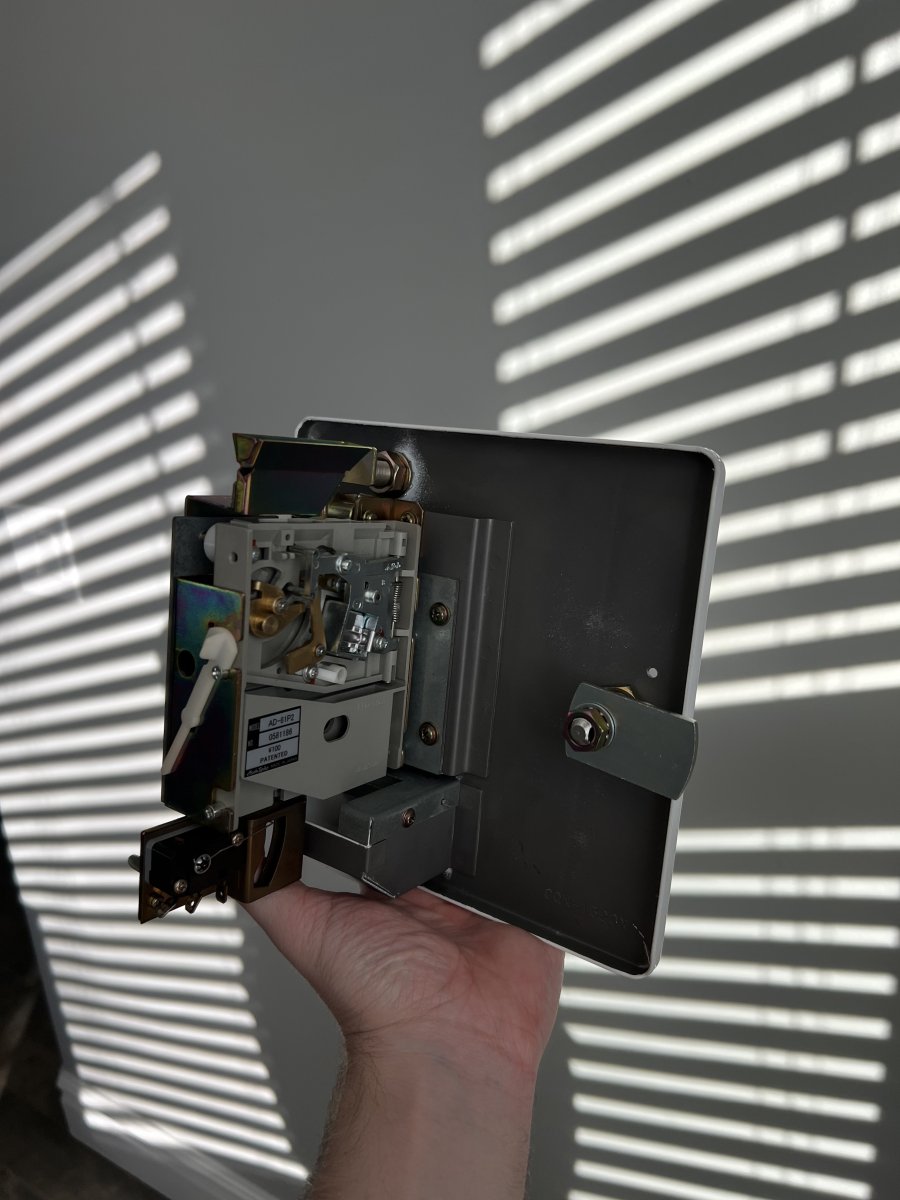

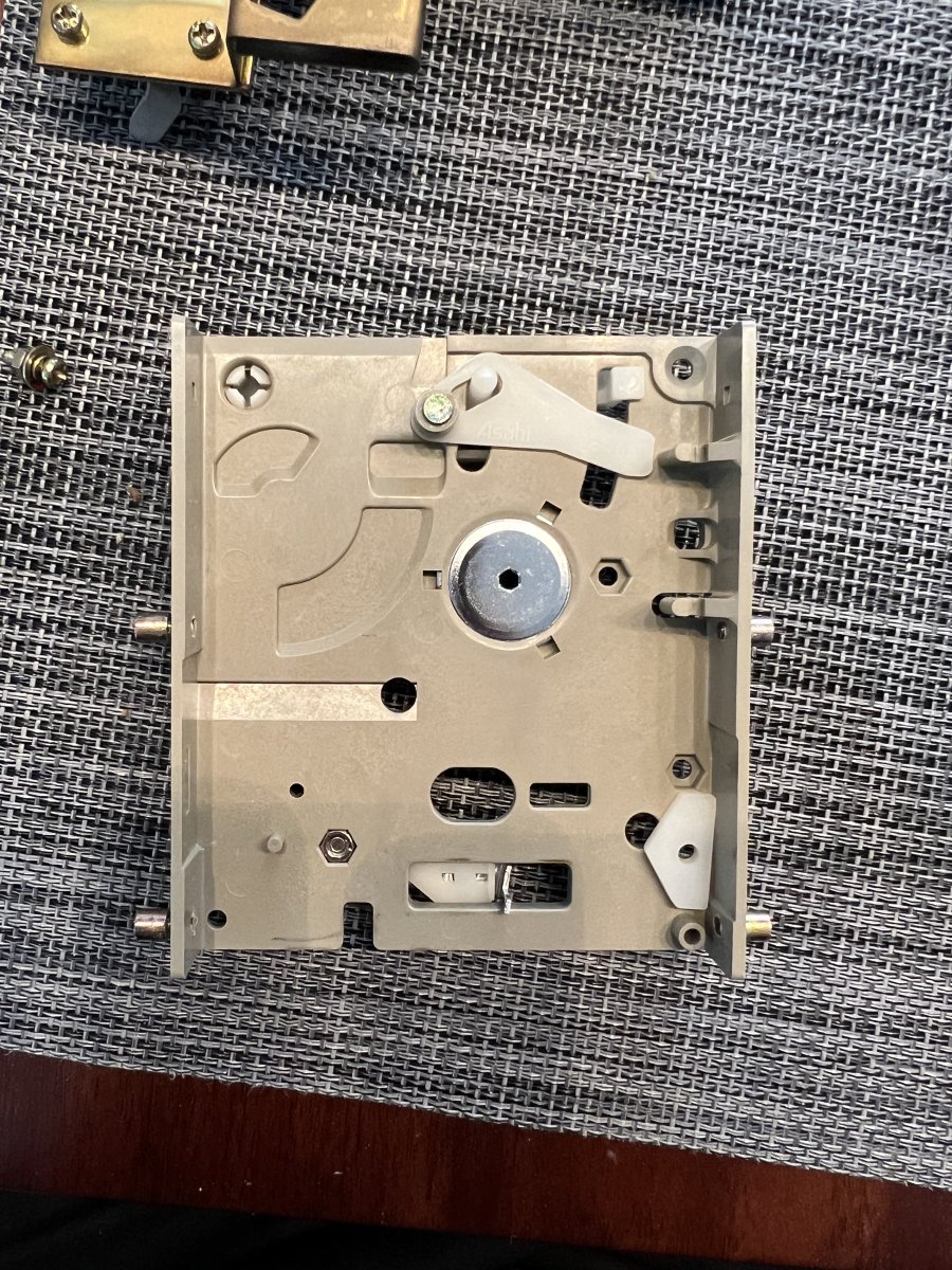

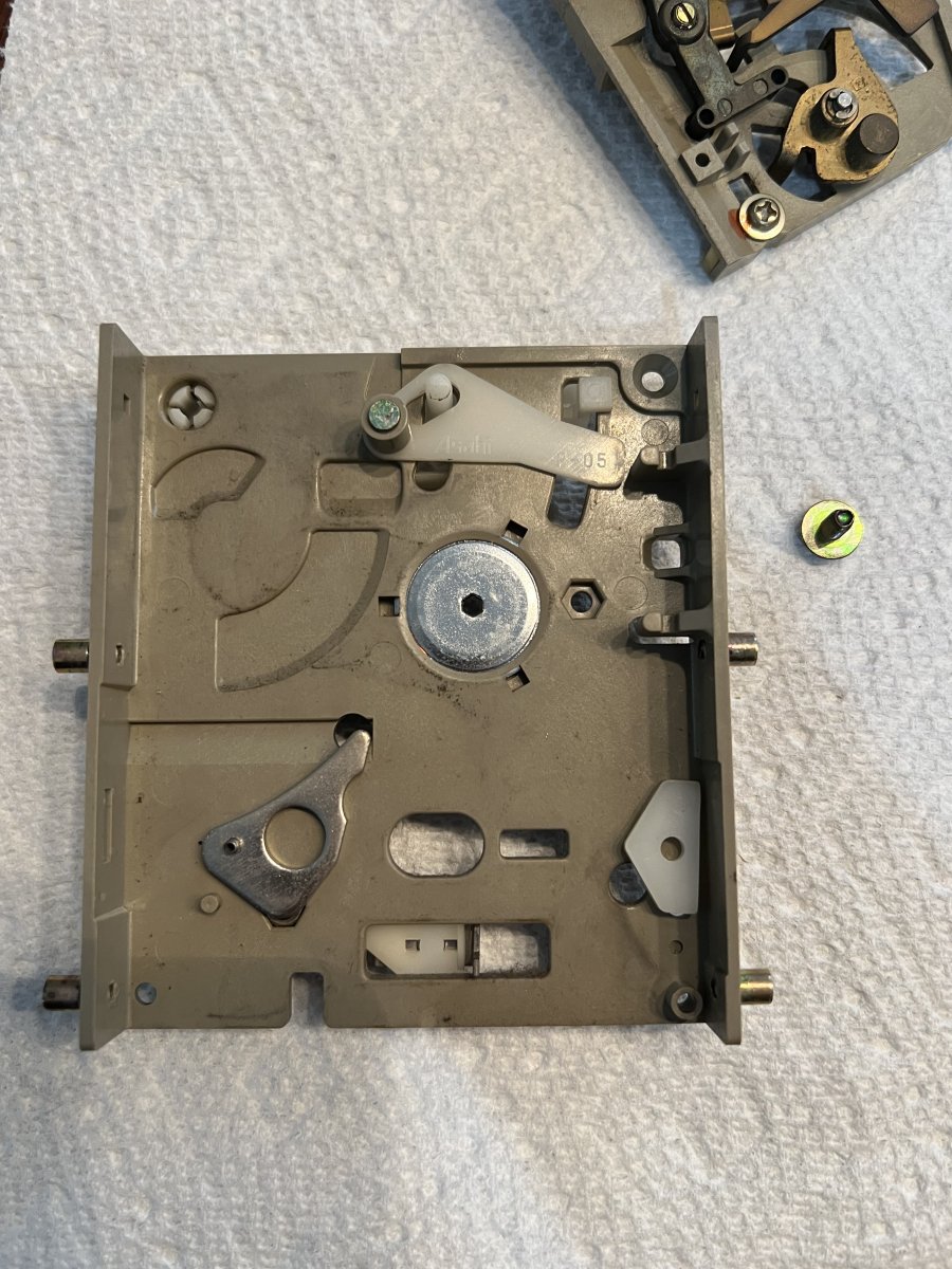

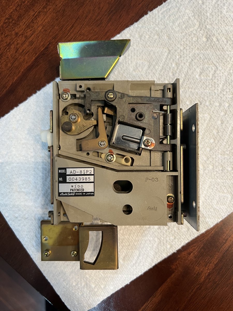

I also took apart the coin mech today to give it a clean. A little dirty but nothing too crazy.
Before:
After:
Before:
After:
Before:
After:
It looks good. But $290!?
Is that how much costs these days?
Damn.
Damn.
Yeah, seems places around here are $100 minimum and I used two colors so that’s two batches. Kind of annoying, but I got everything I need done between two cabs so at least it’s “one and done”

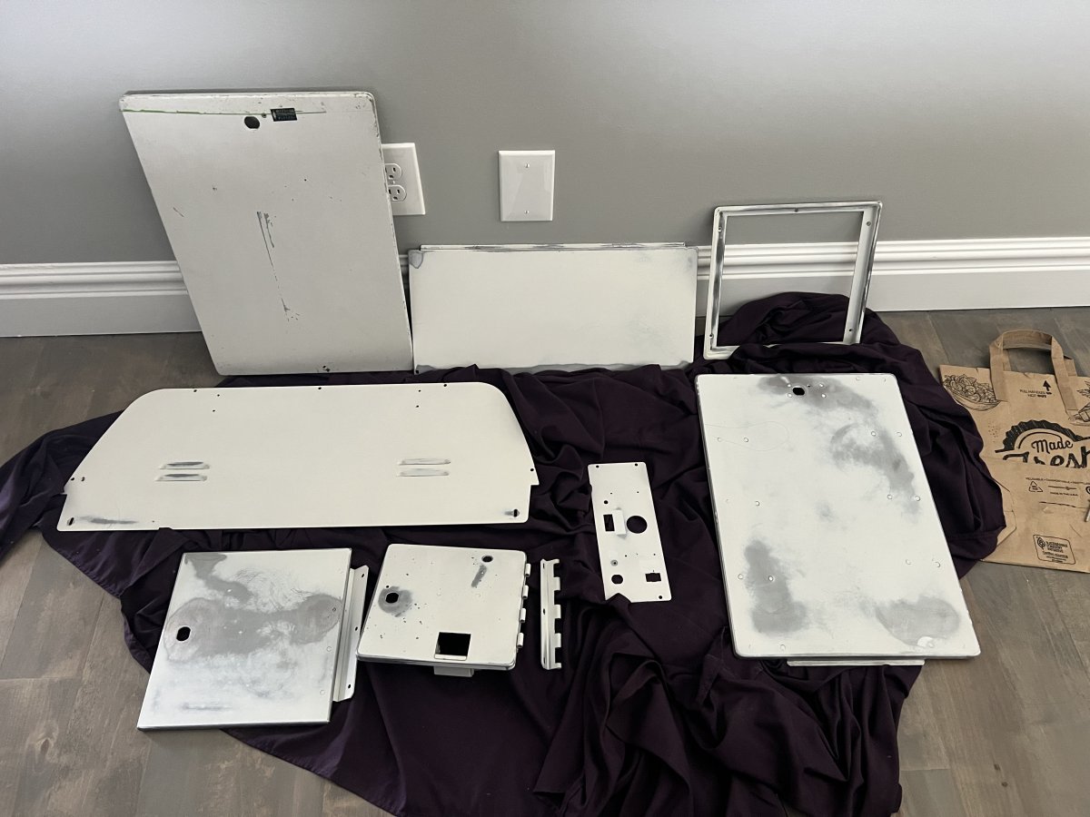

Today I reached out to one more powder coating place. I think the best course of action right now is to go in and see how good of a match we can get on a powder coat. When it comes time for paint or gel, I can have them match the doors.

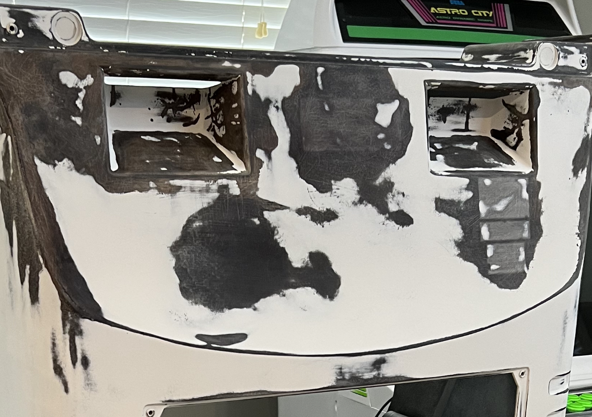

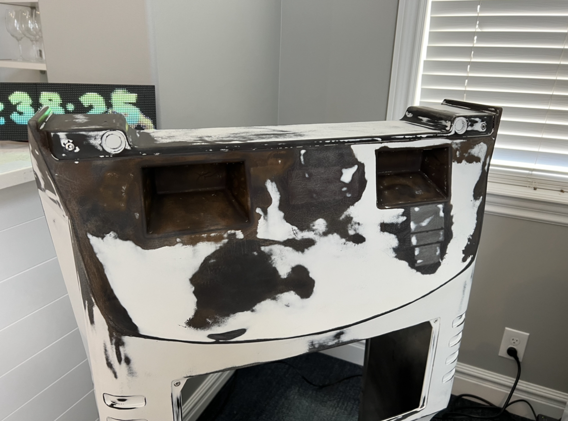

One thing that has been bothering me is on the back of the cab there are a couple places to put your hands when you wheel it around. In those areas the paint was chipping really badly and it was hard to sand in there. I basically gave up and decided to let the painters handle it — until today!
After a little searching I found that harbor freight had a cheap little soda blasting kit for $35. Pair that with some baking soda they have for $50. $90 to save me some labor was well worth the experiment.
https://www.harborfreight.com/air-t...ning/portable-abrasive-blaster-kit-37025.html
https://www.harborfreight.com/air-t...edium-grade-armex-soda-blast-media-65929.html
To my surprise, it worked quite well. My compressor is barely 1HP so I had to do a lot of waiting for more air, but it definitely beats sanding. If I ever do this again I’ll probably invest in a larger compressor and do the whole cabinet. It was so damn easy.
I’m really happy I did this so I don’t need to be worried about poor adhesion to chipping paint.

Dropped these parts off today at the powder-coating place. They will sandblast them all and put a fresh coat on there. We found a pretty good match so I'm happy about that. Cost is about $300 for the whole thing. Looking forward to seeing how these turn out. They're about 2 weeks out; but I'm hoping they're able to do it a bit quicker.
Once I got back, I soda blasted a bit more. There were a few corners on the front piece that I wanted to make sure I got the paint out of. I decided to take a little video so y'all could see what it's like. Obviously a better compressor would make this job a bit quicker; but it suits my needs for now :).
View: https://www.youtube.com/watch?v=KsF4YLi-4RM
Very satisfying to watch.

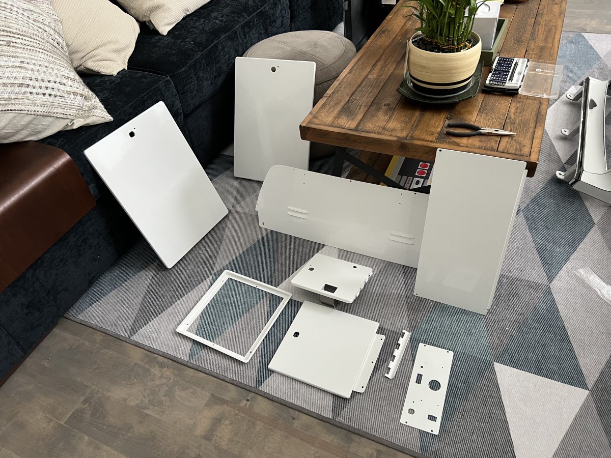

Parts came back from powder coating today! I had two doors done (I ordered and extra at one point) and then all the metal pieces. They turned out great! Only issue was that they coated both sides of the power panel. Not a huge deal, but I’ll need to make sure I sand down a spot for the grounding wires.
Really happy with how these turned out. The powder coating guy also gave me some information on a painter. I’m getting so close I can taste it! Hopefully this project can be wrapped up by the end of the month or end of may.
Alright, more pics:
I’m kind of kicking myself for not having the powder coat place do both sides. I figured it would be easier for them to not do both sides; but they actually took my instructions as hard instructions and not “hey, if there’s overspray on the back I don’t care, do whatever is easiest.” That said, they did a great job! Lol

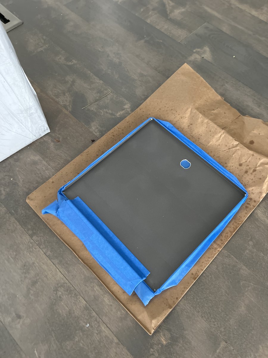

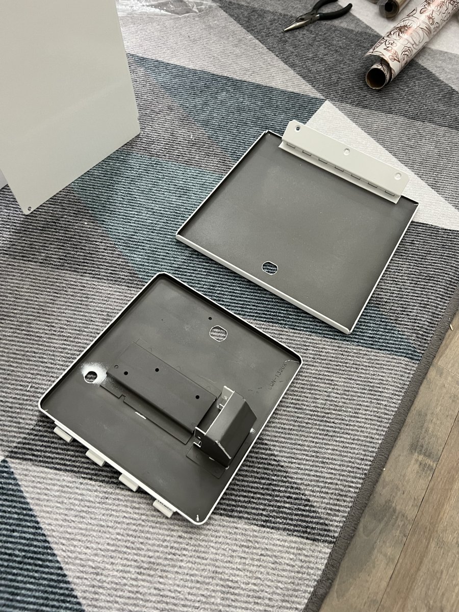

Only downside to the bare metal is it could corrode over time. Today I sprayed with some corrosion inhibitor, let it dry, and followed up with clear coat.

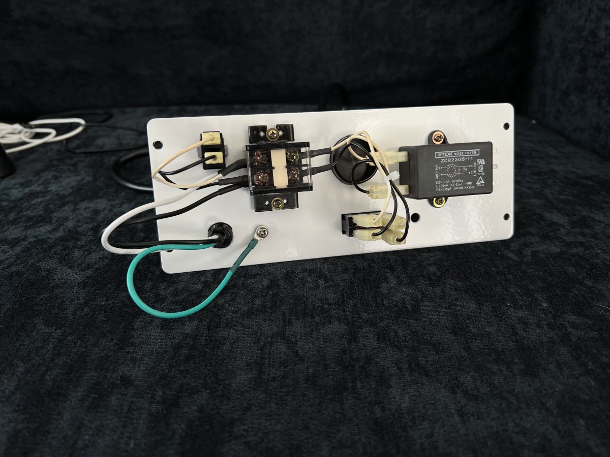

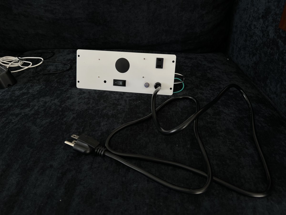

I got the AC Panel all put back together as well:

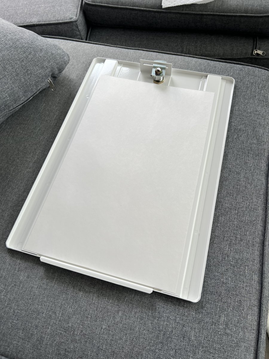

I also went to the local crafts shop and got some thick paper and double-sided tape. I think this paper will be a good replacement for the stock paper, but I have the original in case I decide I hate it.

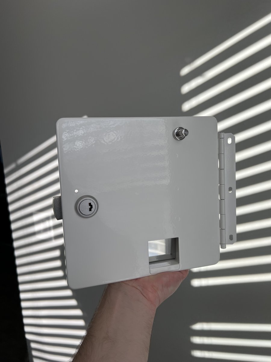

Lastly, I got the coin mech door all out together. Woo!
