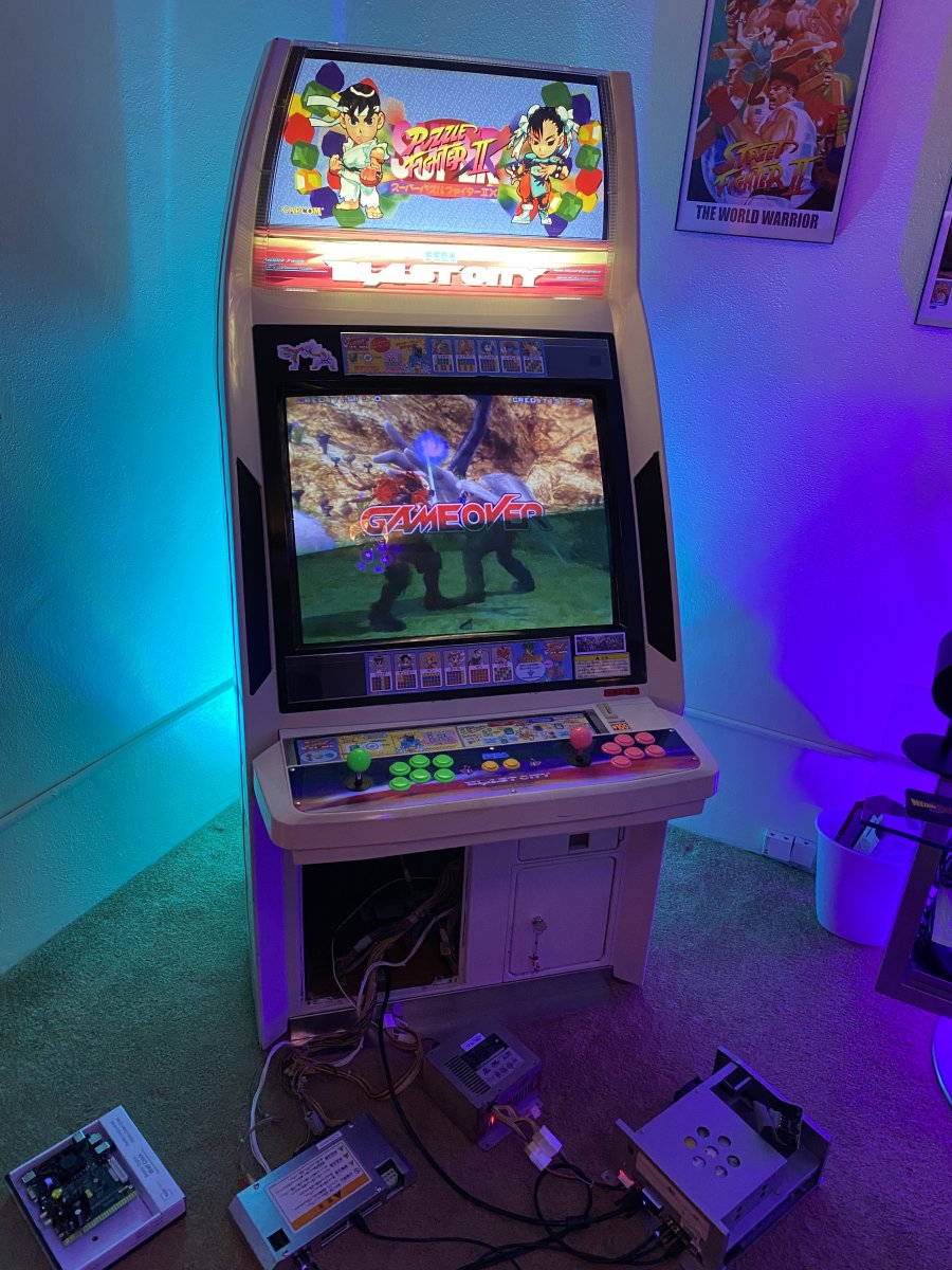

Hi Folks - working on a buddies 246 to try and get the multi all going. He has a Namco 246 Version B:
It works completely fine with the CDROM that it came with and soul calibur 2.
He got all the parts for the multi put together and was getting very strange results, so I am troubleshooting it now at my house. I went back to basics - I just have the ODE plugged in with a SD card with the dvd0d ISO file and the original security dongle. I pulled up a serial terminal to the ODE and it shows the image mounted. I then go into monitor mode on the ODE.
The system boots (3 bells) - and I see (1) unsupported FF command, and then that is it - nothing after that at all. I have tried multiple cables, etc.
I am starting to think maybe the 246 Version B has some weirdness going on where the ODE doesn't work with it, or not consistently?

Just really having issues with this 246B and the ODE - with the physical CDROM it works fine (tekken4, SC2), but when I drop the ISO onto the ODE - that is where I am getting the issues. Almost as if the 246B doesn't recognize the ODE as plugged in or something. In the case of Tekken4 - it gets further along than SC2, but then cycles those errors on the ODE.

And now I feel like I am just taking crazy pills. I pulled my 246 (revc) out of storage to do testing with that (was working great when I put it in storage), and literally the only game I can get to load is Soul Calibur 3 - all the rest either have a black screen or the blue "boot image wrong" screen.
<sigh>
I think I need to step away for a bit and let the gremlins move to a new house.
