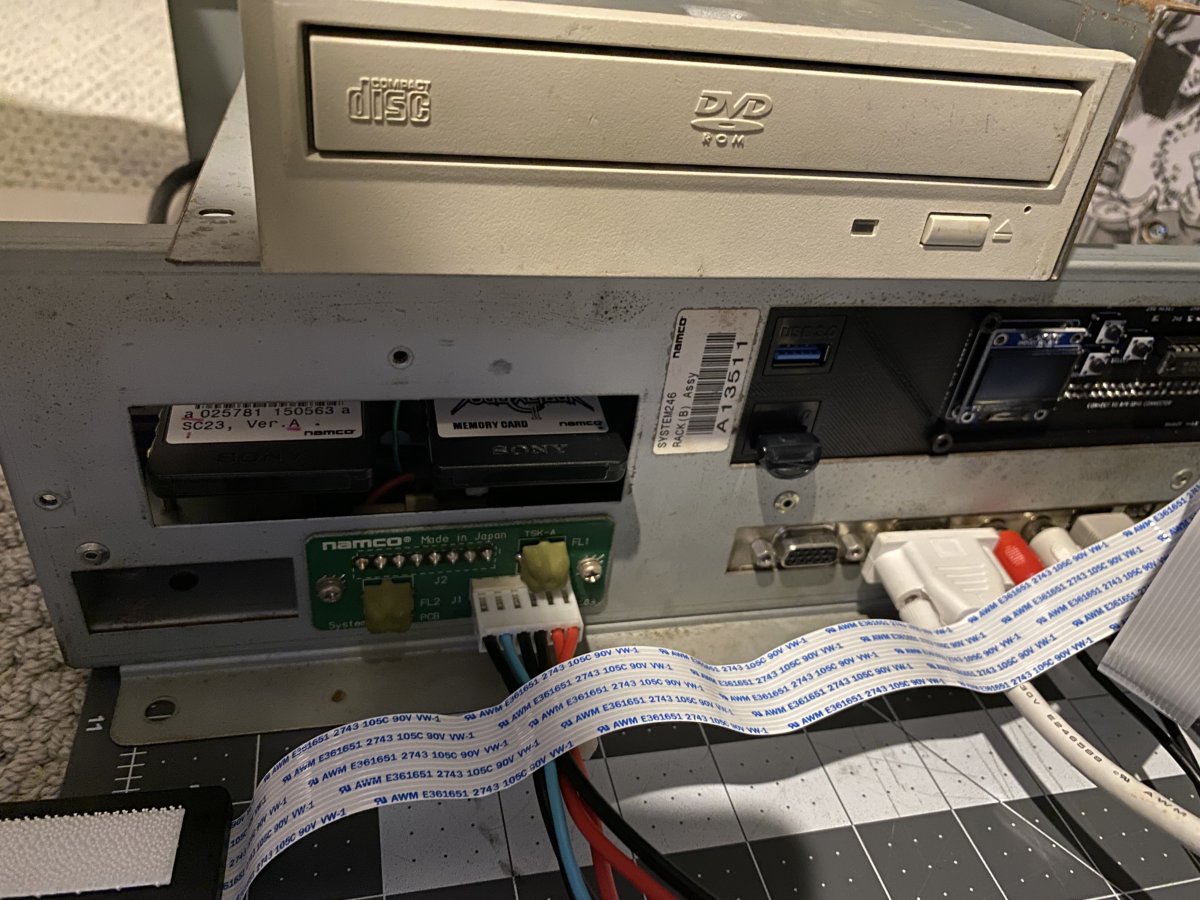

Just to piggy back on this, @mathewbeall was working on my 246 and I've since gotten it back from him yesterday to continue testing.
I made sure all of the image files on the thumb drive were bin/cue isos by finding and replacing all the tocs to cues. The good news is that all of the 246 exclusive games (that mattered) worked (Smash Court, Tekken 4, Bloody Roar 3). However, the other games that did work were Vampire Nights, Soul Calibur 3 and Kinnikuman: Muscle Grand Prix 2. Every other game had the blue BOOT PROGRAM ERROR BOOT FILE IS NOT RIGHT. Soul Calibur 2 just black screen doesn't even load and resets after a few minutes.
Additionally, I reverted back to the NAMCO I/O as I was having inconsistent JVS connectivity with my Capcom Naomi Converter (JAMMA TO JVS I/O).
Before the firmware update on the IDE, Soul Calibur 2 was working fine.
