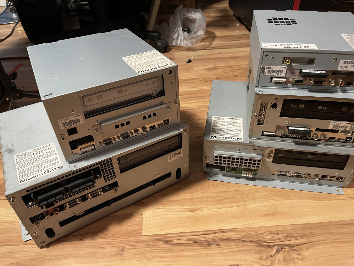

I actually almost own all the different versions of the 2X6 hardware, the only version I’m missing is the 246A. The PlayStation 2 was my first ever console I owned and ever since I heard about arcade equivalents, I knew that I had to have one :)
