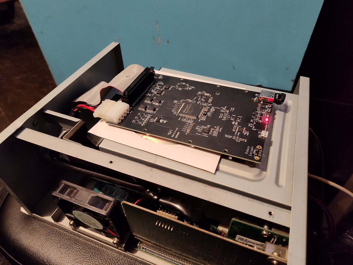

Dusting off this thread to let you all know that I'm testing a new ATAPI ODE from @electric_monk. this one includes support for HDD images in addition to CD and DVD for a complete Namco 2x6 solution!
Here is what the new device looks like

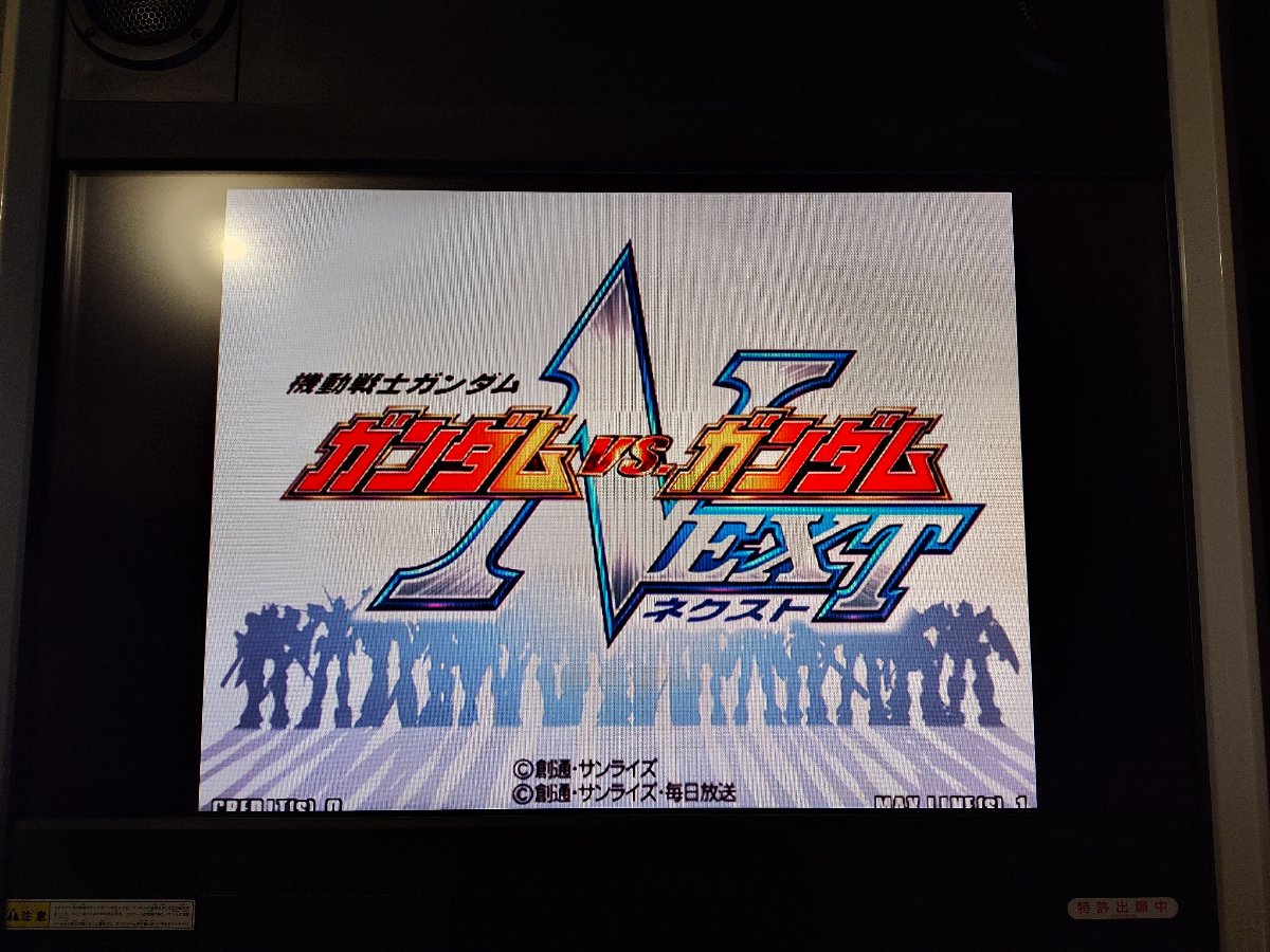

and a photo of it running Gundam NEXT (a HDD game) on my vewlix
Gundam Next works great and I've also tested Fate Unlimited Codes (another HDD game) with 0 zero issues.

I do intend to try and backport the hard disk support to the old version of the PCB, I haven't yet confirmed if it'll work or not - been too busy with the new version and also unrelated stuff 😊 It's obviously in my interest to keep the code between both as similar as possible anyway, though right now the new version contains all the tidying/upgrades as that's still in progress. There's also features in the new board (like the buttons, LEDs and OLED screen support) that won't work on the old version as it just lacks those I/O ports.
